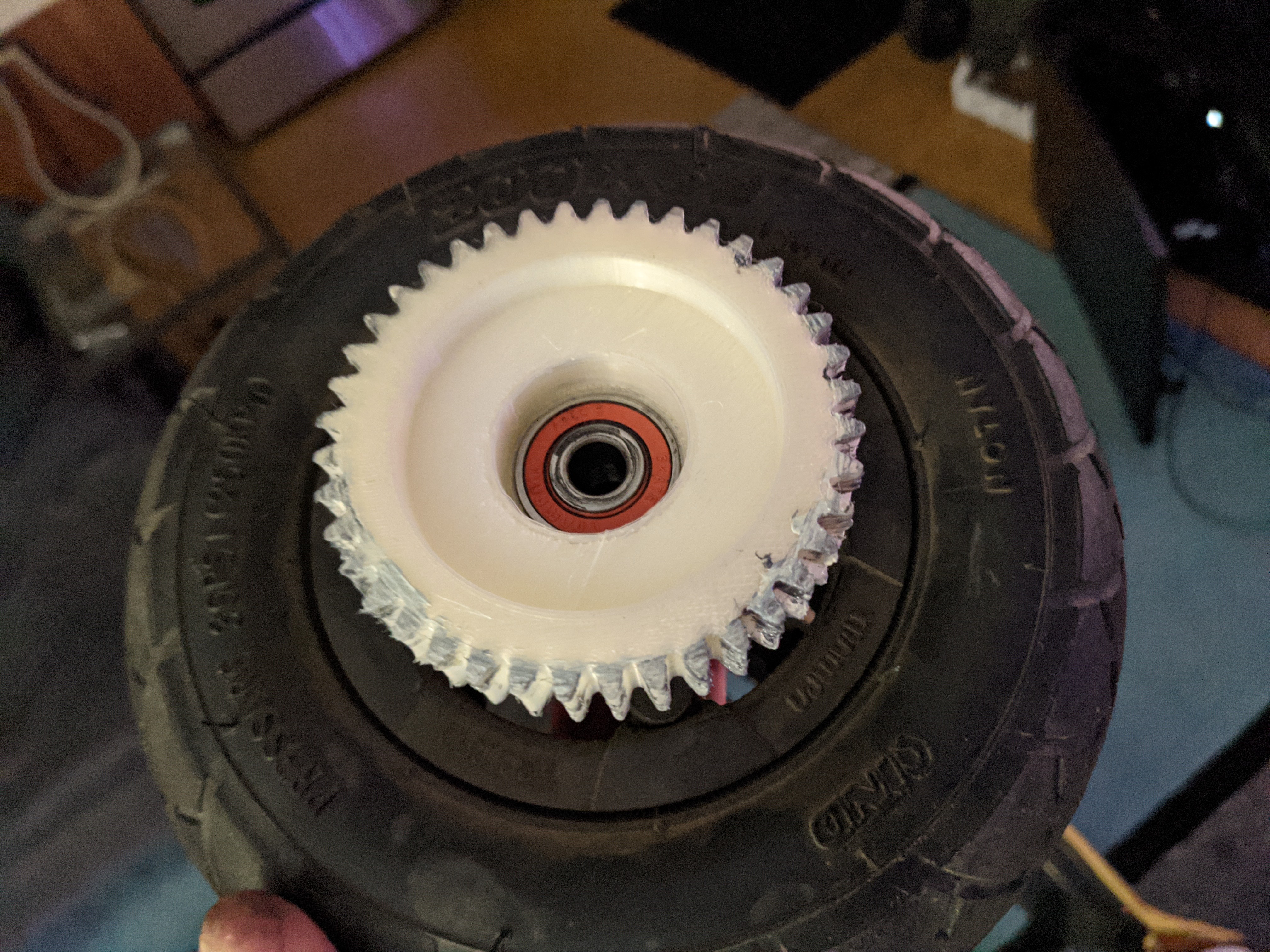

You might have some success with alloy 910. I’ve been running a gear in my Kaly gear drive for a bit now (only about 100-150 miles so far) and it still looks like new.

That’s just grease, right ? For a second they look like they’d melted. If you’ve had luck using it for gears then that’s actually quite promising
