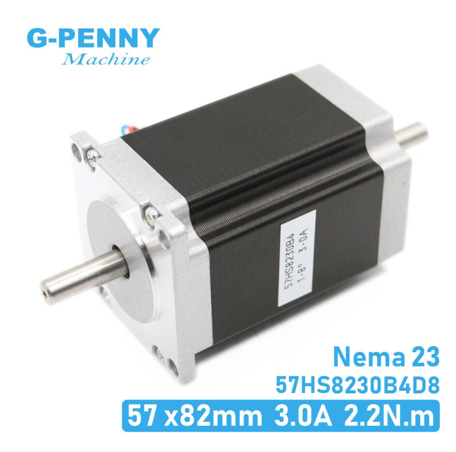

I have been looking around online for upgrading 3d printer motors from stock to something larger than stock. For example, replacing the Ender 5 plus nema 17 42-48 stepper motor to a nema 23 57-82. My overall goal would be to reduce ghosting and artifacts when installing a heavier direct drive setup.
I haven’t seen much on this topic, any ideas?
Im generally wondering about upgrading their size and amperage and its affect on printing, not wether or not I can fit it.
I honestly think upgrading just the motors won’t really affect the quality/ghosting very much at all - The only real reason to upgrade the motors is if you’re needing more acceleration/jerk, because you’re losing steps, and you can’t increase your motor drive current anymore without overheating things.
The ghosting has a lot more to do with rigidity of the structure, and its vibration/flex harmonics - Adding some solid panels or bracing to the frame will help a lot more.
