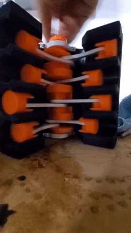

Hey all, trying to print the puck puck bruce hoyt st mod on my Qidi X-max 3d printer which has been working solid up until now. Here is the result of the final product… happened twice in a row. Using PolyCarnonate:
WhichI have used plenty of times up to now - including on several successful gt2b mods. Anyone have any recommendations on some settings I could tweak to get the top part to finish properly. Here are some relevant settings, let me know I can provide anything else that may help.

Let me know any other pertinent info needed. Thanks in advance, Had many msany other more complicated PC prints up until now, so not sure what the deal is… it gets so close!
Thanks much!
That’s a bummer. I use the same exact filament for mine and it came out perfect. Can’t seem to find it to be able to show you.
Just looks like your supports kinda suck underneath there. What slicer do you use?
Qidi’s closed source slicer which is just a reskinned version of cura
