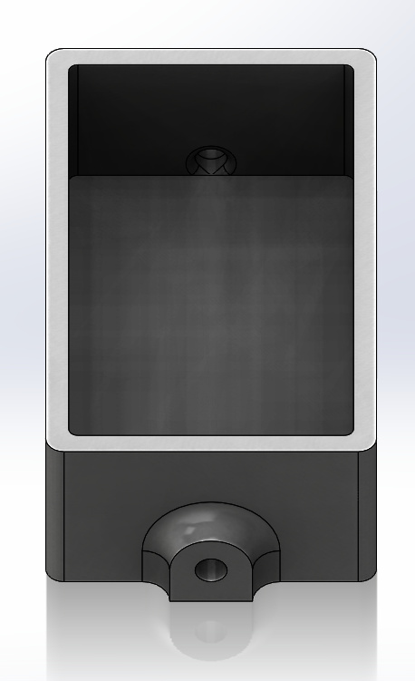

3D printing design help?
Can anyone help me edit an STL file that knows what they’re doing?
I just need to cut it in half and mirror it.
What kind of a design is it, put a photo here my friend, may be I can help you
So its just @mmaner ‘s volt meter but with a few changes.
https://www.thingiverse.com/thing:3418423
I just need to have the small wire opening on both sides instead of the one large one and I also need to fill the screw holes because I’ll be glueing the two parts together.
@huntercasillas I see, altering the design without the designers approval will not be ethical… its better to ask @mmaner first in this situation. I know him, is a good man, he will help you… Dont worry I can redesign that for you as the last option…
If that’s okay, let me know @mmaner! If not, a single piece design could be cool where I just slide the wires in the holes instead of having 2 pieces and then I can solder them to the voltage meter after.

I did. I can’t figure out how to split existing STL objects exactly in half.
@huntercasillas Give me a minute, I’ll do it. Split down the middle and mirrored in which axis? Can you draw me a MSPaint diagram?

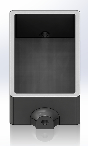

Is this what you want?
I dont see a need to split the model if your not using a charge port. You should be able to print it as is, add supports for the wire slots. After teh print is complete, remove the supports and slide the 2 wires through.
Yes! That’s exactly what I need! I guess if the wires I have are too thick after printing it I could just drill the hole a bit bigger right?

yeah, if its printed with extra walls. measure the wire diameter and Ill make the holes to fit, I did this one with a 1.75mm diameter as that’s what my pigtails are.
