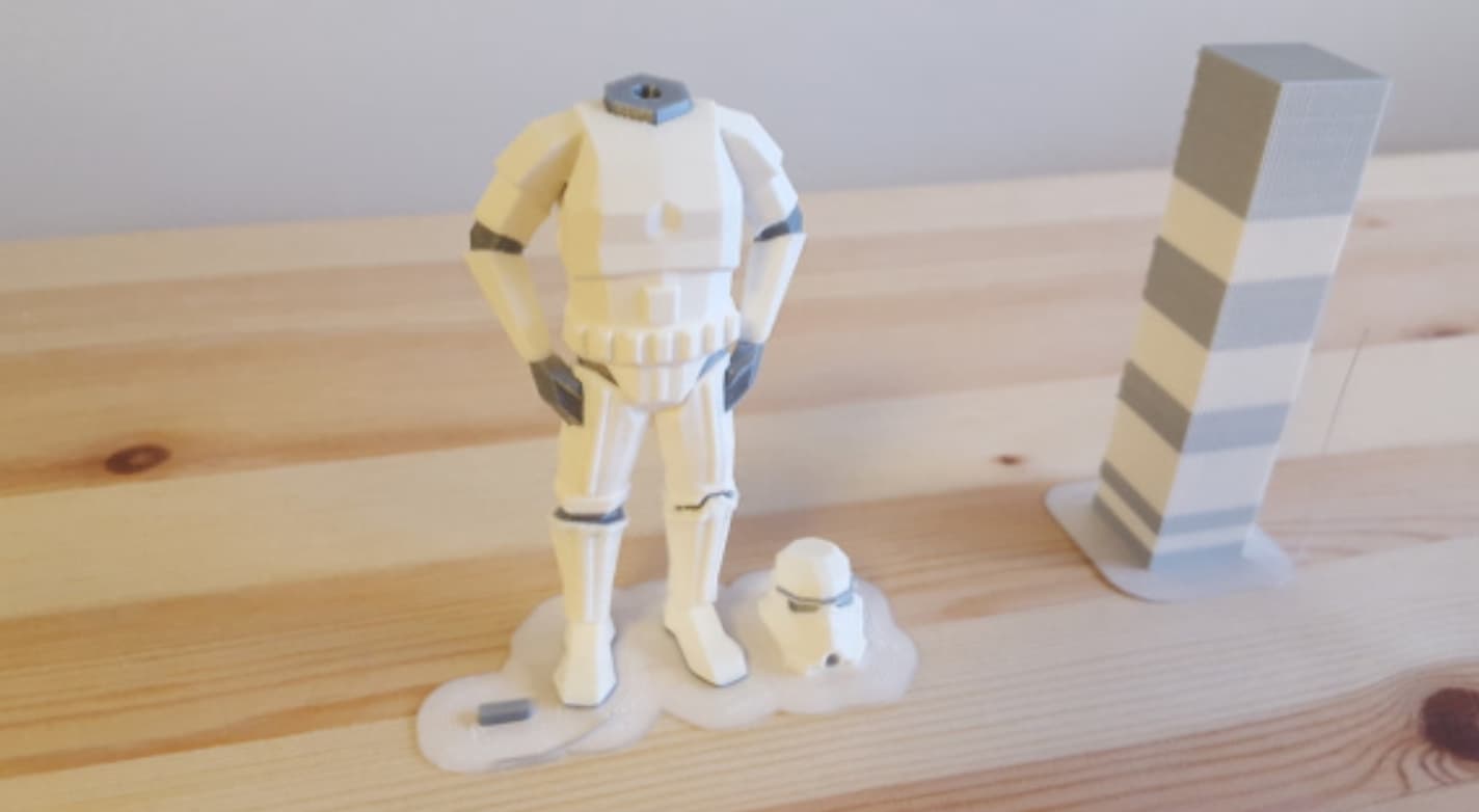

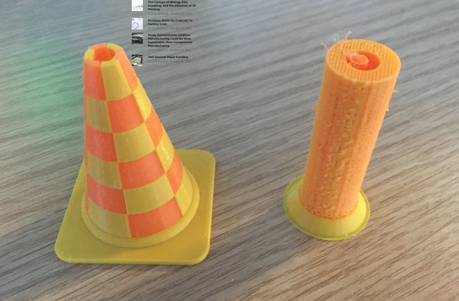

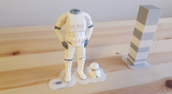

I have a dual extruder printer and it doesn’t double the speed as only one is used at a time. It allows you to have two filaments primed and ready to go at the same time. It allows you to print in two colours for example or print only the support material out of a dissolvable material loaded in your second extruder so you can make crazy internal geometries etc. It actually slows the print process down as you need to print a prime tower in addition to your model - this allows the printer to perform prime and nozzle wipe every time it switches extruders
Like this
Or like this

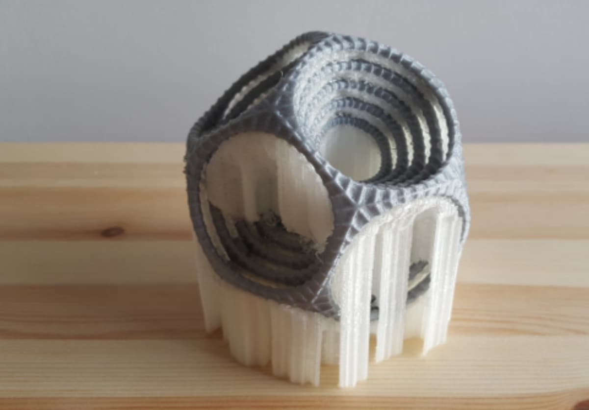

And heres a good example of using dual extruders to print PVA supports (which are water soluble) This print will be submerged in water afterwards and the support material will melt away leaving the model left behind
WOW! That’s cool! Thank you @Lee_Wright

In esk8 you are right but looking at the wider engineering possibilities its actually useful. Some filaments like Nylon have horrendous supports to remove as the material is just so tough so printing a soluble or breakaway material is advantageous in these examples. its also useful for when you require a good surface on the underside of something and supports cant give you a nice finish. Its an expensive way to do it though. The Ultimaker PVA is super expensive (£80-£100 for 750g) and needs to be kept nicely as its super hydroscopic
