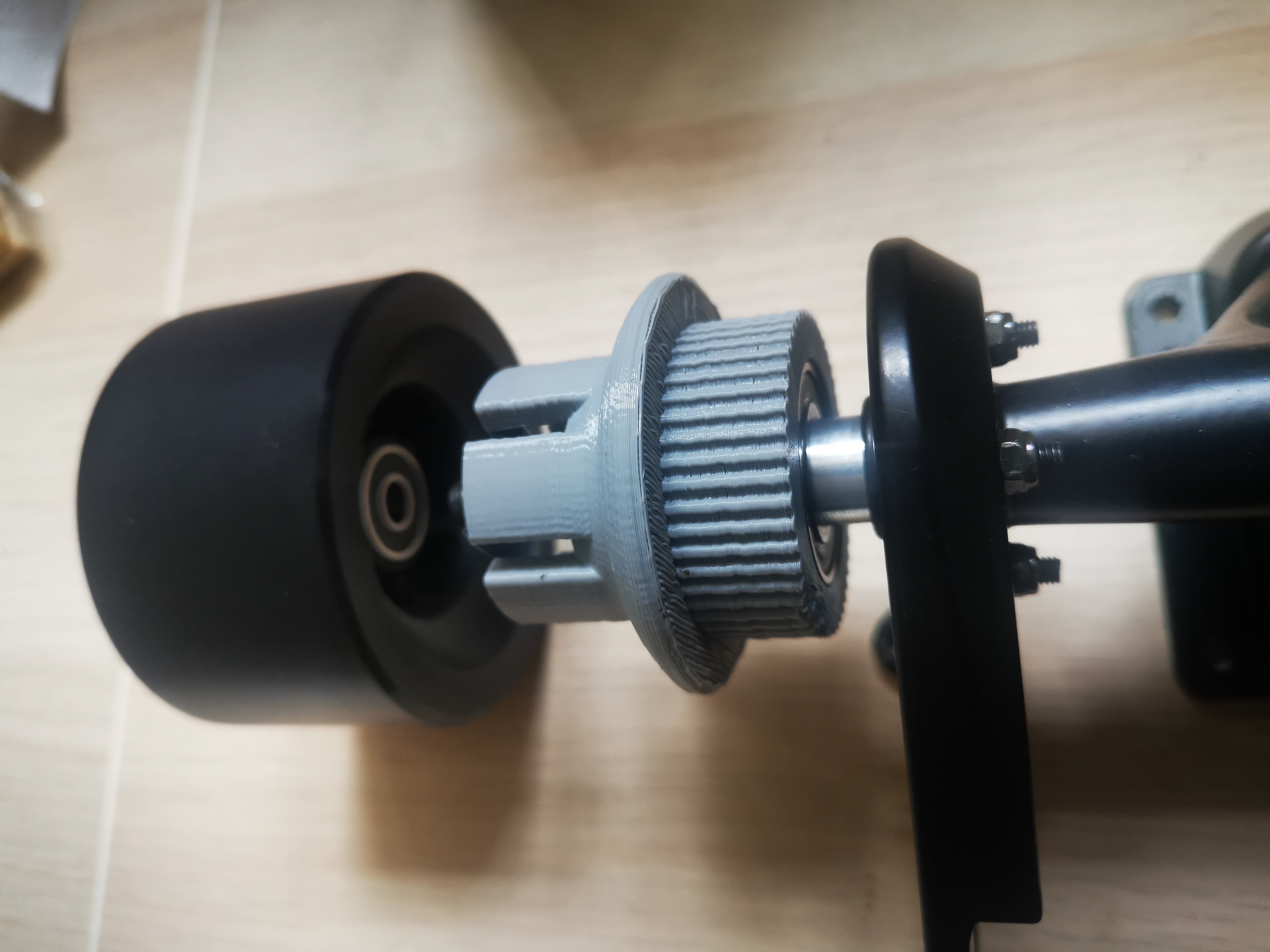

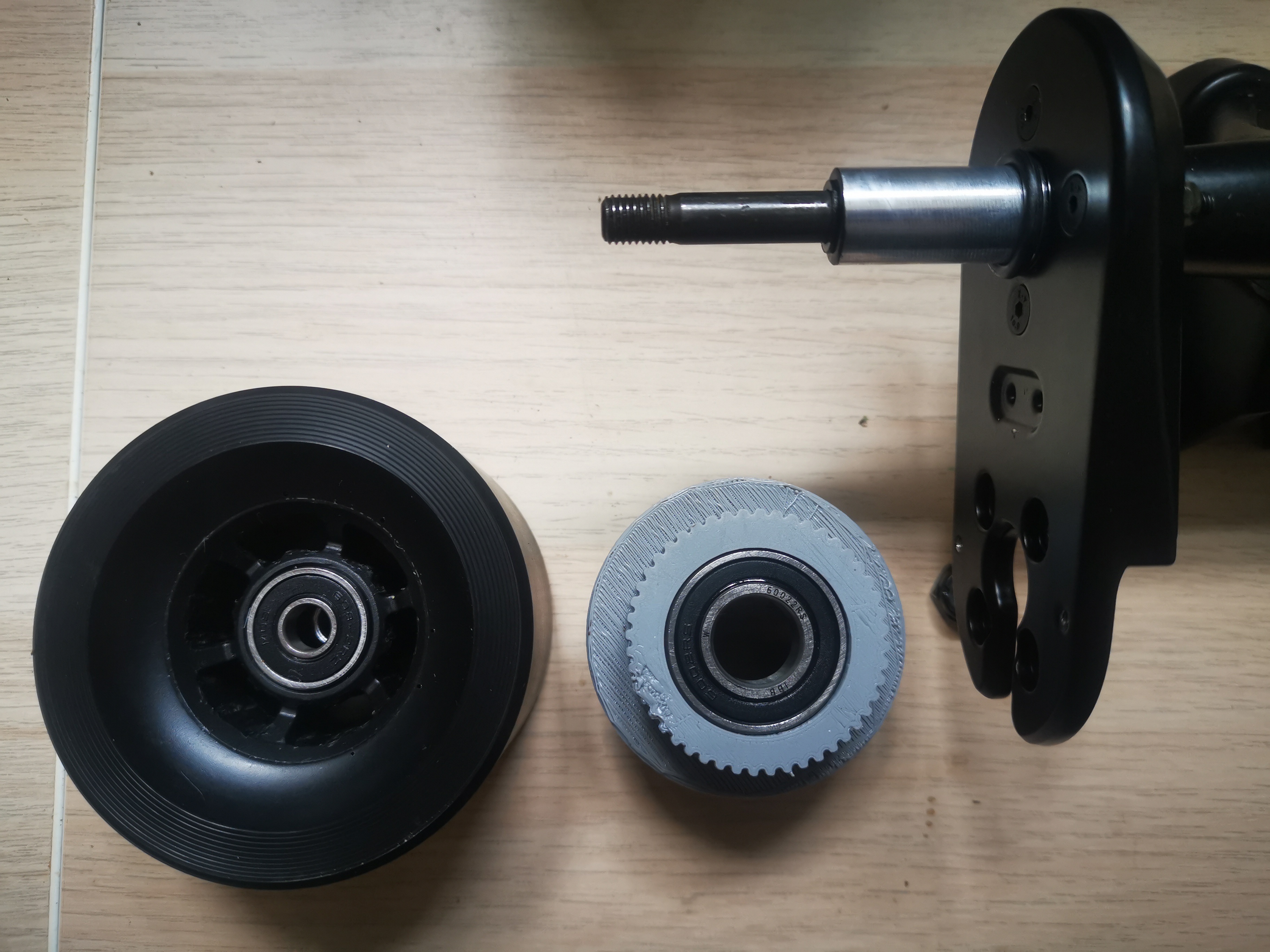

I designed and printed a 3D press fit pulley that has a really nice, snug fit in my abec clones, but it slowly slips out when weighted/riding.
This is already my second iteration of this pulley, so I’m trying not to waste too much more time/filament.
I thought about designing a seat for a regular 609 bearing with a lip that presses back up against the wheel, but I feel like the heat from the friction of the bearing on this seat will NOT be good for the material (in this case, carbon fiber PLA).
Is dumping some 5 minute epoxy through the opposite side into the spokes a bad idea?
The only other thing I can think of is putting a washer in between the 2nd (pulley) bearing and the seated lip, but I don’t know that that would make things any less melty.
In my experience the only material to use is Nylon for press fit pulleys. Any type of PLA is just not abrasion resistant enough. ABS works for a little while.
Imo a press fit pulley bearing should not really get hot… The pulley itself only sees load from the belt which, coupled with a nice bearing, should run nice and cold… Is the press-fit pulley bearing just floating on the axle? How is it backing out?
I’ve had good results with CF-PLA for bolt on, so I’m trying my luck with press fit. It’s a very very tight fit, but the belt still pulls it out. I did have my belts pretty tight though.
Yeah, it’s just floating on the axle. The alignment of my pulleys is pretty much spot on, but even still, I guess the belt is tight enough that it’s somehow pulling the pulley out of the wheel, despite being such a tight fit that I cannot pull it out with my hands.
I’ll try to design it with a seat for a bearing and see how that goes :slight_smile:
There should be something, spacers etc pushing the bearing of the press-fit pulley against the wheel… Shouldn’t just be held in by friction alone
I’ve never used a press fit pulley before, so this was my first attempt at designing one. I will be sure to do that!

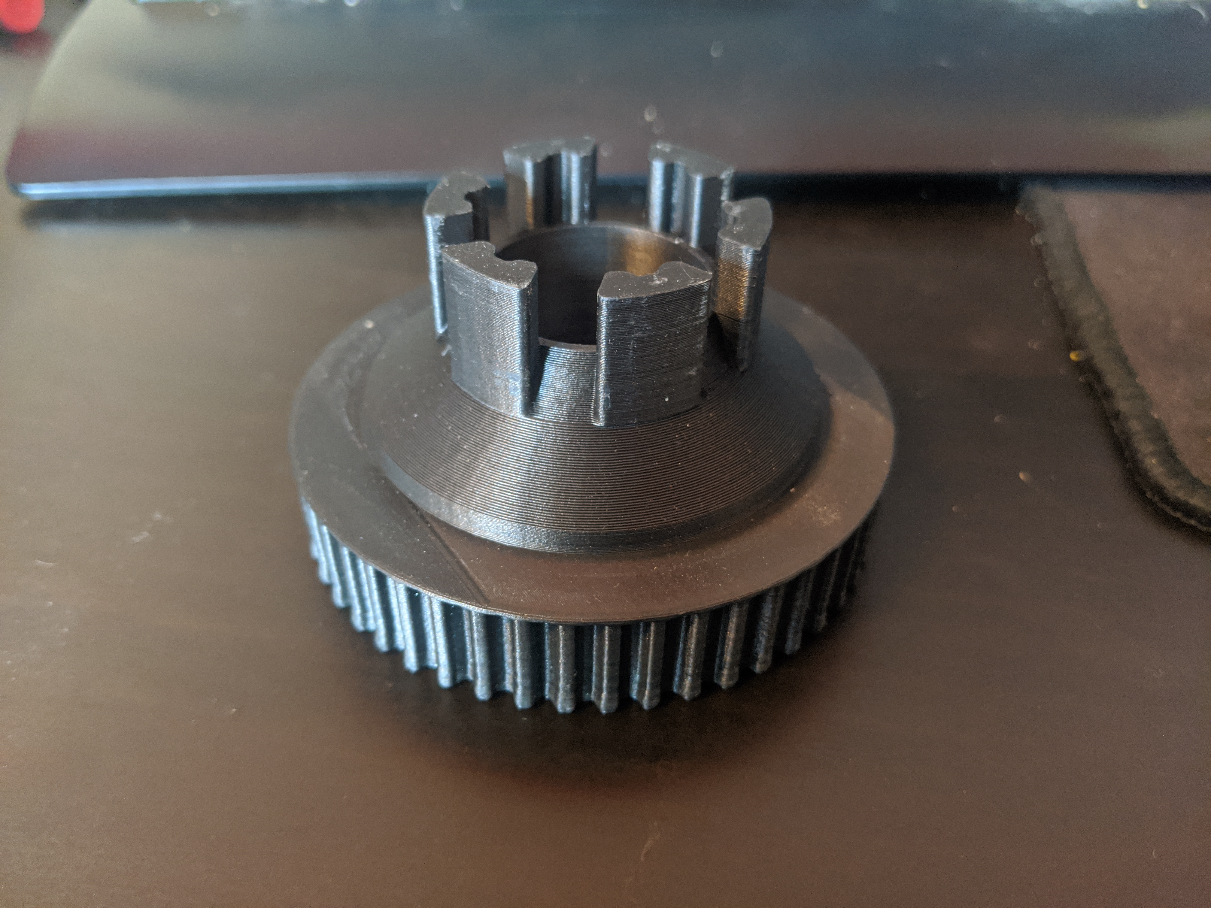

The pulley is directly pushed in by a bearing with a lip or larger bore. Its why thry require an extended axle, because otherwise all 3 bearings dont fit standard axles. You can make a design that fits a standard axle if you use a flanged bearing that is also wide enough to work as an inner wheel bearing at the same time
I’ve designed a similar setup. Using a 23mm OD 15mm ID bearing to rest the pulley on the truck. Easy to turn this into any 3M 5M whatever T gearing. All a test at this point, not tried on a board yet.
Is that used? Print quality seems a bit sketchy :sweat_smile:
YEAH… that looks wonky AF!!!
Luckily I’m using TB218s, so I have some extra room to play around :slight_smile:
@kook You’re cheating by showing me a pulley for direct drive :stuck_out_tongue:
But Yeah, I had something very similar in mind.
