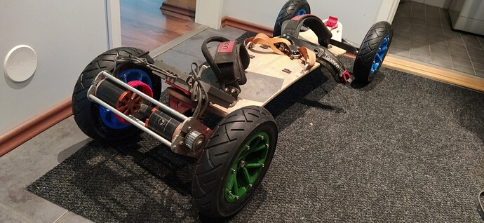

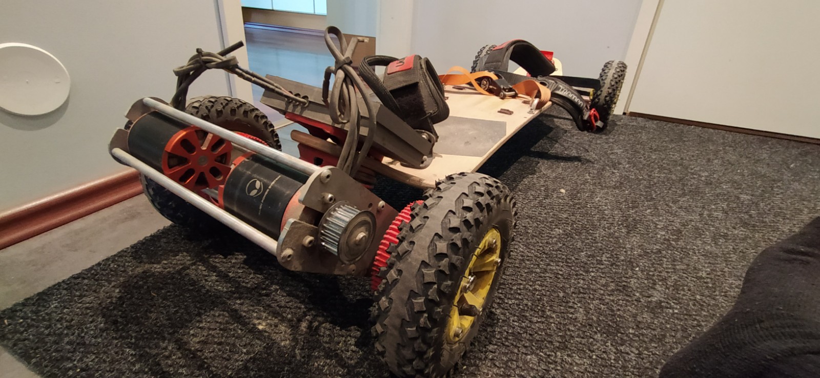

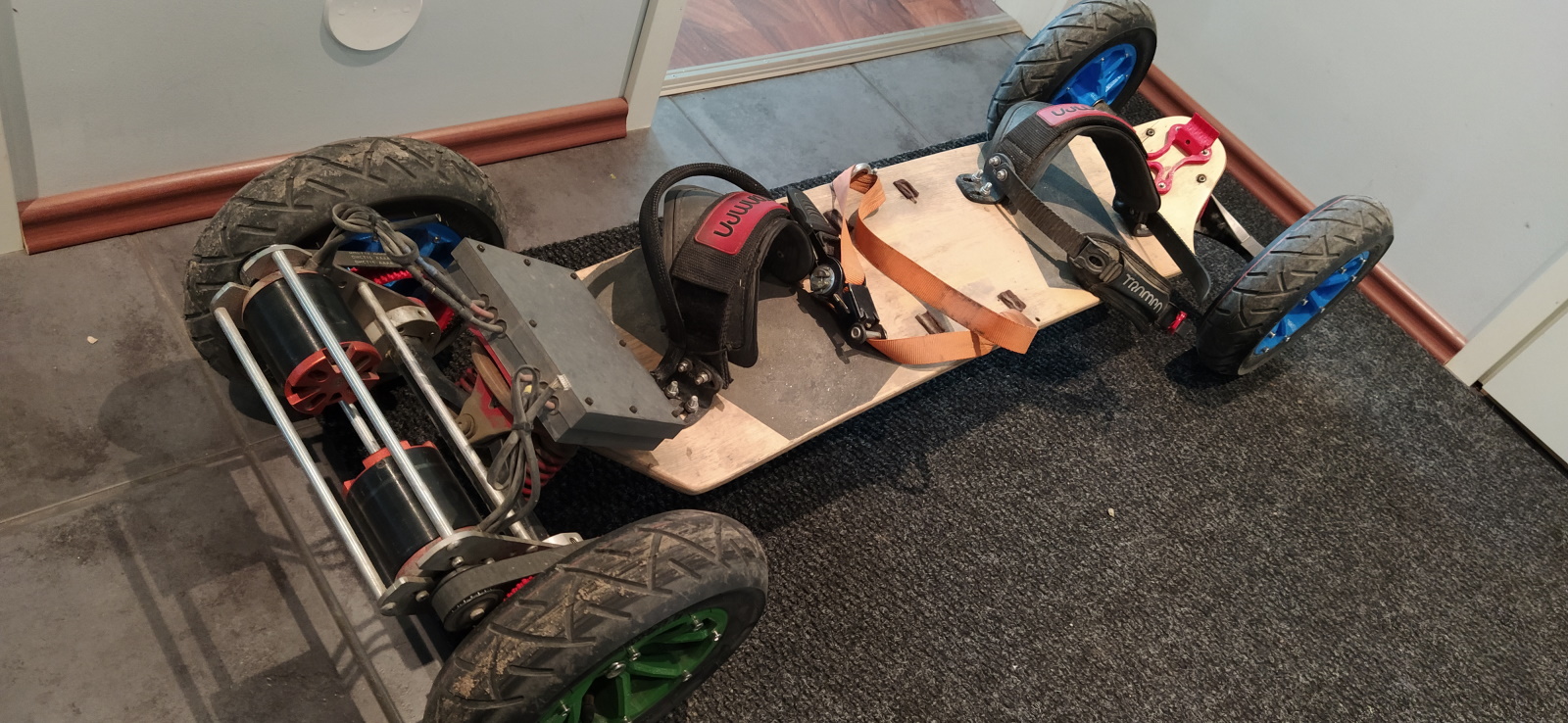

Finally got the rims finished for three other corners so I can probably go for a test ride tomorrow to see how they feel.
Comparison between the 8" and 10" wheels
Note, the wheel pulleys on the 10" are 70T and the ones on the 8" are 68T. Check the height from the bottom of the pulley to the floor.
Well I’m back from the first test ride and didn’t die, nor did I have to pull my wagon home, so a success I suppose.
Couple notable ride feel related changes.
Cons:
Man the torque is down, but this was to be expected, the pulley ratio + wheel size increase does reduce the mechanical advantage, so there’s just less torqyness(?) from that, but I also feel that the bigger+heavier wheels added with the bigger+heavier rims have added a lot more tire inertia, so it takes more torque to get and stop those things rotating. Otherwise carving felt still good and not too tippy. -
Pros
Maaaaaan is it smooth though. I even did a bit of off-roading and all the roughness I had compared to the 8" were just gone, especially when hitting the larger stone sized gravel. Very happy on that end. Tarmac was basically silk.
I didn’t do a good run to get a good comparison for efficiency, but I think the afternoon ride will be better for that. I’ll present some numbers on the results between the 8" and 10" setups. I think this setup is much more of a GT (grand tour) suitable, just due to the smoothness, but I want to test the efficiency, as I’m interested if my hypothesis about the motor loading holds water in practice.
Couple mechanical notes.
rear-left motor axle’s tip very slightly rubs on the tire
Slightly tightened the front truck in the middle of the drive just to get the feel a bit more damped at speed. Need to do the same thing to the back… but otherwise I didn’t really have any notable tire vibration/resonance issues, although I did only go max 38km/h (~22mph) downhill and ~36km/h on flat, so I didn’t push past 40km/h yet, but plan on doing so later this day.
