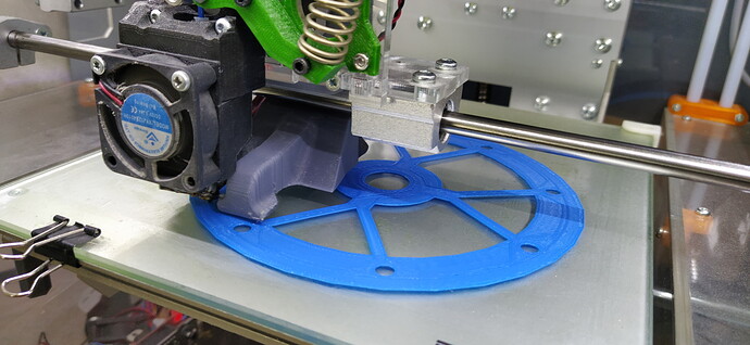

[quote=“javand, post:62, topic:44128, full:true”]
Note that the 8" rims are from before I started designing the 10" tire rims, so they are a little less developed/refined, as what I had learned from them, I applied to the 10" rims.
All designs use M5x60 bolts to hold the two halves together. Wheel pulley is mounted with M4 hardware. And the bolt pattern for the wheel pulley mounting are custom. I printed the rims with 100% infill.
Note that these are all live versions of the .stl files in my google drive so they can be updated/changed or removed at any time. All files are provided “AS IS”, I don’t take any responsibility if someone uses these models to print them and then subsequently get hurt while using them.
I don’t mind you using them if you change them to fit your own setup, but I would appreciate if you’d link this thread about where you got the original models from, if you post about yours.
8" rims, 6301 bearing:
8" rims, 6001 bearing:
10 inch rims, 6001 bearing:

10 inch rim question. What’s with the internal lip? Removable material?
To promote adhesion to print surface, remove after printing

I’ve been using the cheapest PLA I can find. AmazonBasics or Hobbyking PLA in this case.
If you want to lighten the rims, then you could reduce the amount of filament needed by reducing the size of the geometry (spoke width for example) and/or use a stronger filament with better mechanical properties like ABS.

I haven’t read the whole thread, but an early prototype (the second one to explode) massed about 210 grams all bolted together with no bearings.
A few percent of that is the bolts, but let’s round it to say 200 grams per wheel.
A nice roll of filament runs between $20 and $50+ per kilo, so that’s five wheels per spool, or between $4 and $10+ per wheel.
If you used CF-nylon or something else more exotic that could increase the price to $20/wheel or more.
Currently printing the rims after getting the new filament yesterday.
I wouldn’t bother too much with the very early prototypes, as they weren’t sturdy enough to survive just pressure pump up.
The 8" rims were roughly 4 complete rims per 1kg PLA spool with 100% infill and the 10" rims are 2 complete rims from 1kg PLA spool.
