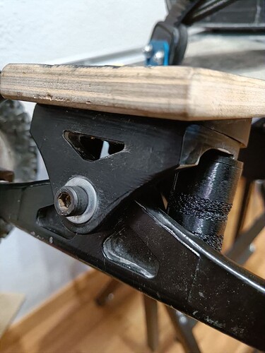

I built a mountainboard recently and I have been abusing the sh*t out of it. As per usual, my budget was constrained (actually dismantled my longboard and took the electronics out) and got a pair of cheapo flipsky eMTB trucks with 8" wheels that cannot be beaten for the price…but that’s about the best thing you can say about them. I actually had to hammer one of the motor mounts in, just to give you an idea of the quality of the build and tolerances.
BUT, the worst thing by far were the springs. As my skills improved, I could basically pop them out on command by just leaning a little bit too far when strapped to the board, which as you can probably guess is fantastically safe and confidence inducing when riding hard through the middle of nowhere next to a cliff. At first I tried the built in mechanism to tighten them, and 3D printed some inserts to prevent the retaining screw from backing off:
After a few weeks, I was able to pop them again, probably at the WORST possible moment:
Fortunately I was very lucky and jumped off the bindings unharmed. This is when I decided to take matters into my own hands and get busy. I had a roll of TPU and time to experiment:
The first attempt was using 60% gyroid infill an no walls (in order to evaluate the compression of the barrel), and it turned out to be way too stiff. Next up, I went with 25% for good measure + walls…too soft this time. Also noticed that walls would crumple and remain weird after being compressed for extended periods of time, so this is my current setup:
The retainers are also TPU, at 100% infill to make them as stiff as possible. Then the barrels are 40% gyroid with two “crumple zones” that I set up in prusaslic3r to have no walls.
Tested them today on a short run to the gym on the street…so far so good! I think I actually like them more than the springs. The best part is that I can create basically infinite combinations of crumple zones, infill density and type, so I hope I can come up with a more or less universal “equivalent” to the most popular commercial barrels given a TPU brand. Until then…I’ll keep testing!

After a weekend of testing, I got some good news and some bad news.
The bad
You guys were mostly right. The barrels worked incredibly well for 5-8km, suprisingly so. I could lean and carve with full confidence, vibration dampening was awesome and the feeling of the truck overall got 5x better. BUT:
Durability is shit. As you can see, they quickly lose their shape and even though still work fine when compressed, when centered the trucks become scary sloppy. The only way forward for this would be to print them solid and either reduce the diameter (more risk of buckling) or increase the size of the inner hole.
The good
The retainers I designed worked pretty well. So much that I decided to modify them for the old springs to try and fix the popping issue and came up with this:
They are way longer than the original ones, but due to the concave shape of the bottom retainer, the trucks still maintain the full compression range.
For reference, this is the state of the old retainers, and the main reason why I tried this in the first place:
The new ones are printed using 100% infill and press fitted into the adjustment screw, avoiding the dissasembly risk I had before. I’m gonna be trying them today and will publish the STL if there’s interest!
