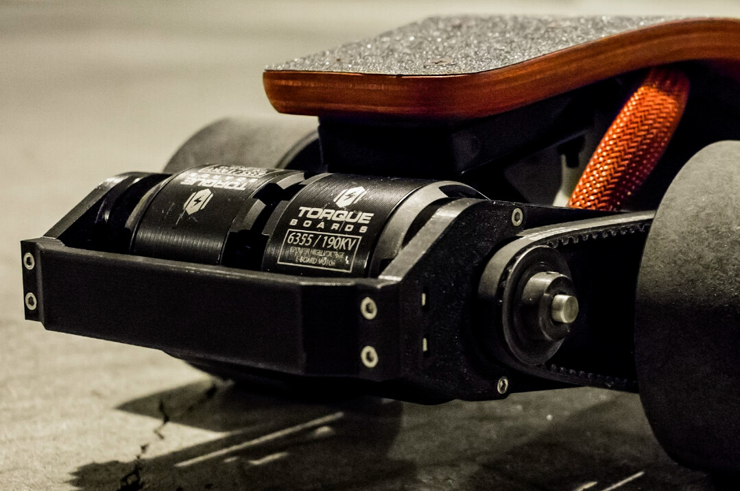

Guess it all depends. This bumper handle is PLA, it’s seen over a 1000miles in all kinds of weather in the years since I printed it. Still carry the board by it.

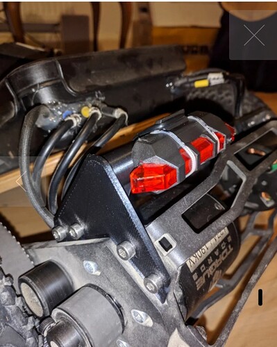

Made my light mounts out of PLA as well as my esc air scoop mounted on top of a black box

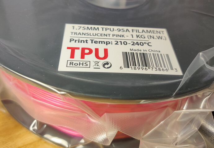

This statement is only valid if you only use PLA for parts that don’t require tolerances beyond what PLA can handle. I on the other hand wanted to print as much as possible and found many applications that PLA just doesn’t cut it.
I mean PLA is wonderful for prototype prints, but can’t be used for enclosures that need to flex, for riser blocked or deck savers that need to be wrenched down on, or for mud guards that need to not break on impact with a large rock. I’ve printed all the above in PLA initially, and after they broke, now have a near indestructible enclosure, mud guard, and riser block printed in TPU (deck savers just shouldn’t be plastic).
I only got one roll of PLA since I got my 3d printer and I still have it.
My go to filament for 90% of the stuff I print is PETG.
The rest is TPU which I hate using due to the low speeds and finicky setup.

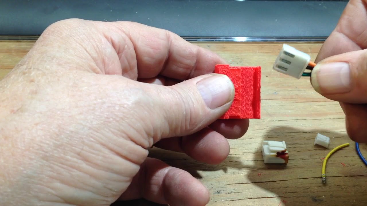

I just came across this JST-XH crimp extractor:
We need that one. Somebody please make the model. Cheers.
And while you are at it, we also need one for JST-PH.
:flushed: Yep we really need this!
Likes, likes, but no models. That’s typical!

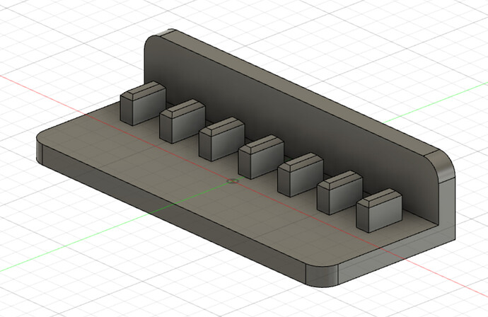

I hope this thing works…
