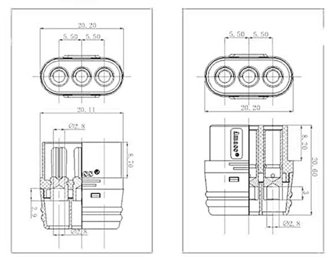

Yeah that doesn’t look right, it’s not supposed to be big enough to ride :joy:. Might be able to get it over to you tonight (I am GMT) depends when I get home.
No rush buddy, i appreciate it. To be honest, all i really need is a solid few photos so i can model it myself, and using scale get the other dimensions.
Try the mm to in conversion factor to scale it down. I am prone to making this mistake lol.
I.e. Scale it to 3.94 percent and see if it’s perfect.
@Zach Pulled from amazon. you can calibrate the image in f360 if you insert it as a canvas.
Thanks guys! Gonna try both and see what works best!

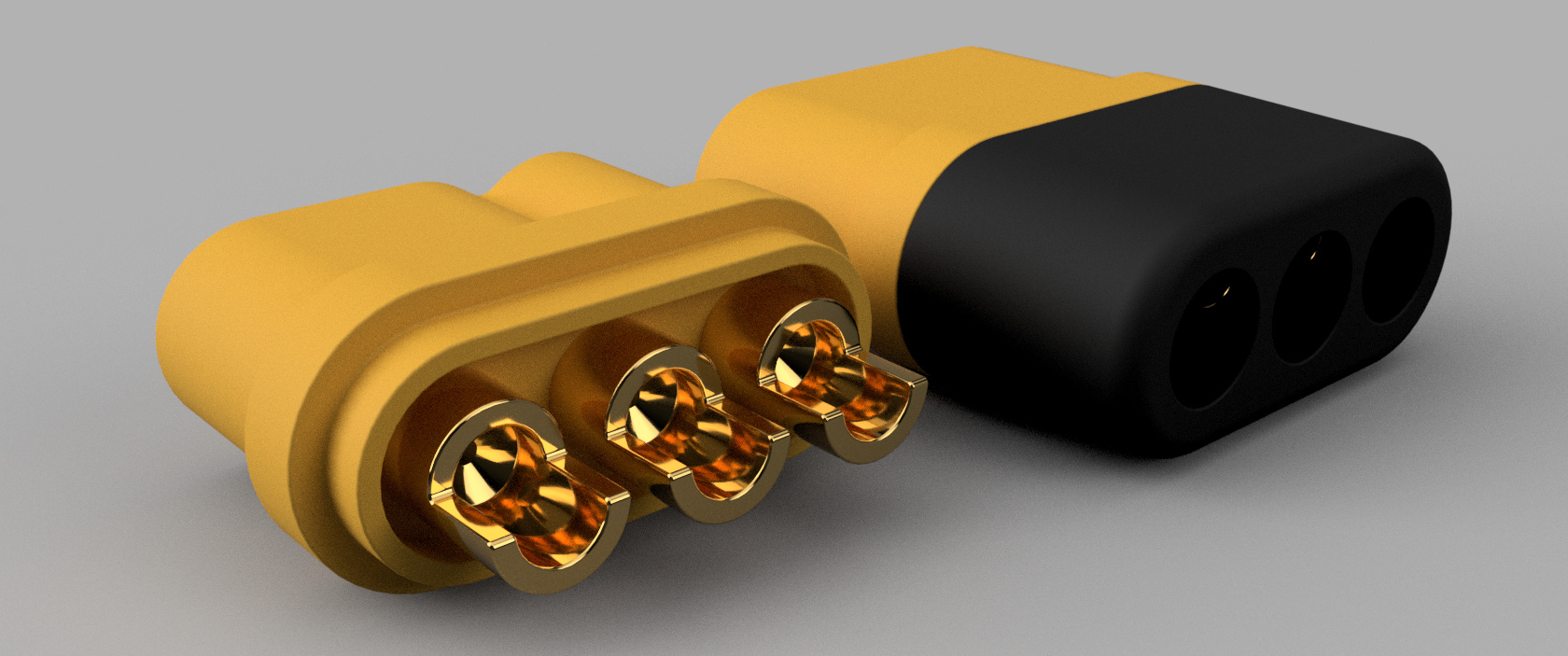

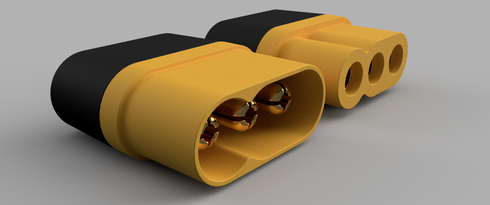

I got you man :slight_smile: i have these in my collection :smile:
Female : https://a360.co/2IZdATp
Male : https://a360.co/2JgqqM7
:heart_eyes::heart_eyes::heart_eyes:
This is great. We should compile a list of step files for esk8. Would save builders a ton of time
Ooh that’s sexy. What’s wrong with me, I’m getting aroused by renders of electrical connectors…
