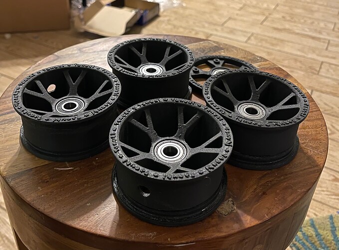

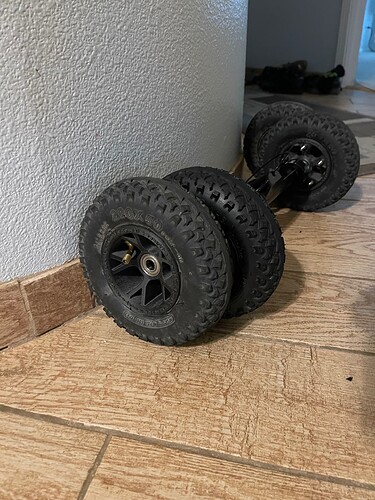

The fat ones were just to see what it looked like. Two outer hubs back to back. Only went to 20 psi for fun.
The rim that ripped apart earlier had several points of failure I introduced:
-nylon with fill (CF or GF) is hard to gauge layer adhesion visually when printing. Nylons without fill almost look translucent in areas with 100% infill and good layer adhesion. Fibers break up that visual cue and I got fooled into thinking it was solid in the z dimension.
-outer, wide half of hub was not annealed.

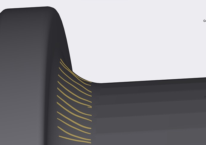

-the wide half of hub was also warped so that the inner radius mated perfectly with thin hub and spun true on the axle. The outer diameter of hub, near the bolt pattern, curved upward off build plate a little bit, leaving a 1mm gap where the two halves of the hubs most distant from axle should have mated seamlessly. When I tightened the hub fasteners down, I think they might have been uneven and pulled the hub apart. I used a star pattern and did final torque by hand.

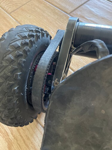

It failed here:
I never found the ejected part. I did look. Bad pic, and even worse testing jig, but hereā€™s my swing set.
Reprinted, increased temp 10c, expoxy around lines that delaminated. Annealed.

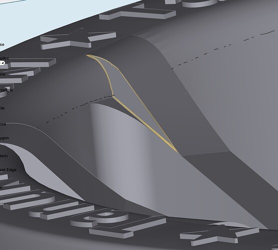

I really like the Y spoke design. I did a little tinkering, I havenā€™t printed them, they arenā€™t the pictured print above.
Just some thoughts. Probably doesnā€™t matter for a good PETG print.
I would recommend against filaments with fill unless you are experienced. I do feel extremely confident in printing your Y design in dry, Taulman 910 nylon. Good prints will fracture along stress lines that ignore layer lines, and I feel like I can judge adhesion by looking at the part while still printing.

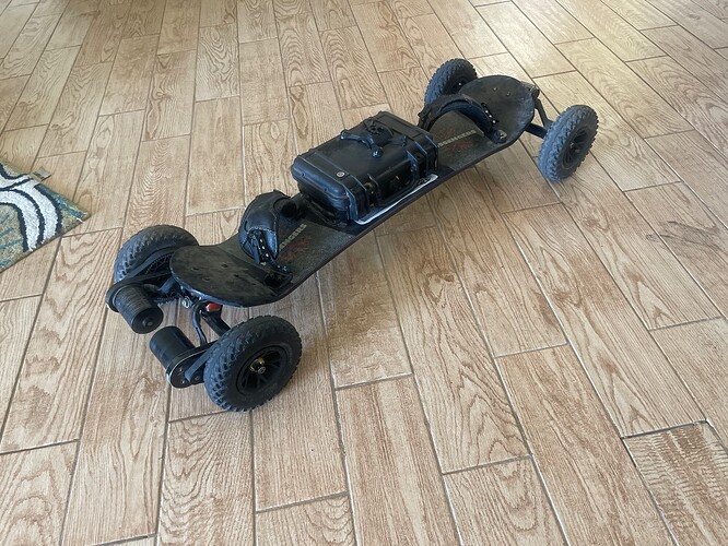

Anyway, I popped a tire on my mountain board. Perfect time to swap in front hubs. I still need to figure out the rear wheel pulleys.

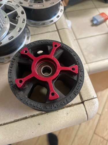

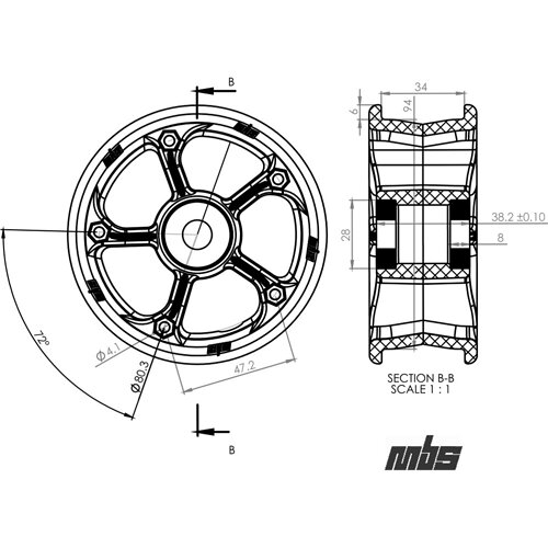

What diameter hole pattern is MBS and Trampa? Could do a 4.2mm slot, you should be using washers anyways if youā€™re clamping printed parts
Trampa is 35,7mm
MBS is 40mm
I like trampa more because the hubs can be smaller. But itā€™s not that critical. A slot is a cool idea, but might not work with all designsā€¦
If there is a loud bang tonight donā€™t shoot anyone. :smiley:
I once saw steam rising from a nozzle. :smiley: But yeah, Iā€™m recently dealing with a lot of wet filament too, the summer so far has been particularly damp.
Itā€™s actually a diameter of 80.3
Will matter for mating with gear drives
71.4mm and 80.3mm? Who makes these numbers :nauseated_face:
Probs someone at mbs and trampa.

Oh yeah sorry I ment radius. Also I measured the radius in CAD, and it was exactly 40mm. Looks like that model was not exactly right.
Yup lol. 40mm exact would have been perfectly possible. My bet is someone drew something up in CAD and because it was non-critical it was never looked at again.
The trampa/summate spokes are great spacers for printed wheel pulleys that donā€™t have any stand off spacing built in. Itā€™s plug and play. 3 printed hubs and a pulley in nylon taulman 910.

Ooh genius idea, print hubs that use the Superstar insert in the print half way through the print so when itā€™s done thereā€™s no evidence of it but itā€™s metal reinforced, just pause half way and press fit it in
