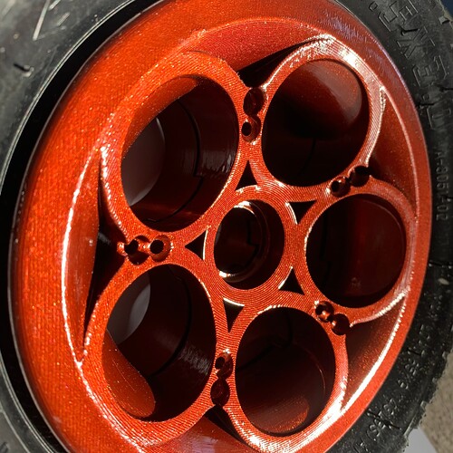

finally got my rims 6” diameter. They fit the 8.5” x 3” escooter tyres

I hear you. This is why i pressed a custom deck. It flexes maybe 3” in the middle. Slightly narrower trucks than kaly with a hand made flexible battery pack. 12s5p but that much lower weight means im first off the line vs an xlr. Then only after about 35mph does the kaly start to pull away from me. Also these wheels are one third of the weight of the kalys and that helps alot too. Only 220g per wheel they sit on 3” wide tyres not 4” and its pretty damned nimble
Sneak peek :eyes:
