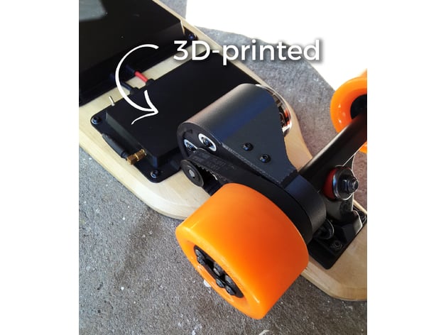

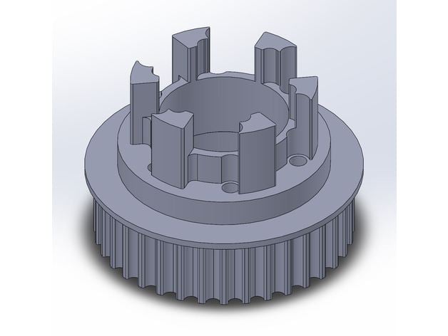

If you are located in EU, I can 3D print pulleys for you for the price of filament (around 0.025EUR per gram, PETG). I could even 3D print trucks for you if you want to go budget. Or enclosure, it just needs to fit to 190x190x165mm.

If possible I wanna avoid 3d printing for durability, at least on the mechanics. Since i’m already wanting to buy from @dickyho I might as well get everything including the vesc, motor and motor mounts and a few spares as well.

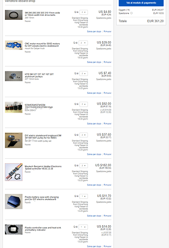

this is the current components, what do you think? the damn vesc make it 100€ more
Why don’t you go for flipsky ones? I don’t think there is much of the difference from maytech. They don’t brand them as VESC, but they are VESC based. Just get 4.12 version and not the 4.20 which seem to have some problems.
I do agree that 3d printed motor mounts will be shit, maybe 3d printed smaller pulley as well. But I’m sure that 3d printed bigger pulley will hold well, especially if you go for 15mm version. 3d printed parts are more durable than you think.
On the other hand, you definitely won’t go wrong with metal machined parts.
This. It’s the same vesc and you can get for 50/piece

I’ve just checked for what I’m spending on this thing I can just get a meepo mini 2 or a meepo v3 including batteries and chargers. I’m not sure if this is worth the headache
