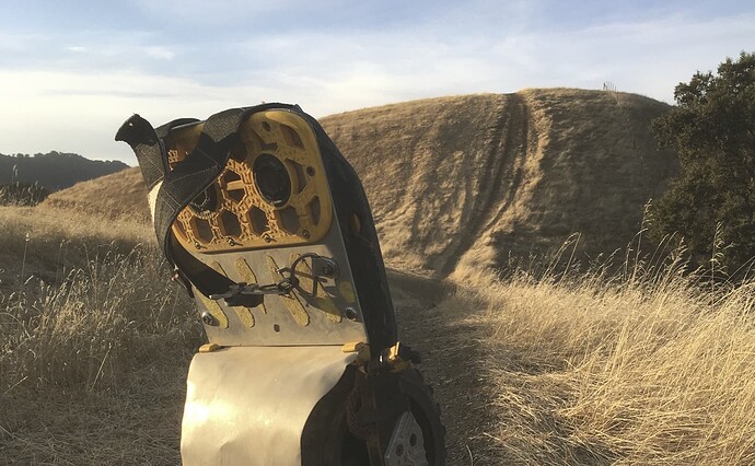

I have seen a few different foot bindings (surely not them all) and I would like to introduce my own take which I call a 3 point binding. I believe this provides superior board maneuverability while still being escape-able.

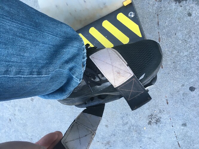

I use this binding for my front foot (right, goofy) for the tight heel and toe control. There are two anchor points (one heel, one toe) towards the nose of the board and a single heel anchor, behind my front foot.
The strap itself is low-stretch polyester, like a seat belt. It consist of two sections, one long and one short. The long section loops over itself by using a pivot at the third anchor point and attaches with velcro. I found using the long strap for the "toe hold’ was the most secure.
The shorter strap then attaches to the heel anchor at the nose and over the top of the longer strap, again attaching with velcro.
I’ve created a couple accessories for this design that you might find interesting. First I have designed a “high force release”. It is essentially two 3D printed pieces of ABS plastic that split under high force. This is attached to the pivot on the rear anchor point. This is how I keep from breaking my legs.
You can download and print your own here. I suggest ABS/ASA, 100% concentric infill.
I also designed this with a hand held, manual release, which I no longer use. This is based on the 3 ring release system used in parachuting, where you pull the pin and the strap immediately releases from the rear anchor point.

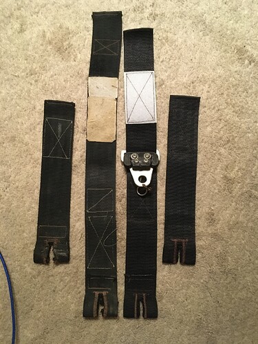

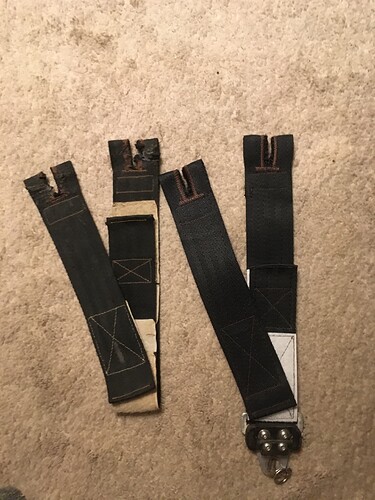

Here’s pics of two sets of foot straps, old and new. Requires some very basic sewing skills:

This is in the middle and probably more comfortable than hard plastic. I do question the abs piece breaking when I want it to and not at the wrong time

This is a safety feature that’s made to break… not your ankle. With a little science the abs tab could be made to break properly and for different size riders. MBS has gone the other direction to make their bindings even stronger. So how much force is needed to break your ankle or twist the ligaments off your bone?

Tuning the abs release definitely took some time. I now have two designs that are in the link. One is regular and the other is extra strong. If it needs to be stronger or weaker you can expand or reduce it in the z direction which will add proportionally more/less release force.

So technically this abs tab could be incorporated into the L-bracket of a mbs binding and would function like a ski binding that’s not adjustable…well there are two presets for light and heavy riders. Riding style would also come into play.
For sure. I think it would be pretty easy to integrate. You have to make a couple brackets. I’ve been using 1/8" thick aluminum.
It would be cool to see this improved to be adjustable.
