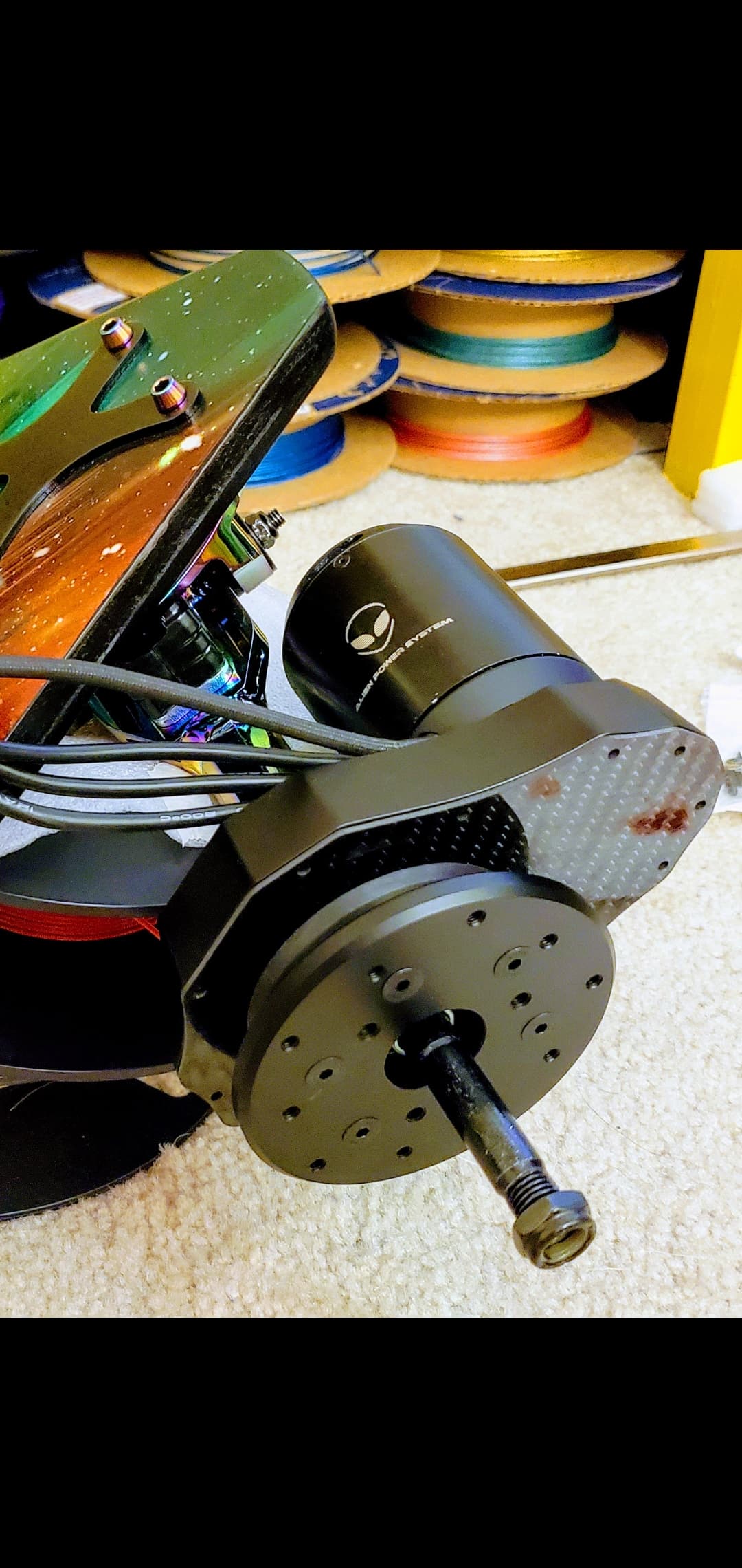

Am I supposed to put a bearing into the hub adaptor? Because neither the install guide on the Moon website nor the install video specifically demands one, they both only use spacers but the adaptor perfectly fits a bearing…
Are there pros/cons to using/not using one?
Setup is:
Batch 5 Moon drives
Trampa Vertigo Truck
Trampa Superstar rim
I thought the same but where mine lined up, the bearing would have only half sat on the axle and not slipped all the way on so I skipped it. That was many many miles ago and this is my regular board.
You don’t need to use it

Hi,
I have some issue with my Moon gear drive.
For the second time I broke 3 teeth on my gear, but not on the same side :sweat_smile:
My setup is a 9" MTB with 100kv 6385 motors, 16s 70A per side and 5,5 ratio.
My backlash is perfect (20 years in R/C cars).
The first time, the bolts that hold the hub plate to the gear were a little bit loose.
My conclusion is that it created a small misalignment and it snaped under load. Helical require more precision than straight cut.
Moon was kind enough to send me a new gear for free because I explained him that I followed the instruction that says to not use loctite nor over torque.
I replaced the gear, I used loctite and more torque on the same bolts with a bearing inside the hub plate to improve the support and the correct amount of shims to be flush with the hub plate (most important point when you assemble those GD).
I did everything to make it bulletproof (well, that’s what I thought…)
I was on a trail, at around 10kph and suddenly, on the top of the climb, after my back wheels took off from the ground for 0.1s at slow speed I heard a snap when I “landed”. I was not full throttle, my wheels didn’t spin like crazy at all before hitting the ground.
Needless to say that i knew exactly what happened…
My question for you guys is : is POM gear not strong enough for my torquy setup ? :disappointed_relieved:
perhaps it isn’t strong enough. I’ll DM you in the morning with some options so we can solve this.
it is a quite strong material for gears, (running 190kv, 12s 120a each side) but sudden impacts causing the wheel to stop ‘instantly’ will just blitz the teeth
