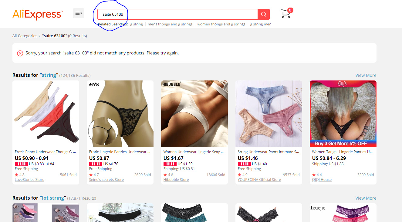

Santa Claus! Let me work on my Ali-fu, it is clearly not as strong as my Google-fu
Ali’s showing me the wrong mid life crisis specials

Those suggestions :joy:

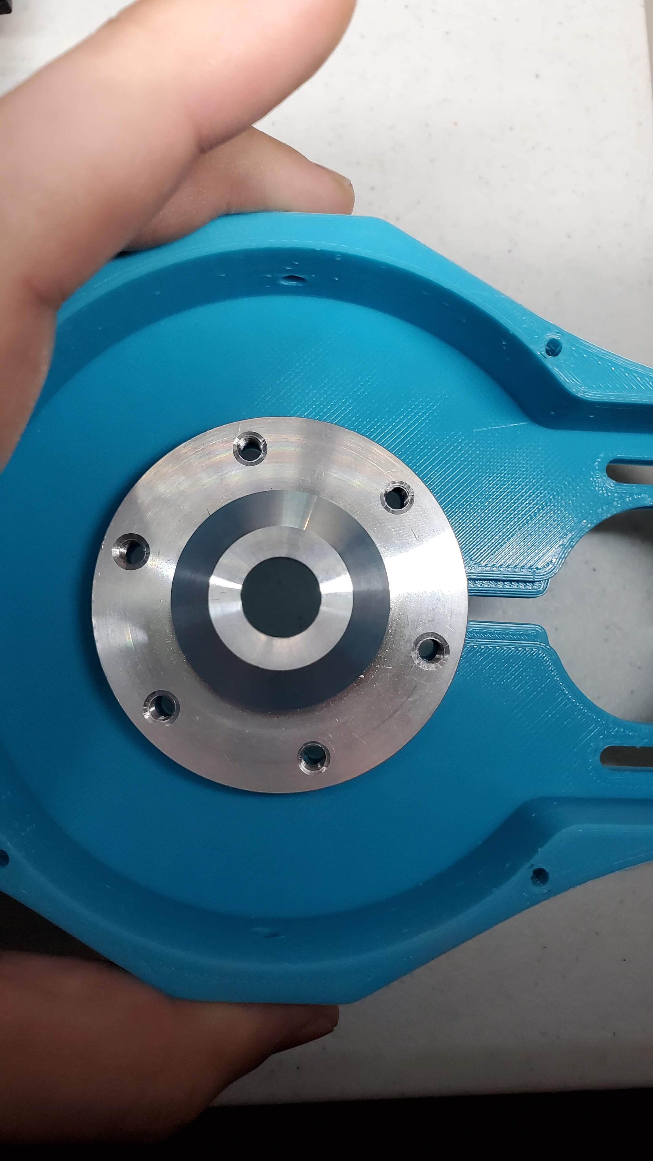

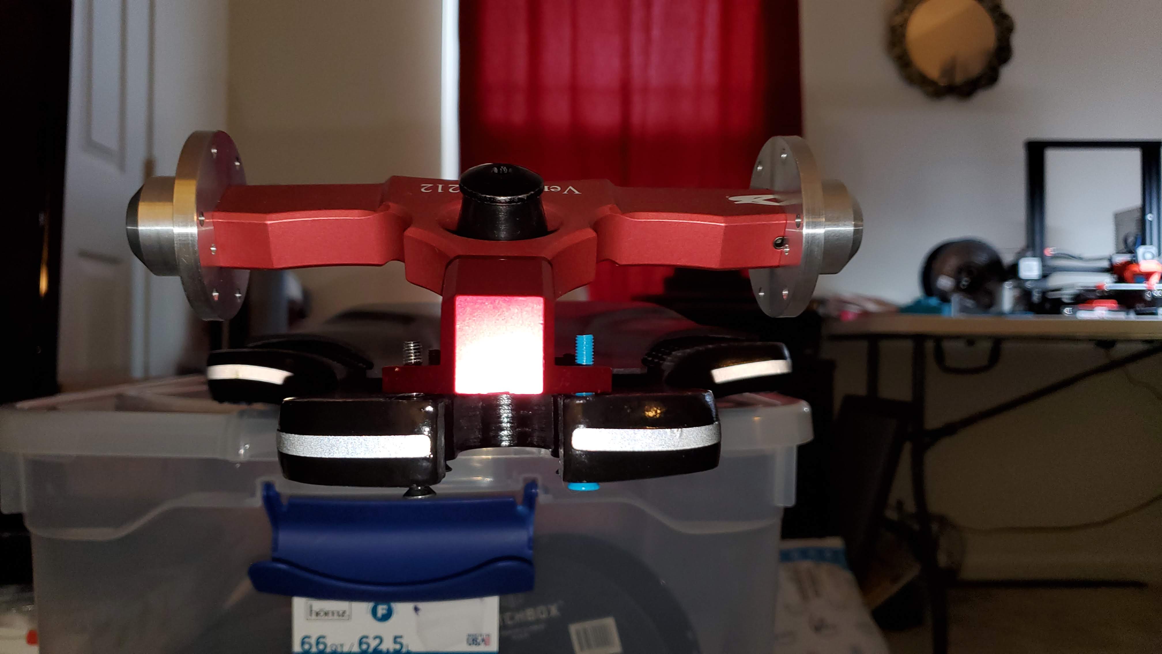

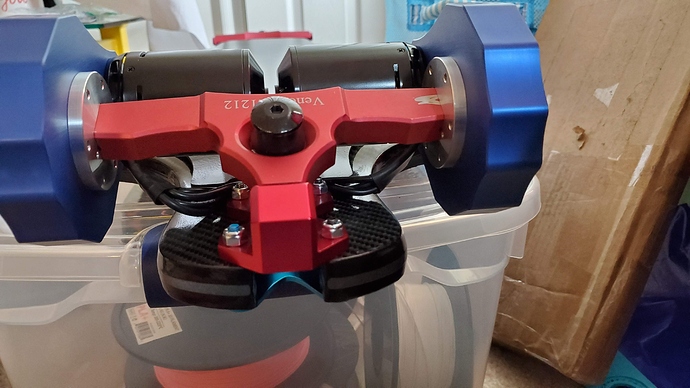

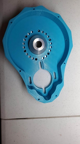

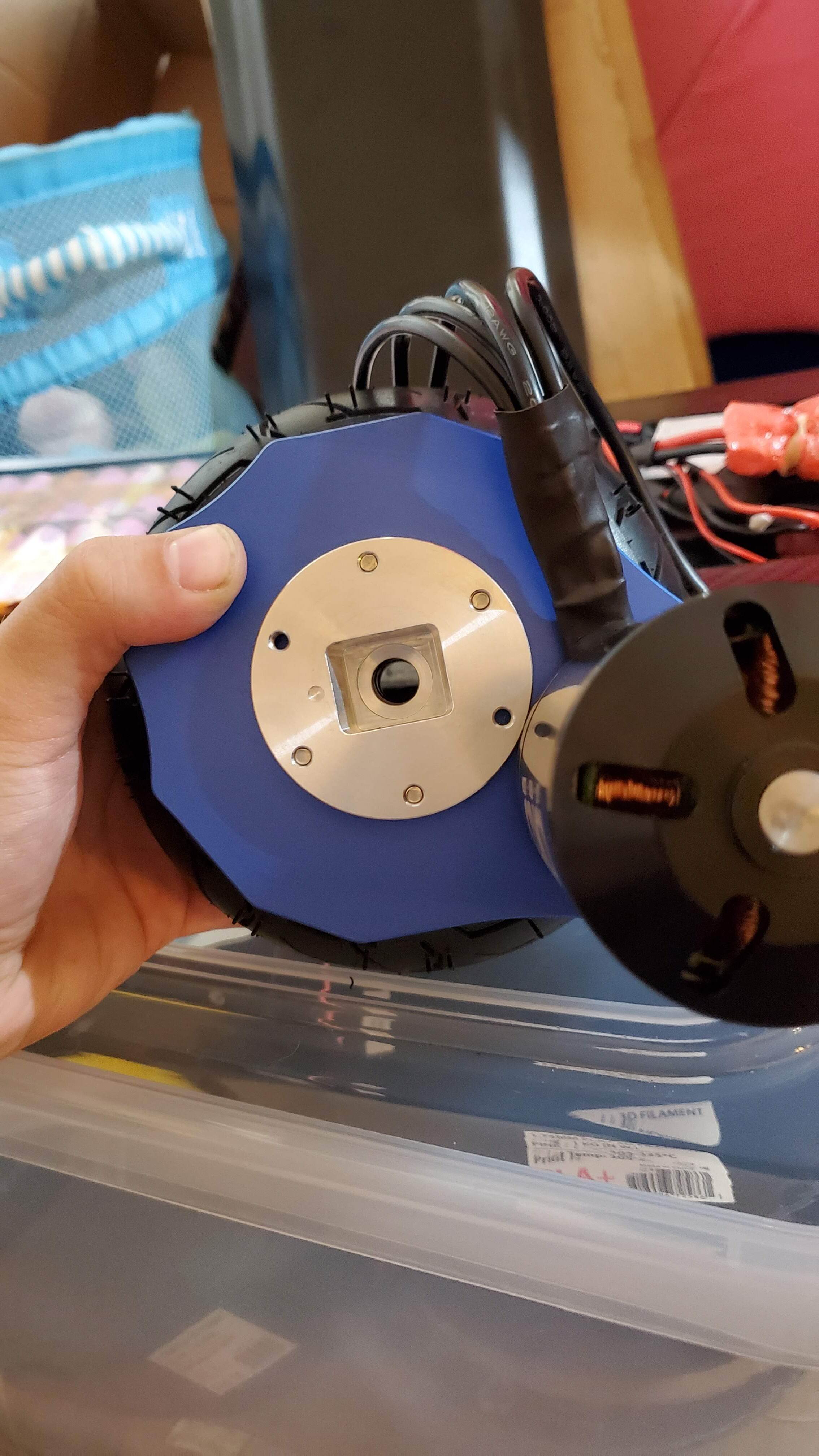

@Tamatoa, this is using lrdesigns truck clamp and not moon’s but assembly is similar. Moon’s drive will have the silver truck clamp mounted inside the drive instead of outside.
Like this
I needed more clearance on the beta unit so I put my clamps on the outside. This is fixed in the new version.
The clamps just slide on to the trucks and the shoulder bolts keep them on. If I remove the shoulder bolt, the entire drive comes off as a unit. Very convenient for aligning the gear mesh.
Then just adjust your motors with the gears in so they mesh perfectly. You want only the faces of the teeth to mesh. Apply some grease to where the teeth are meshing while you turn the wheels. My circuit board build thread has some more photos.
The adapter plate is the connection between the wheel hub you’re using and the wheel gear itself.
that is a really nice explanation thanks for spending the time to put this together.
So the clamps are actually press fitted, right? Is their the same for other hangers @moon or is it because @Venom121212 is using surf rodz?
MBS clamp is different, and it’s really secure…
It uses those m8 brake holes on the trucks
It seems pretty straight forward thanks guys.

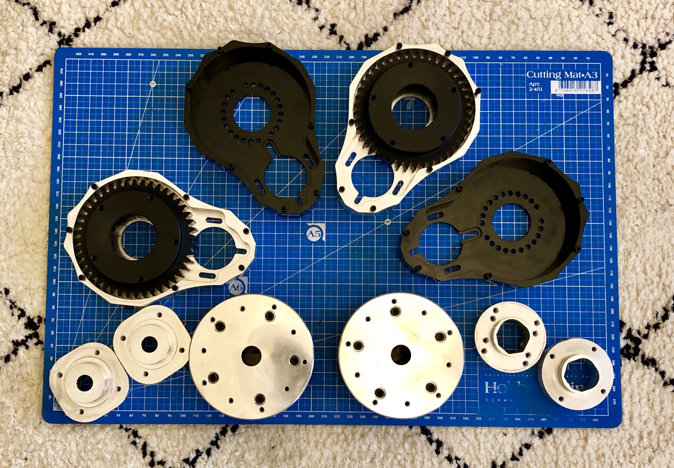

Look at the production tab on the first post
Last picture shows mbs clamps
