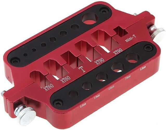

The only real tricky part of this was soldering the XT90 connector to the wires inside the box. Specifically, because I had to solder two wires per cup. Using a 3rd Hand type of holder, along with a connector holder (and mating connector inserted to prevent the barrels from melting the plastic housing of the connector) made is easier. These are tools I really recommend.
Helping Hands holder:
https://amzn.to/3UtgbGb
XT Connector Soldering Jig:
There is likely a better way to do this, such as having the parallel split 14AWG wires meet back together to a 12AWG wire before getting to the solder cups of the XT90 connector.
OR, having an assembly where the harness wires connect in the box to an XT90 assembly with bullet connectors.
I also used heat shrink rather than the click on wire shroud, since the 2 wires per cup ended up being much wider.

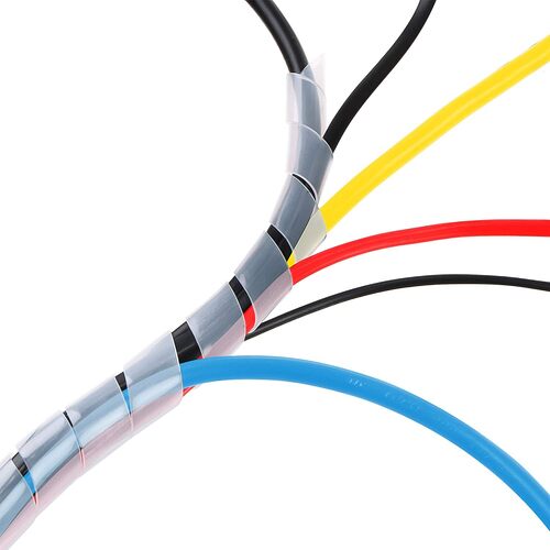

Note that below I use various insulation and tapes to shield and secure wiring in the box. This comes from habits I have from building DIY and custom electric skateboards, since those often have compression around wiring and are subject to great amounts of vibration and impact. There are some areas in an assembly where I don’t feel comfortable leaving wires to sit on or touch edges of JST connectors, or compress into other wires, and so I will use any of the following to insulate those looms.
TESA Harness Cloth Tape
https://amzn.to/3UsgJvP
Spiral Cable Wrap
