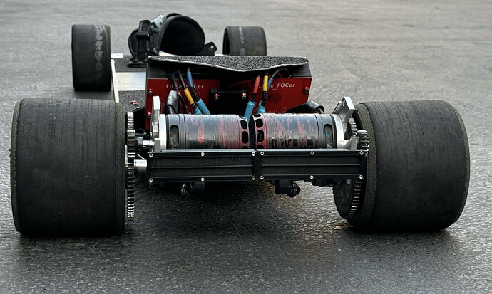

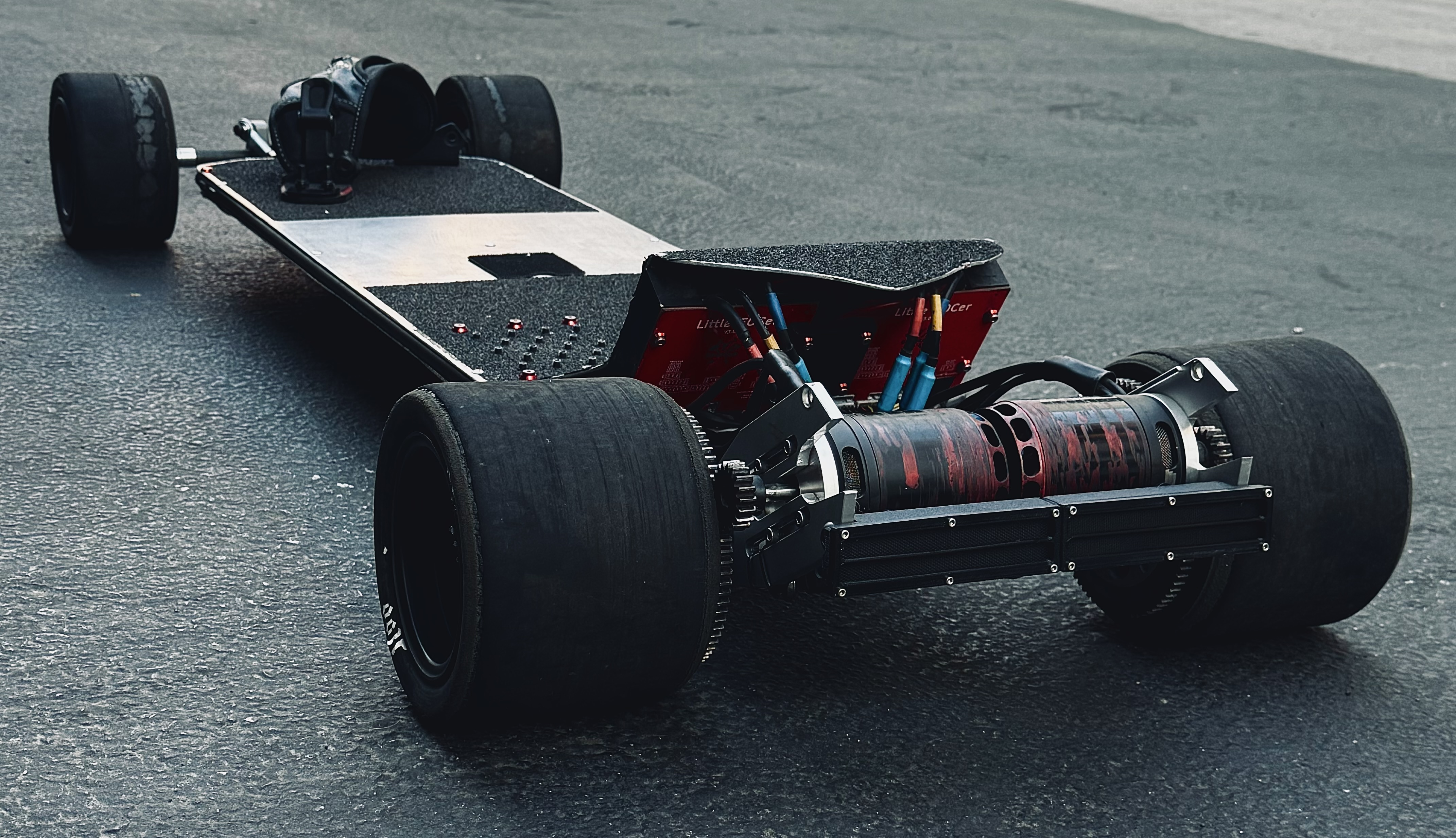

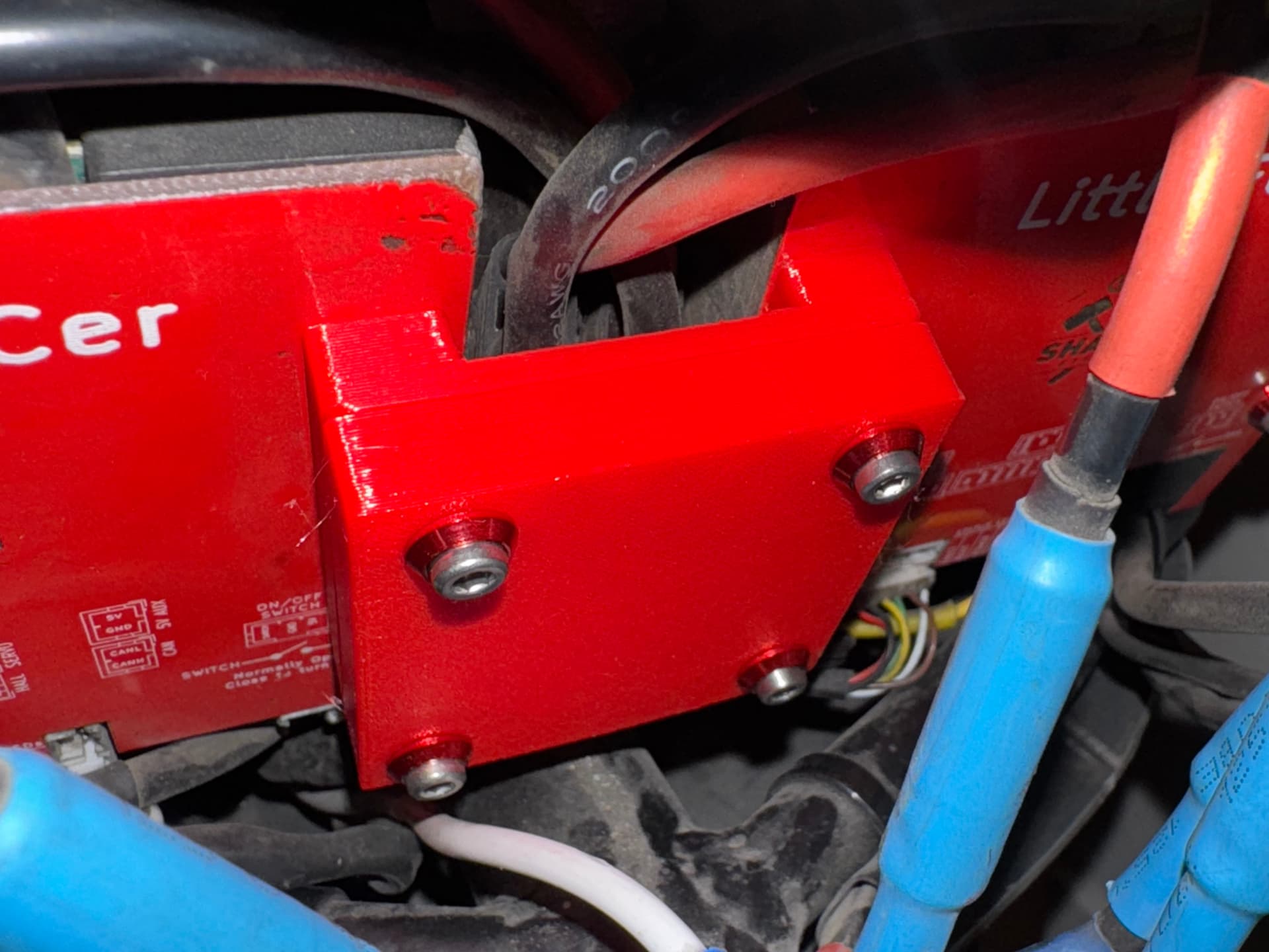

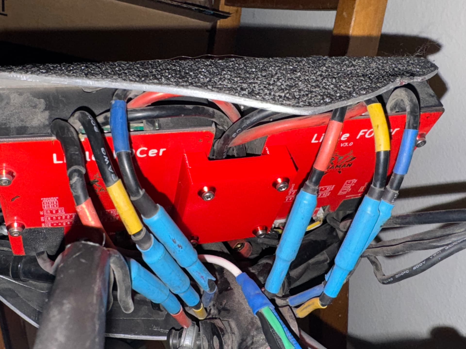

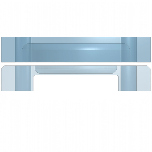

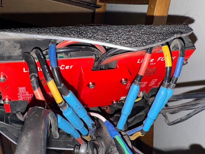

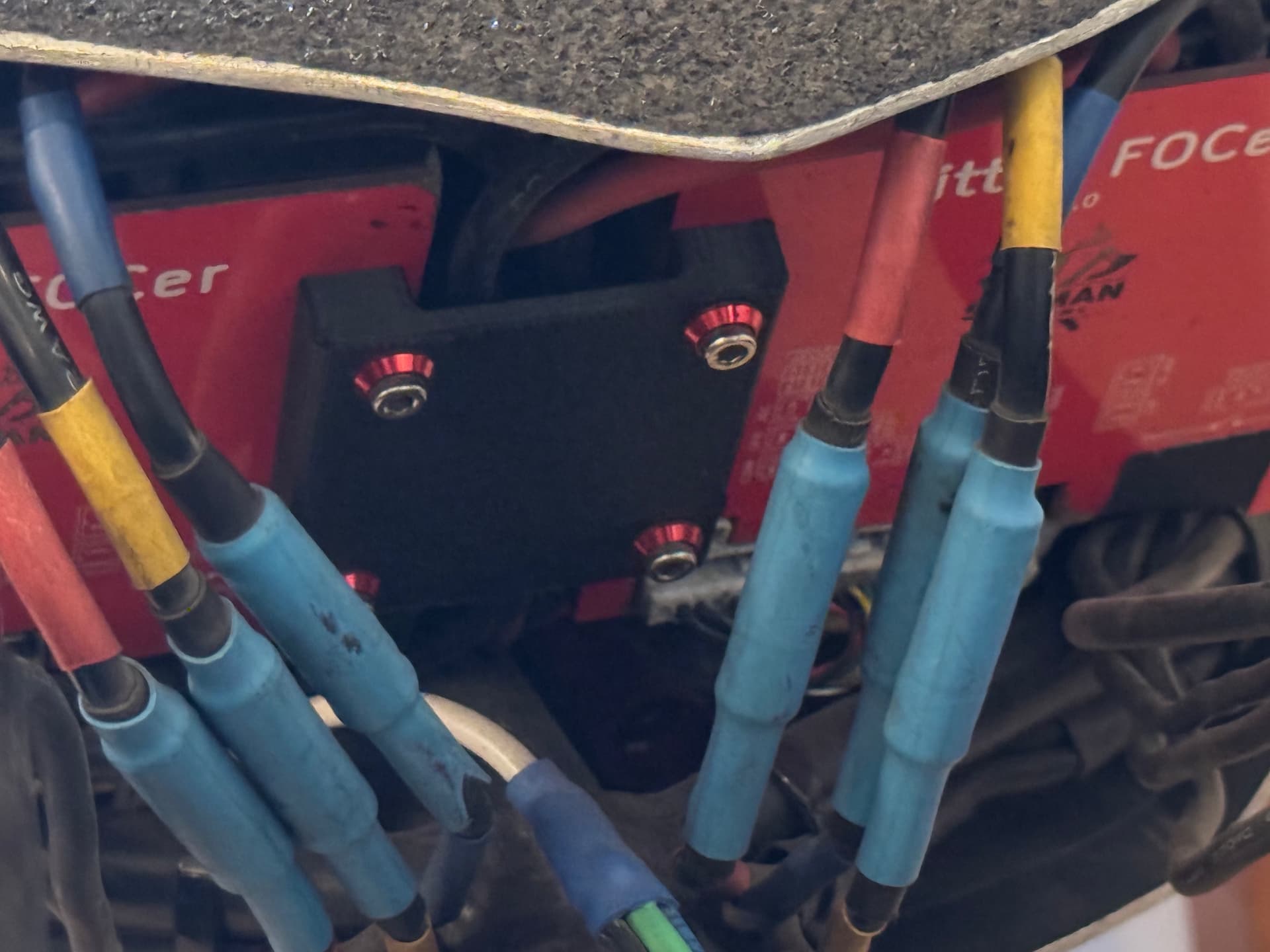

These motor mount plates looks really nice. I could make a version where the shaft of the motor goes in from the rear. The cutout wound be a straight channel instead of have a big flare towards the rear. Another ideal could be to make the plate taller to allow for the screw securing the crash bar to have a bit more real estate to be countersunk.
Open ended mounts are the best. @fujio001
The mounts I designed I was originally going to use on this board but I didn’t want to wait for them to get cncd again
But these mounts do reside on another board
Thanks I cut and filed them but hand :raised_hand_with_fingers_splayed:

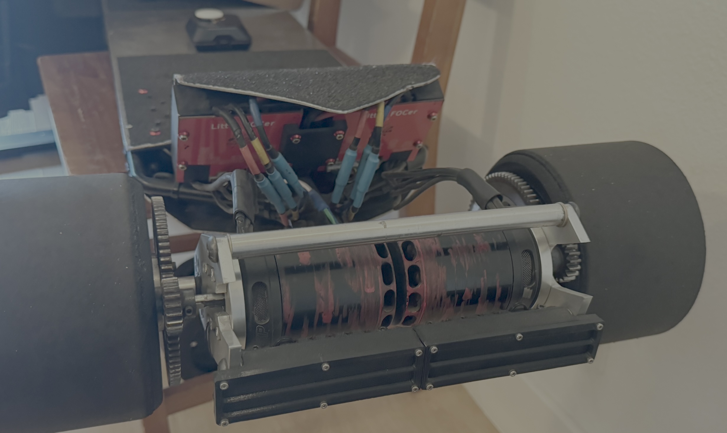

Very honored to be given that title by someone else I don’t want to take credit as I am not the first. People from ETOXX and Europe like Viktor have done inrunners with vesc. They are a huge inspiration to make my build happen.
I saw them do it so I thought why can’t I?
Don’t ever think you’re copying by using the same readily available hardware! Please by all means use these vescs if you’d like to! You do not need permission from a 19 year old teen kid to do that :heart:

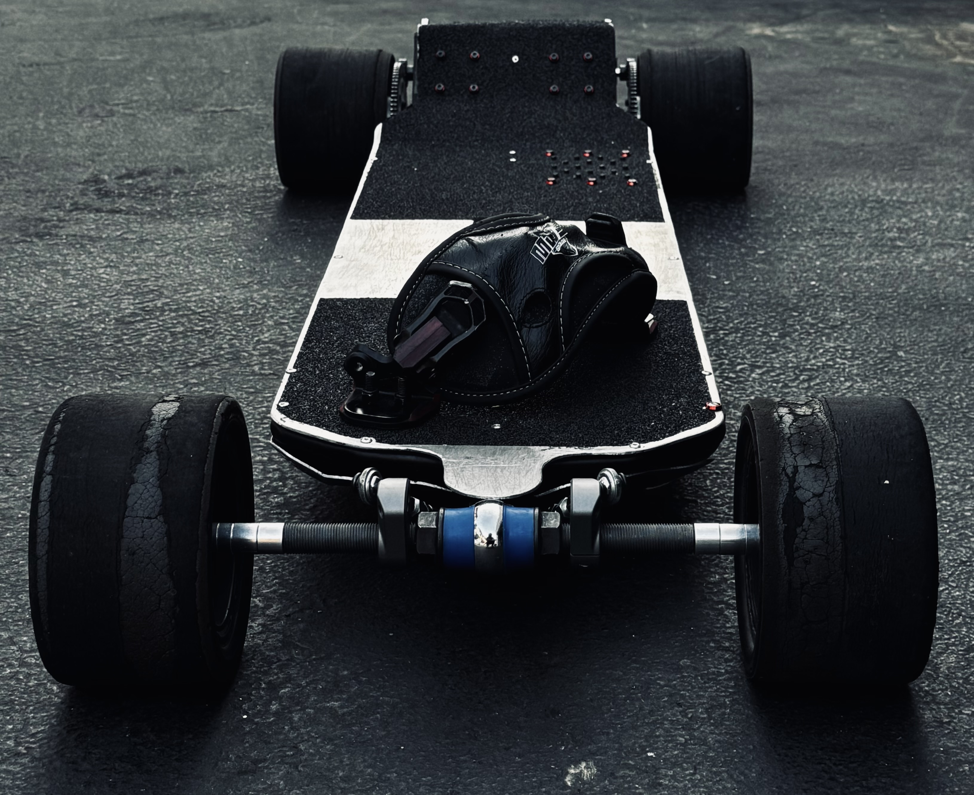

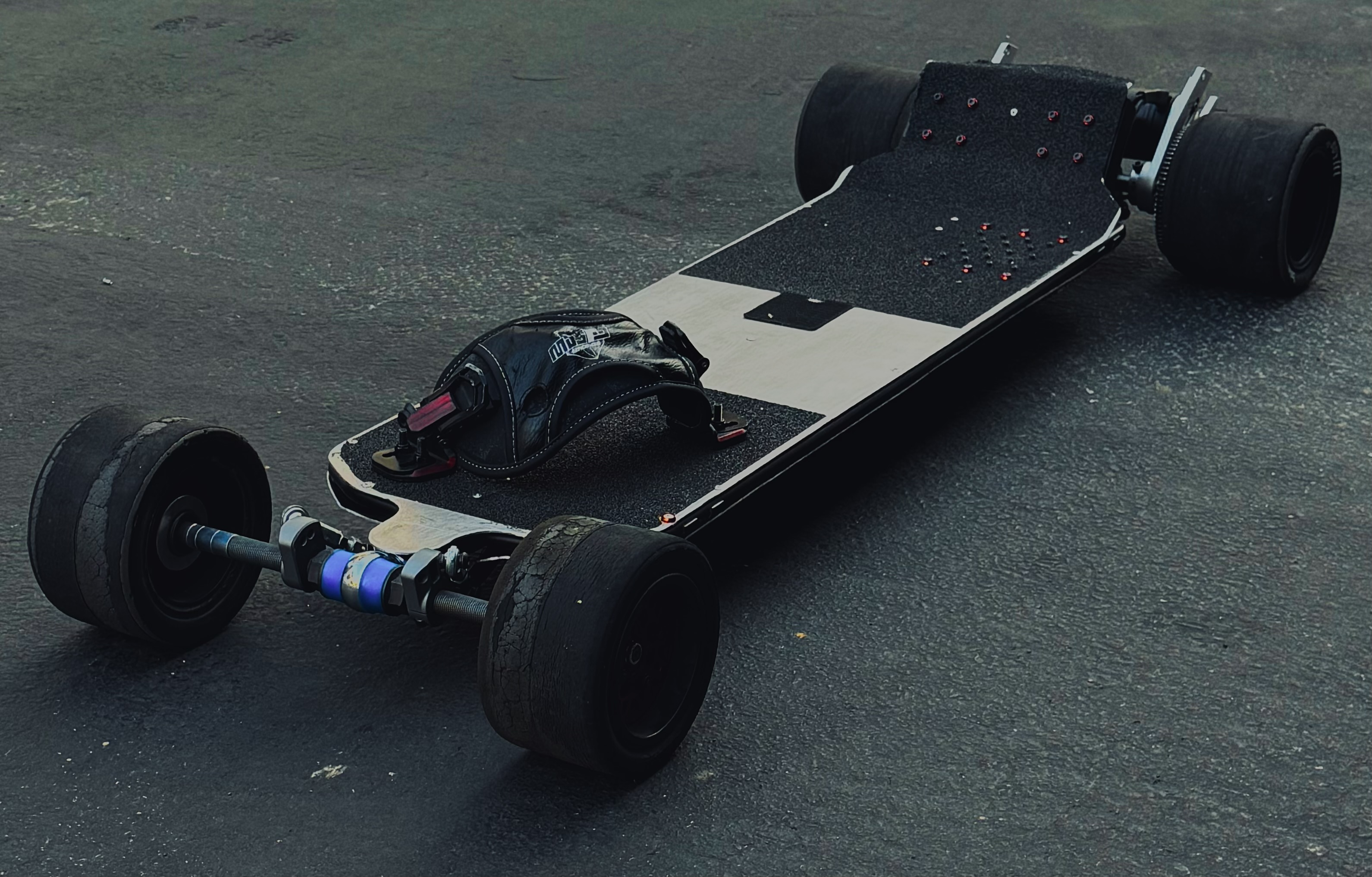

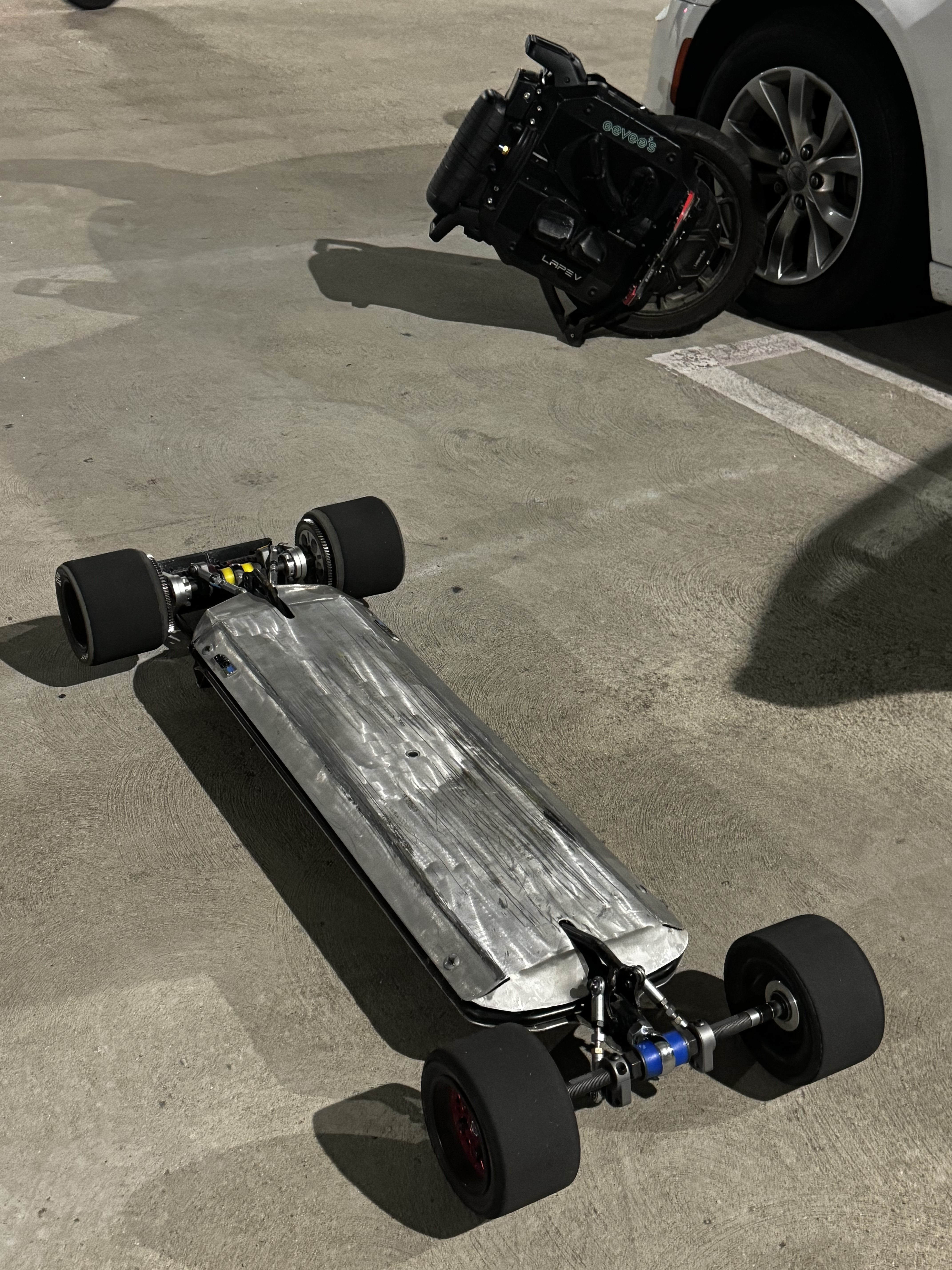

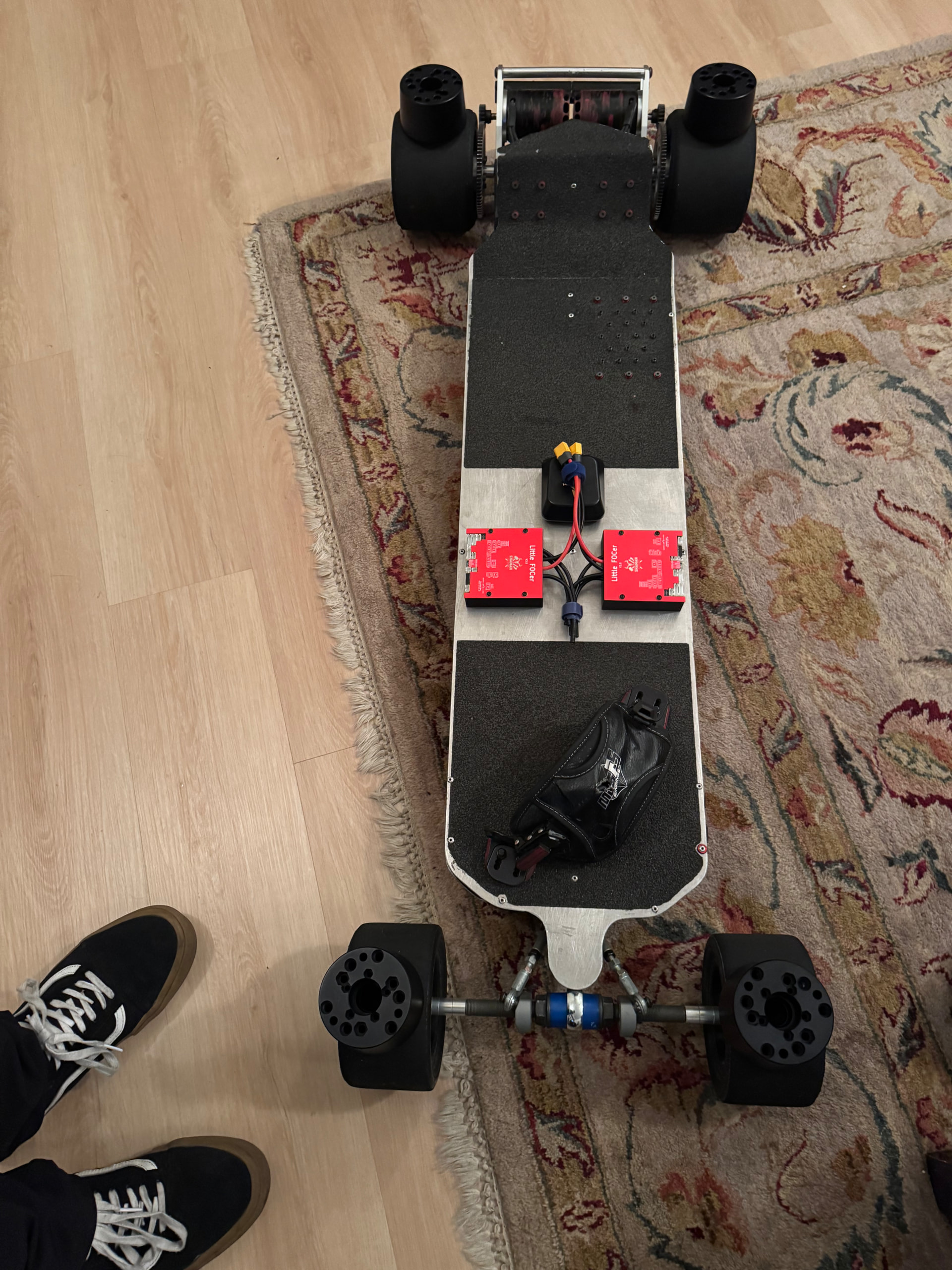

Let us know what went wrong with the proto
I think it’s steering angles. set the front to max steer.
I guess that the point of having a v5 isn’t it, pure swizzle stick action
None of this mid steer stuff that I’ve been on about
The thing is boggling me is that I wasn’t really having this problem as much until as of recently.
I definitely had it before but a lot less of it.

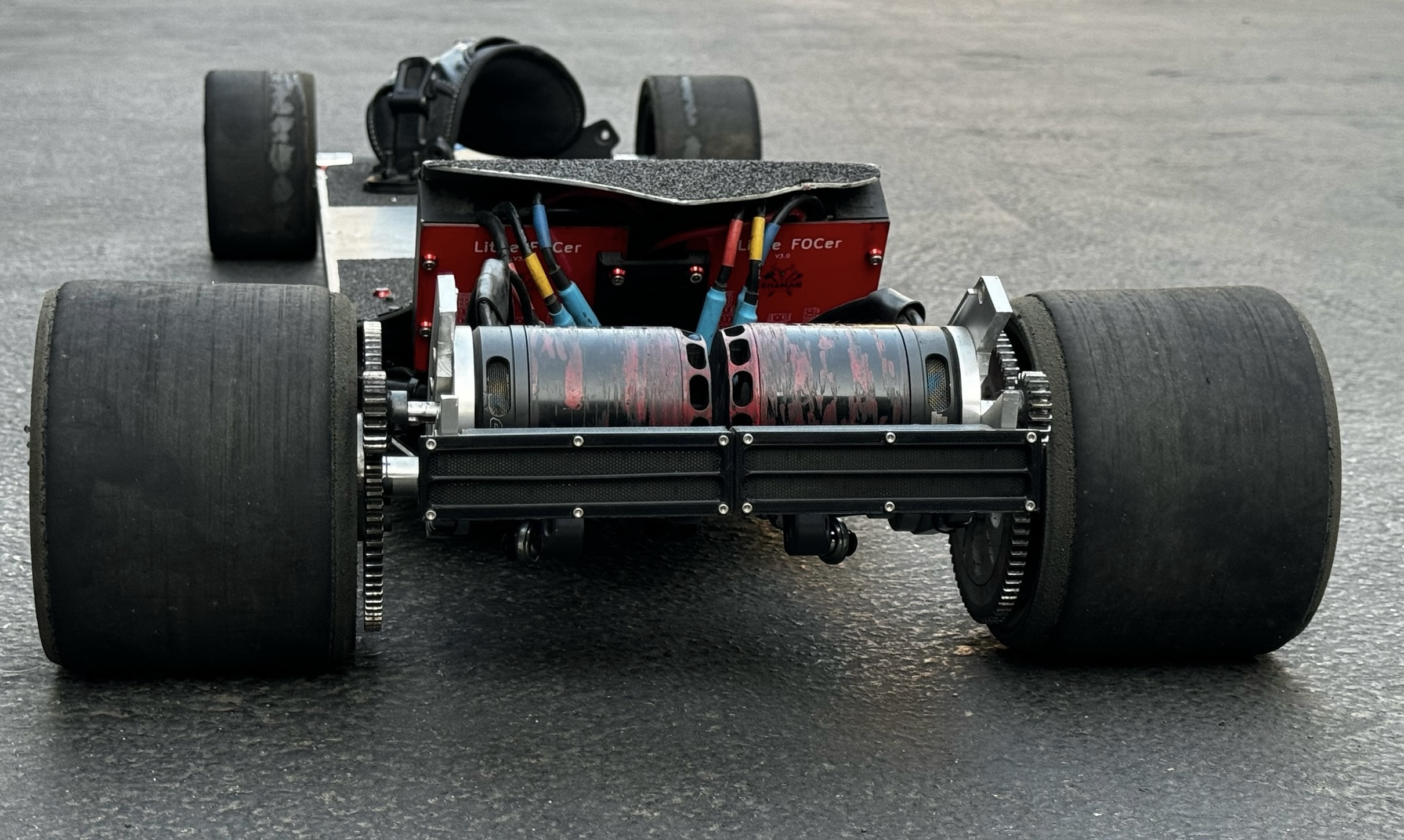

My findings tonight at my local intro to speed proving grounds were of most excellence.
Previously I was so well known for scraping
And I believe figured it out

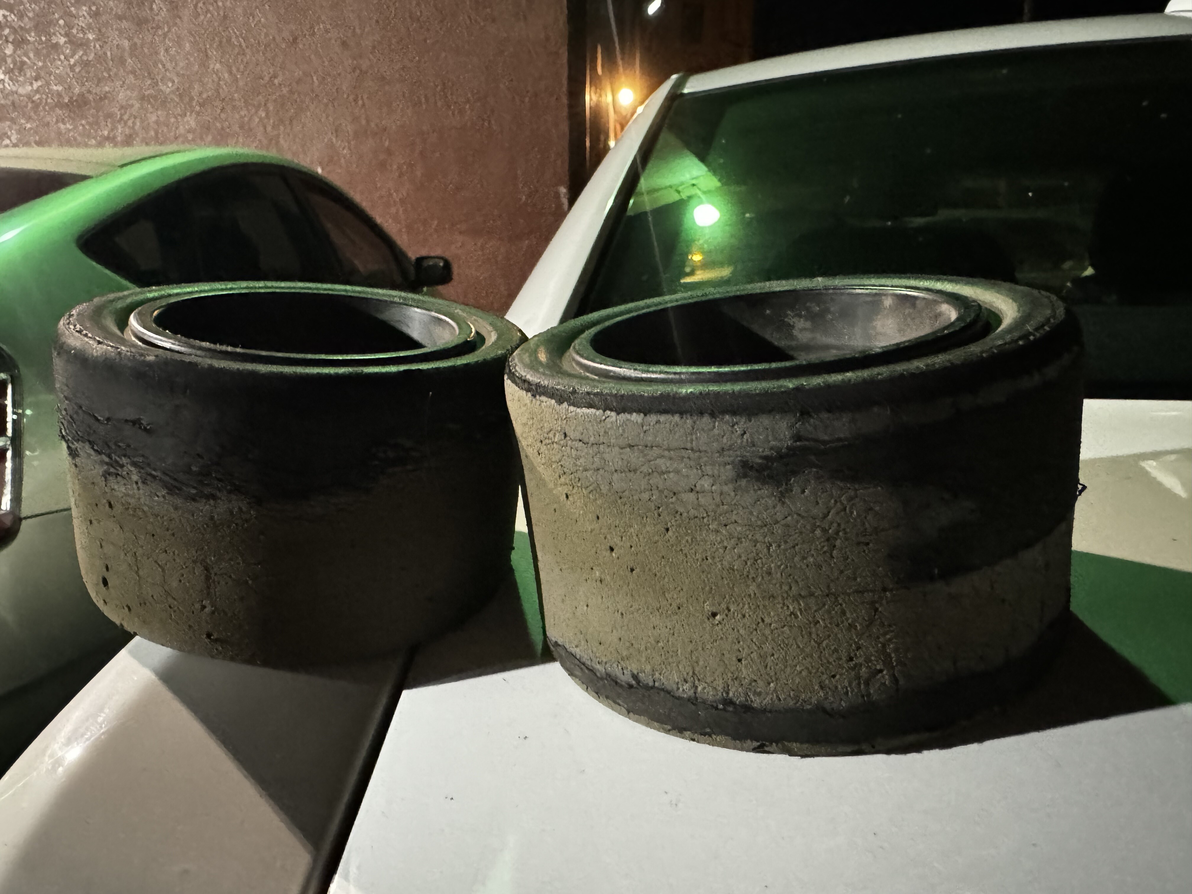

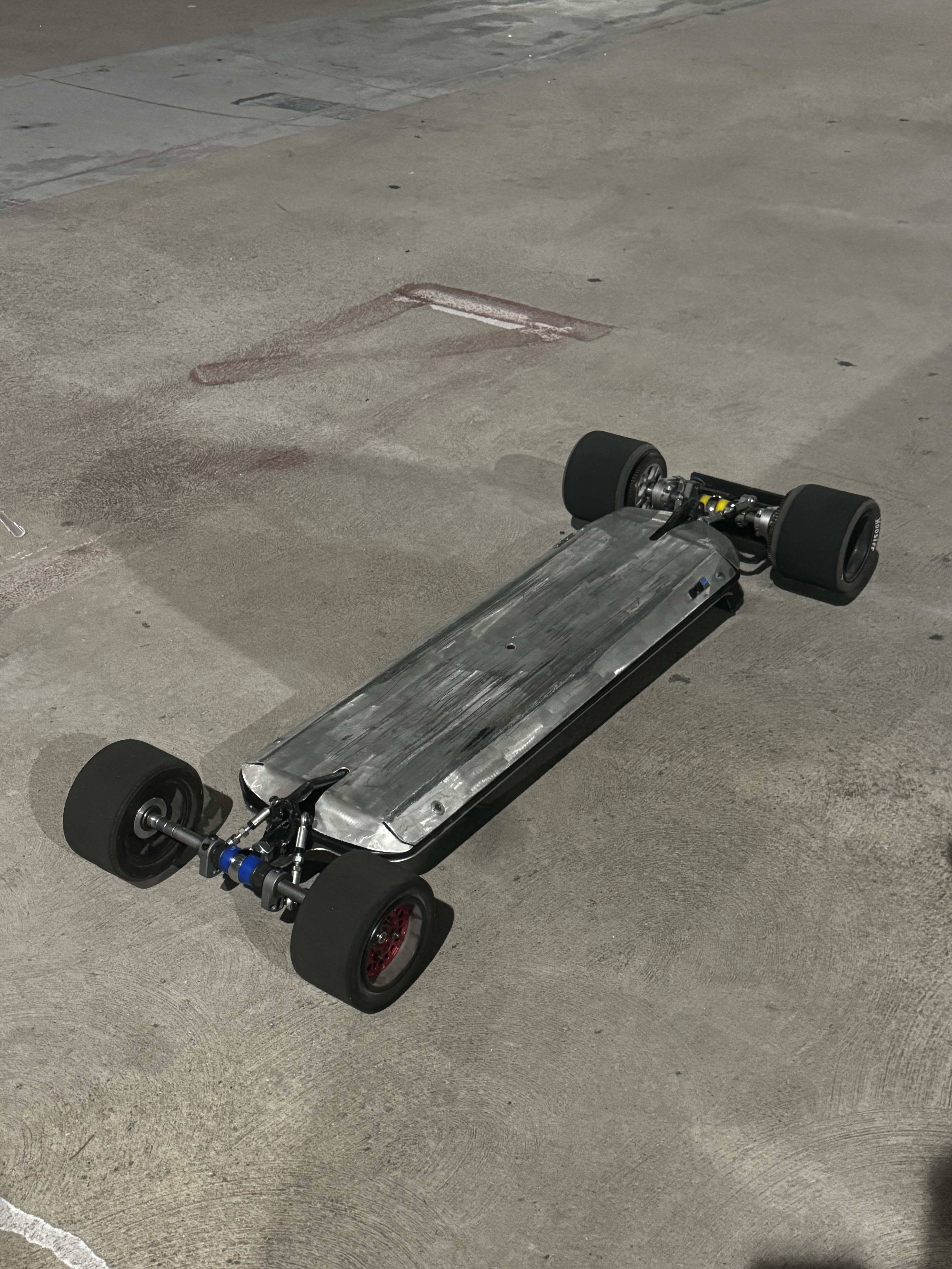

I swapped these so awesomely shredded tires to tires that had a bit more meat on them
And the extra diameter helped so much so that I didn’t scrape all night
So beware if you are a v5 owner and start having a scraping problem out of nowhere the extra diameter of fresh tires literally makes a difference
This is what I was running when I was having the scrape problem
I mean it makes sense I don’t know why I didn’t think of it sooner

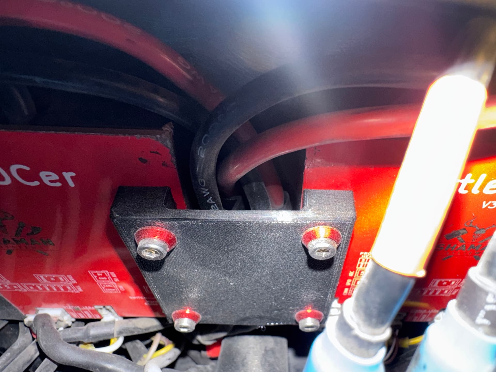

Awhile back I designed and printed this piece… pretty simple in function nothing to write home about.
All it was doing was holding the xt90 split loom snug. (So it wasn’t dangling)
But I just revamped it to hide a AirTag inside it as it is a now a two piece flapjack
So now If someone steals my board I can track them down and rip their arms & legs off :grinning_cat:
Not a super fancy design but should hold up :+1:
