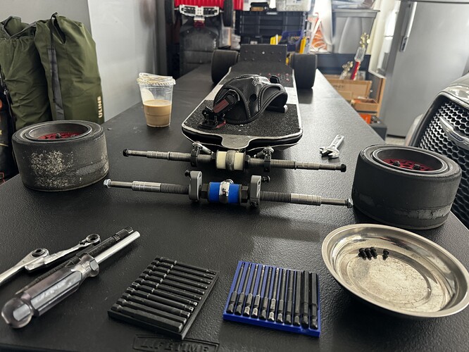

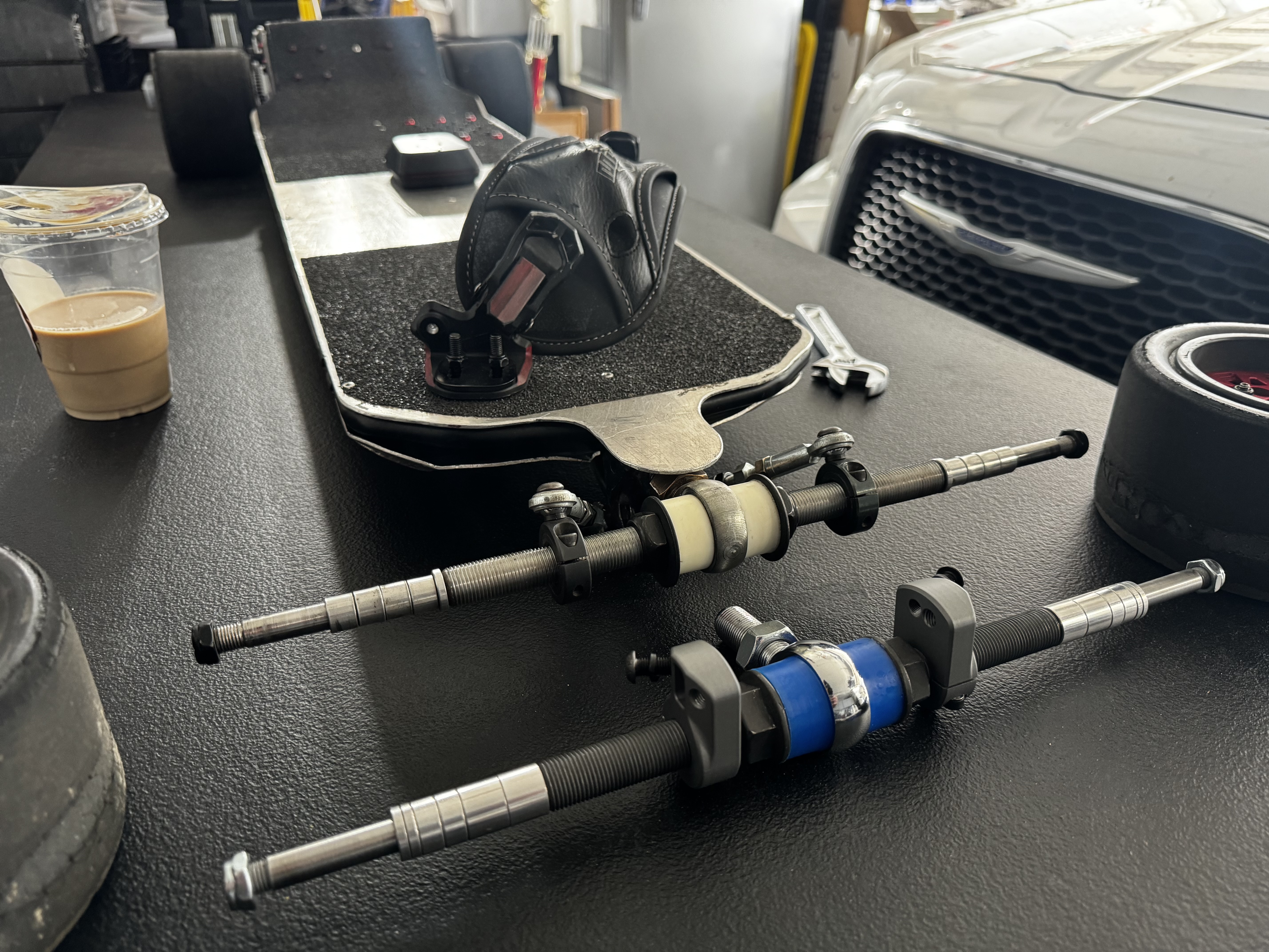

Ultra crimped
1of 4 links done :grinning::joy:

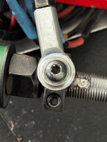

nice job finagling loctited hex bolts.
I use a wera, because they have good bite, M4 because it fits and is slightly larger than 5/32.
and with red loctite, i try to wait for the heat to work before relying on moar torque.
Ahaha a 4mm and a hammer is what I used aswell after the 5/32 stripped. (You can see in the 3rd photo 4mm stamp)
I just torqued the hell out of it when Installed the screw back when so it was pre fucked
Looking quite E V I L
This is the Tool I utilize for the Bits below I’ve Put it through some HELL and it just works, I highly recommend these items
This brand or rather this specific product also Has good Bite
