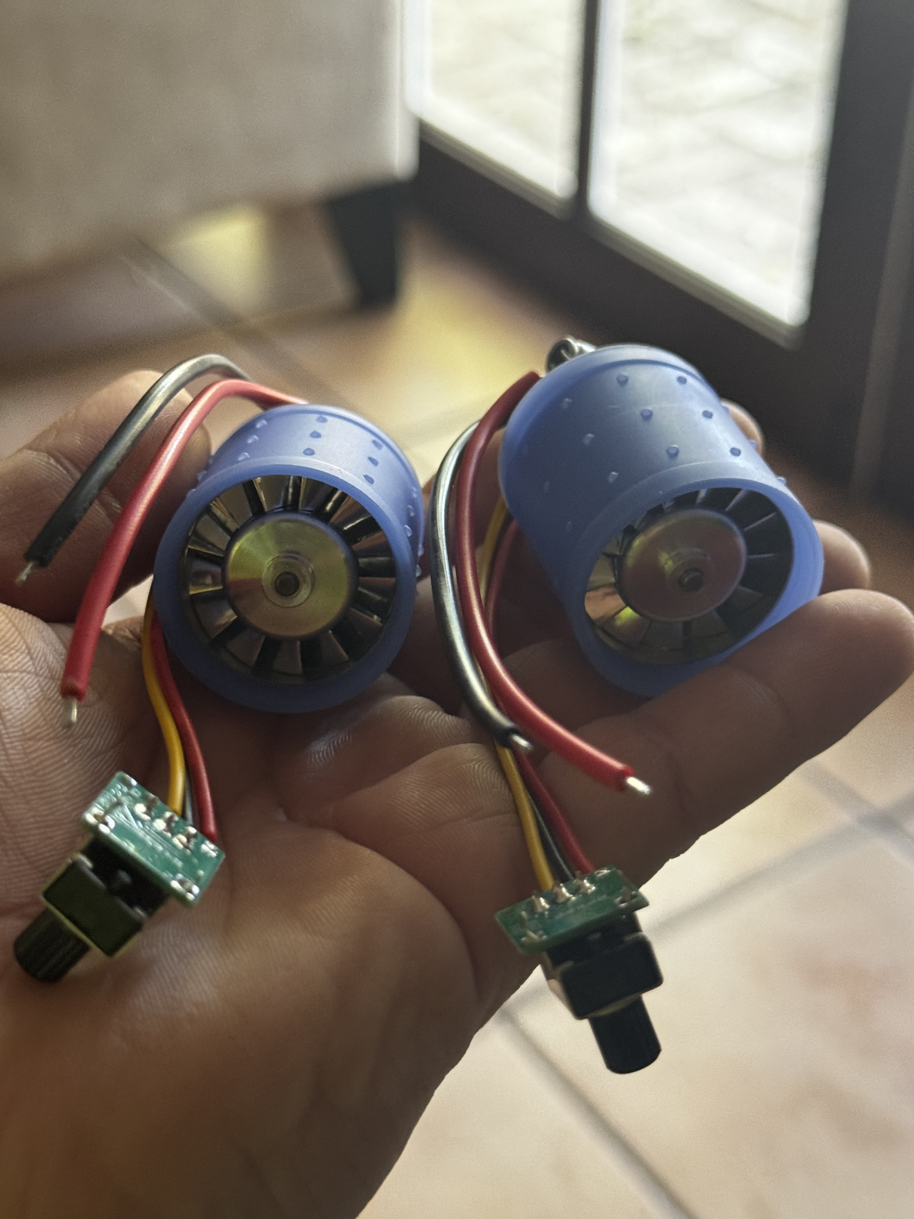

Quick little update…
Got the fans
But upon inspection something looked wrong.

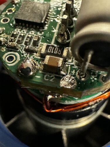

The positive power lead to BOTH the fans looks like it was crossing paths with this resistor see below →
Luckily I didn’t plug them into a power supply right away.
So I whip my soldering iron out and try to wick away as much of the bridging I can get.
I don’t understand why the positive lead terminal would be so close to something else on the PCB enough for it to bridge anyways.
I’m going to finish the process for both the fans and cross my fingers that they turn on and don’t blow up in my hands. After I confirm they work it’s back to the drawing board to design the shroud.
That’s a capacitor not a resistor. Not impossible that it’s used for input filtering given that it’s so close to both the + and the -. But also not impossible that the factory soldered it wrong.
