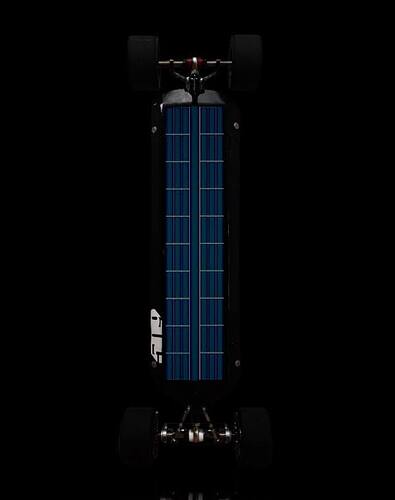

hmm Just thinking what ifâŚ
20s6p using 21700 cells,
potentially Utilizing P50B Cells when they become Available
Playing around with some prototype concave designs
Super rough idea of what itâs supposed to look like but it should help with toe side turns and with heel side turns youâll pivot your foot off the the concave and rest it on the flatter portion.
Iâll keep you guys updated once I start 3D printing real deal and whether it actually helps.
Concave makes a huge difference! Whatâre you modeling in, is that blender(?)
Havenât tried adding it to the rear of my v5 (yet), but Iâve got a mbs camber pad on the front. You probably donât need as much as you think, just 5 degrees made a huge difference.
Sorry for the late response man I just had a sailboat to mexico and I got back a couple hours ago⌠itâs embarrassing to say Iâve used solidworks, fusion360 and also some other programs but since Iâm currently not in school I dont have the licensing for it anymore but I use tinkercad for quick ideas like this hence why it isnât as detailed. But it honestly works great, I find it much faster for basic things you are modeling. But I wish I had the cracked version of solidworks Lolol Iâve been trying to download it off torrent sites but itâs like awfully complex to unpack as a desktop application. Maybe itâs not that complicated but idk Iâm having trouble anyway.
Graduated two years ago, so I lost access to student version of solidworks and fusion 360 too.
Iâve switched to onshape for all my stuff, highly recommend.
Ill definitely try it out thanks man
