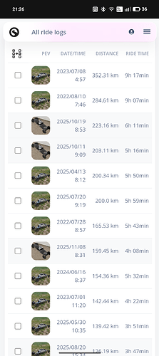

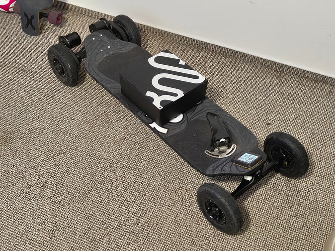

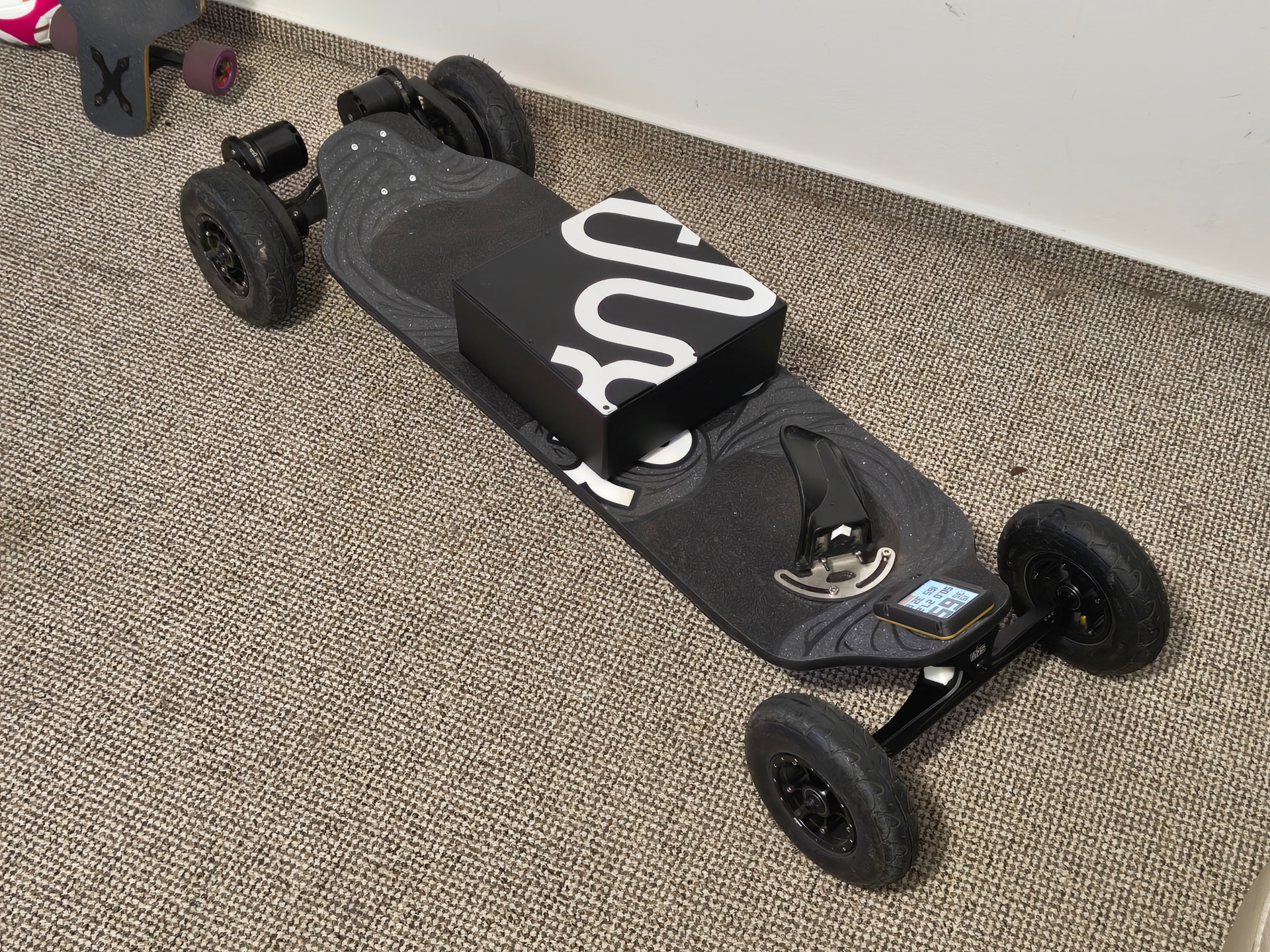

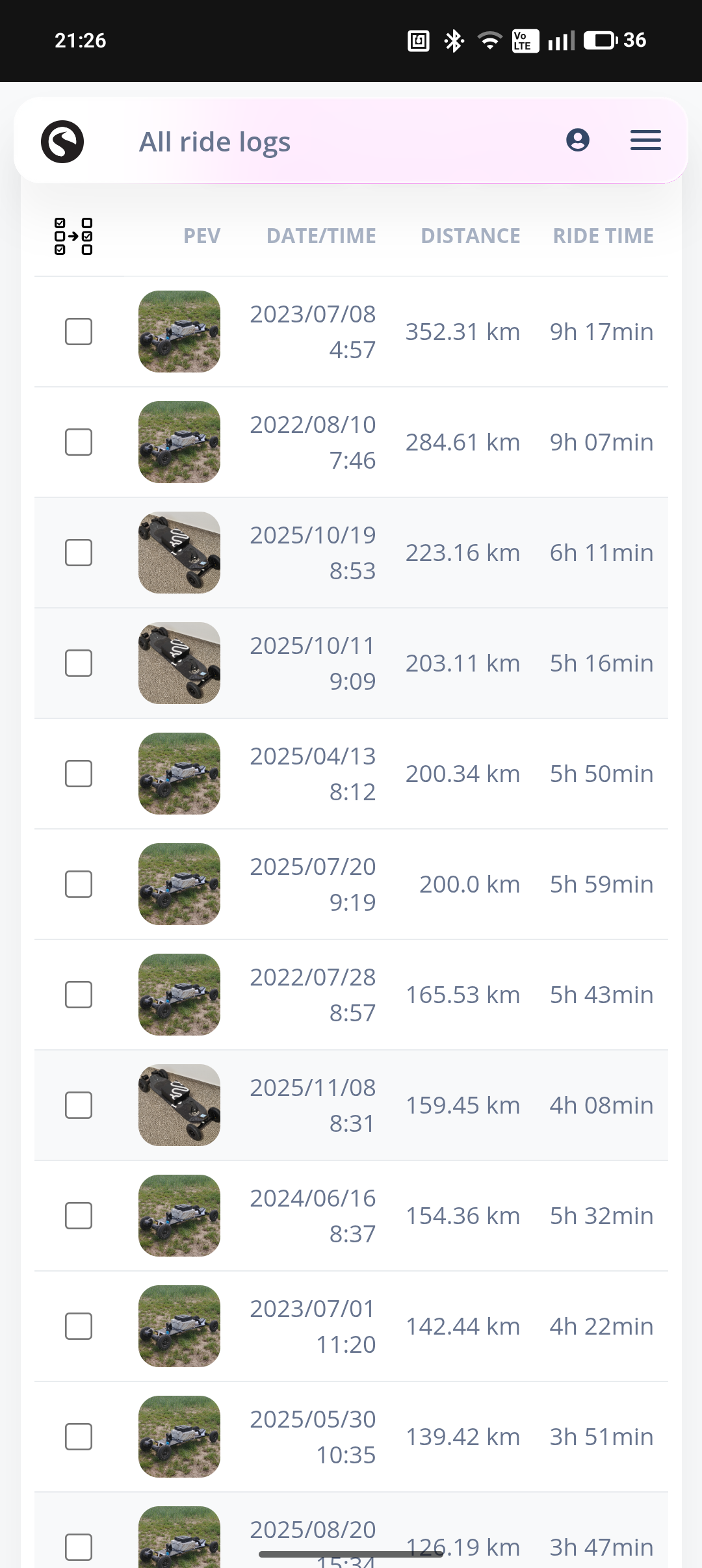

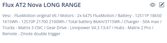

Haha. I had the same build as I have now. Over time, I got rid of that board and now I’ve built it again. The only difference is that back then I had a slower 35A charger — now I have a 50A one.
Old photo without gear drive.
How many charge stops and how long were they? I wonder what your average speed minus the charging was. You were on the road I’m guessing ? Empty with no traffic or intersections? Just send like EUC numbers to be insane
You can see a ride on the old board for example here:
https://www.youtube.com/watch?v=YqMrobtcjwo&t=128s
It’s a bit of a boring video, but it gives you a good idea of how riding looks over here. :grinning_face_with_smiling_eyes:
I didn’t always charge from 0% to 100% — I charged whenever it made sense based on charging locations and how my legs felt. :grinning_face_with_smiling_eyes: So I don’t really know how many stops there were. My range was around 120 km with this kind of riding.
Total time? I left Prague at 5:00 AM and arrived in Vienna at around 8:00 PM. After that, we rode around Vienna for a bit more, which is why the total distance was about 350 km. So overall it took 15 hours, with roughly 9 hours of actual riding time (not counting charging).
