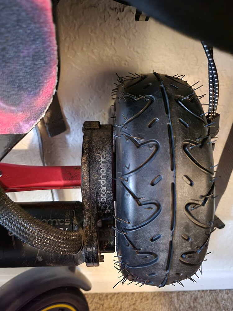

This is how flat they were when inflated on my BN GT3 hubs, which are 49mm tire seat width if I remember right. I had them at around 35psi, some people run them lower which would help flatten the profile.

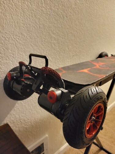

Yeah understandable. Just really like that flat profile look. Y’all have any pics of the cst 8 actually in a board?
