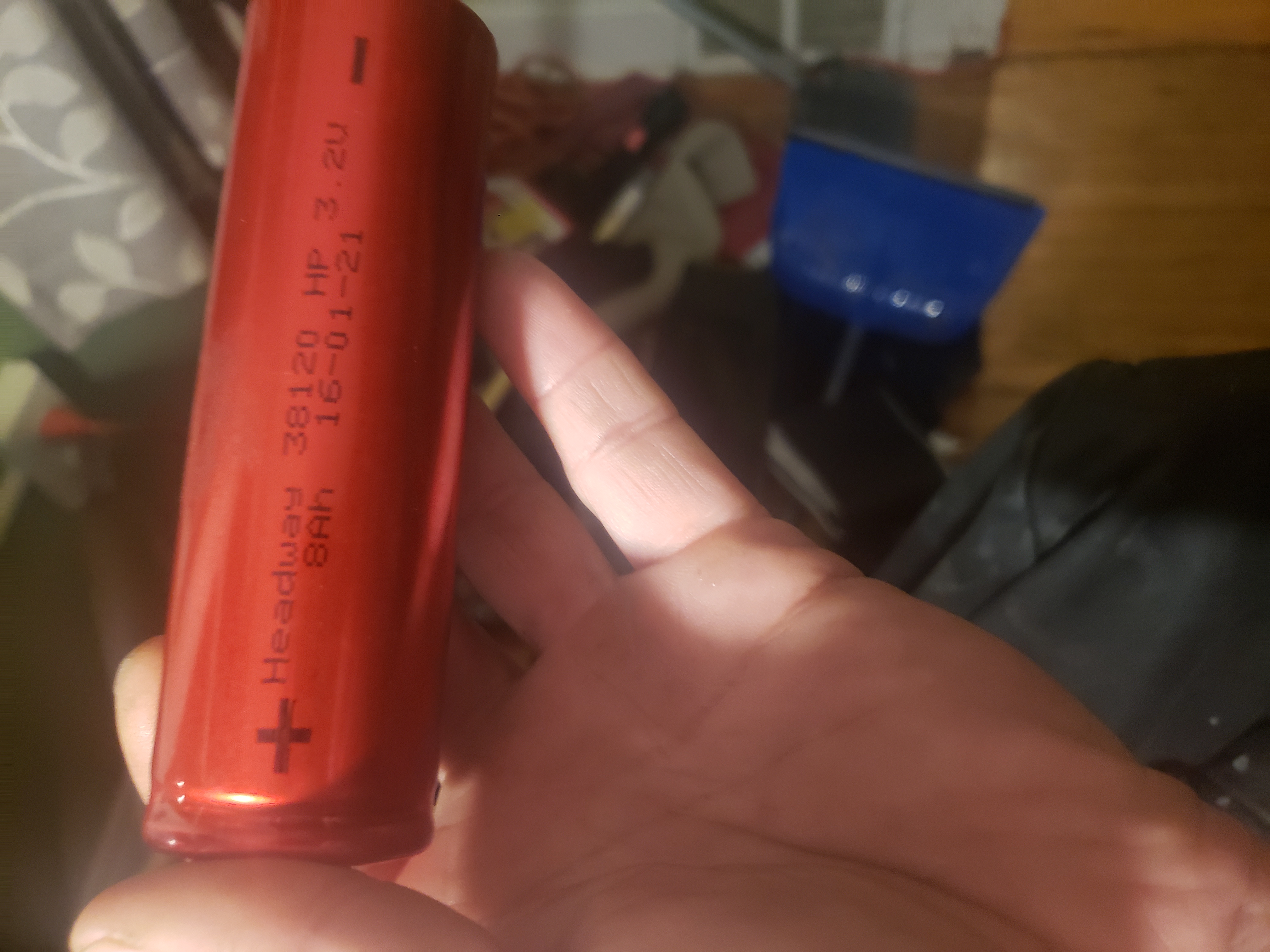

When you say p group are you referring to the parallel grouping?? Also, I am building a serious all wheel drive 4 wheel drive system using 4 of the torqueboards direct drive system and I AM in NEED of the SAME AWD (4 MOTOR) type of power that you are looking for… I am planning to use these big Daddy’s (SEE pic) which are 3.2V 8Ah with a maximum discharge of 160 amps per cell (per cell)… building a 12s 2p or a 32V 16Ah pack… Discharging a massive amount of amps which I need to find the right BMS to use. Also, my favorite thing about my HP Headway cells is no spot welding needed…!! :+1:
