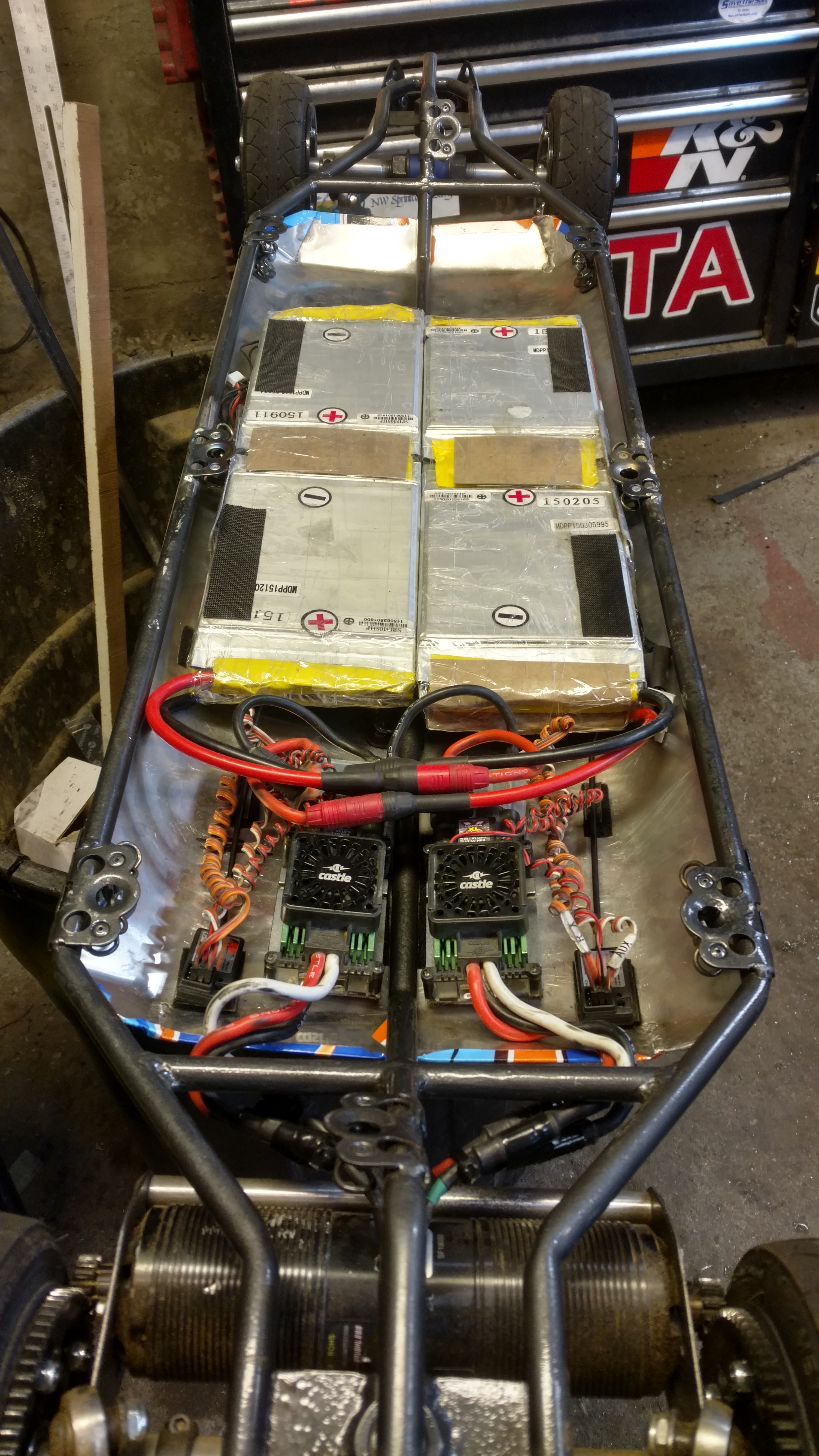

I’d love to figure out a way to water cool these cells for far longer life
I always thought on inventing a ā€˜Submarine’, a cooling system to cover the Lipos and take aways the heat. Like some sort of gel in a plastic cover surrounding the battery. Like a sleeve that you put around the battery. Pretty simple putting it on and the gel will take away the heat from the battery out the enclosure to some sort of radiator or aluminum plate in which the heat will transfer out by wind cooling it down.
Well, I’m not an engineer, and the gel is just a thought, but it could be anything else , water, oil, antifreeze, etc. The important aspect is the idea of the ā€˜Submarine’ or covering sleeve for the battery in order to take the heat out. The ā€˜Submarine’ will be similar (in concept, not form) to these type of gel masks or gel bags…
received_557742995143180
To solve this problem, I present to you aluminum microchannel tube: https://www.hydro.com/en/products-and-services/precision-tubes/micro-channel-tubes/
This stuff is used in the Model Y (and I assume Model 3) between cells for cooling. Coolant is sent through each end of the battery, with these channels running the length of the pack. When I eventually get some of the SPIM08s, I will be testing the use of this microchannel for a cooling method. I won’t encase the cells in epoxy like Tesla does, but will try and keep the pack fairly compact still
That’s another way to do it :+1:. What I was thinking is a bit different. More like a plastic sleeve with refrigerant inside, gel or something else, to take away the heat.
Why plastic? Because it will be kind of flexible and could be ajusted to different battery sizes, let’s say 12s4p to 12s7p lenghts or from single to double stacks or even triple stacks. Sort of a universal type of gel refrigerant sleeve for using on long rectangular Esk8 batteries, similar in shape to what wide plastic shrink wrap for different battery sizes are. This one will also be for long battery sizes. This makes any sense?
Most cost and size effective is using Aluminium fins between the cells which then connect to a cooling block that either has mass or is air/water cooled.
(A bit similar like DRAM cooling blocks.)
But do these cells really get so hot?
Instead of adding weight and volume with a cooling system, you could just add 50% more capacity and it would equally solve the issue.
i still think that plumbing the whole tub of cells (recirculating oil to a radiator outside the tub) might be easier, cheaper, and lighter than using water cooled heatsinks
Mineral oil ESK8
I like it.
If you add water to the mix, you can switch to a steam powered esk8 after the pack drains.
In seriousness though, if you could live with/deal with the weeping wicking mess, the convective surface area would be unbeatable
soo where are folks getting the bus bars for these babies
Dual 8s packs 480wh on these pouch packs. Will have data logger on duty.
For short track and hill racing, super fast charging.
Used Pop rivetes and plates #8 wire. On the charger, will be testing tomorrow.
