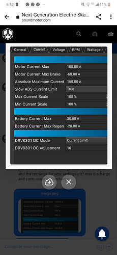

bound motor said make battery current max 30.00 A and Battery current max regen -20.00A and they sell the same pack it seems.
also these are the defult vesc settings eovan used on the first GTS i dont know much yet about esc programing but this seems very wrong.

This is bound motors flash board specs with this battery they said
seems like this is what your should go with but i would ask someone who is more knowledgeable first.
thats a bit high but you can give it a try.
what is high?
battery amps. that’s gonna sag through the floor for not that much extra performance
