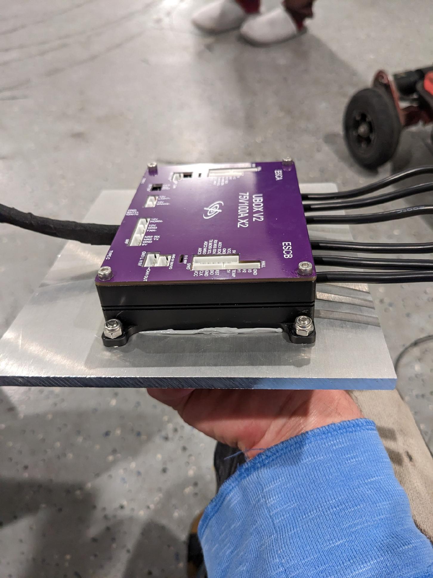

Motors:
- 138kv 6485s Skyart’s Motors
Enclosure:
- eboardsperu Double-stack fiberglass enclosure shaped to Kaly XL deck
(https://www.eboardsperu.com/product/kaly-ds-18650-21700/)
VESC:
- Spintend dual 75v/200a V2
(Ubox V2 75V 200A Dual Motor Controller Based on VESC – Spintend)

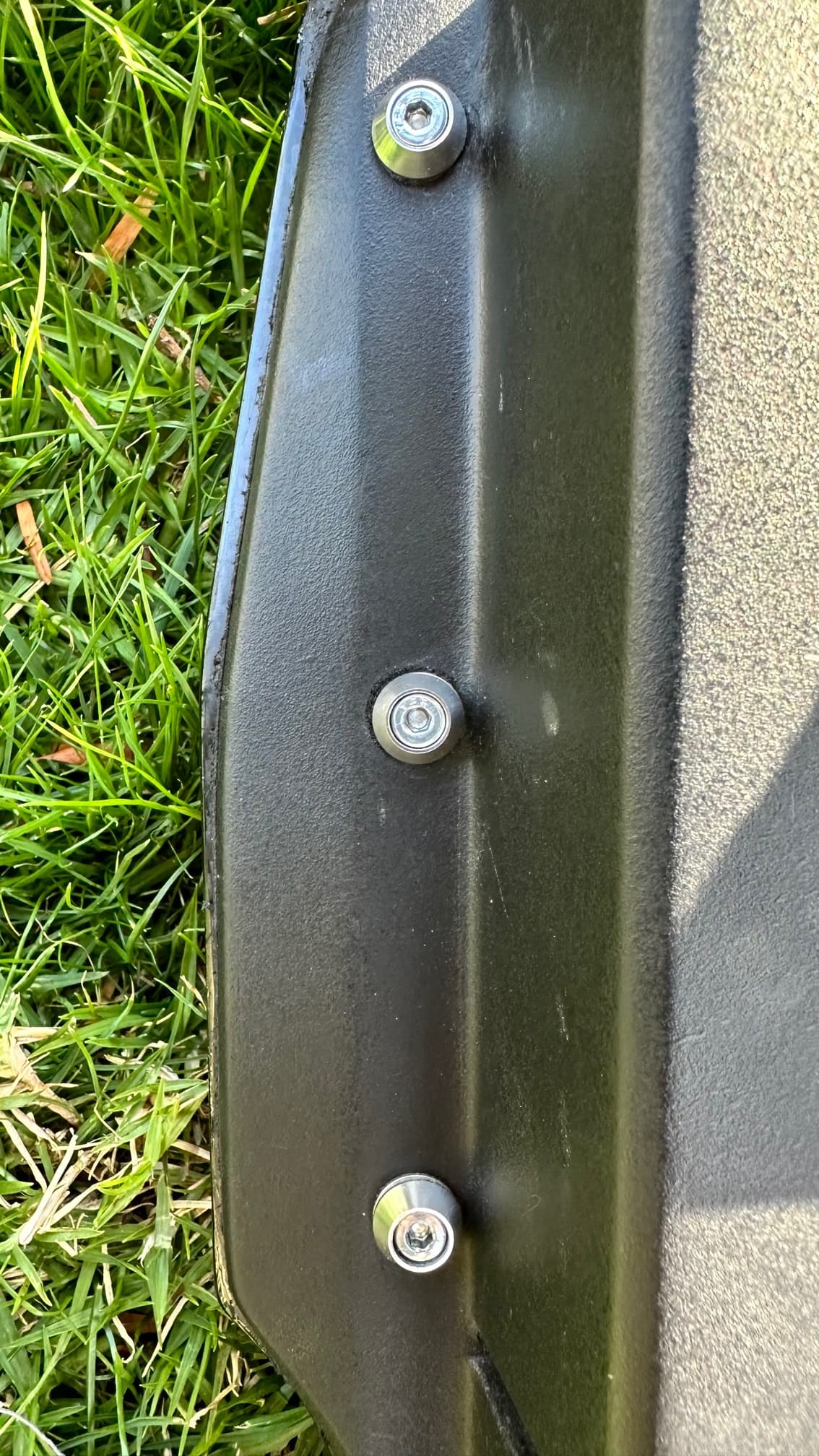

Enclosure hardware:
- silver or black fender washers for aesthetics (Black M4 cone washers 20pcs; https://a.co/d/ikeFON3) (Silver M4 cone washers 15pcs; https://a.co/d/81GjHbr)

Thermals:
- 1/4in. aluminum plate for thermal mass; bolted under vesc with thermal paste (Copper would’ve been a better choice, but is much more expensive)

VHB tape securing the aluminum plate w/vesc to the enclosure (Scotch-Mount Extreme Double-Sided Mounting Tape; https://a.co/d/3FkiG39)
Running v5.2 vesc FW
