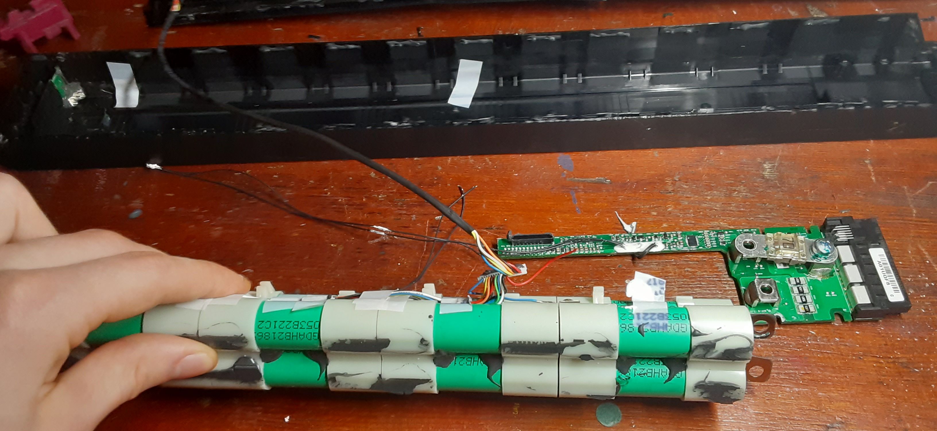

Came apart after a lot of prying, pretty much just need to get it started then use two screwdrivers.
INSTRUCTIONS
These little 4 need hold it in the plastic from the inside, careful with your tools it’s a hot area. Maybe cover up the Terms or the Tool.
I am thinking it about trying to use this plastic case but might end up breaking the two down and making a 12S4P. I mean WTF do I own a kWeld for anyways.

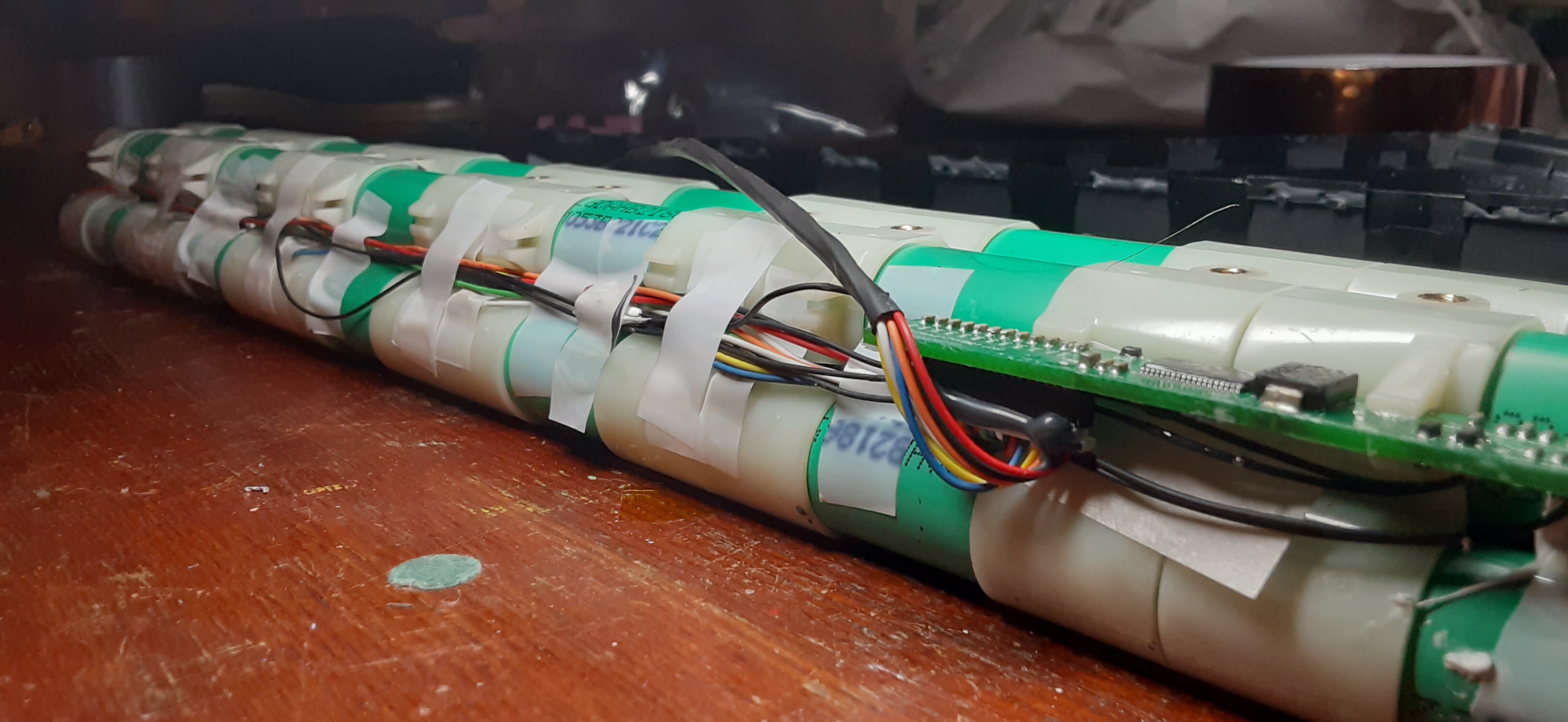

Getting thisthis light in a pic took 25 tries
Ok rip the connector out the led thing or just cut those wires off the balance connector. Be careful I ripped that red balance wire off due to unplugging it and removing the PCB before tugging on the other end. Could probably reuse their balance wires but they aren’t the prettiest things so idk.
Here you can see all 13 series/connections needed to attach BMS. the tab for the bottom isn’t visible
Probably best to remove the old ones and use their tabs
