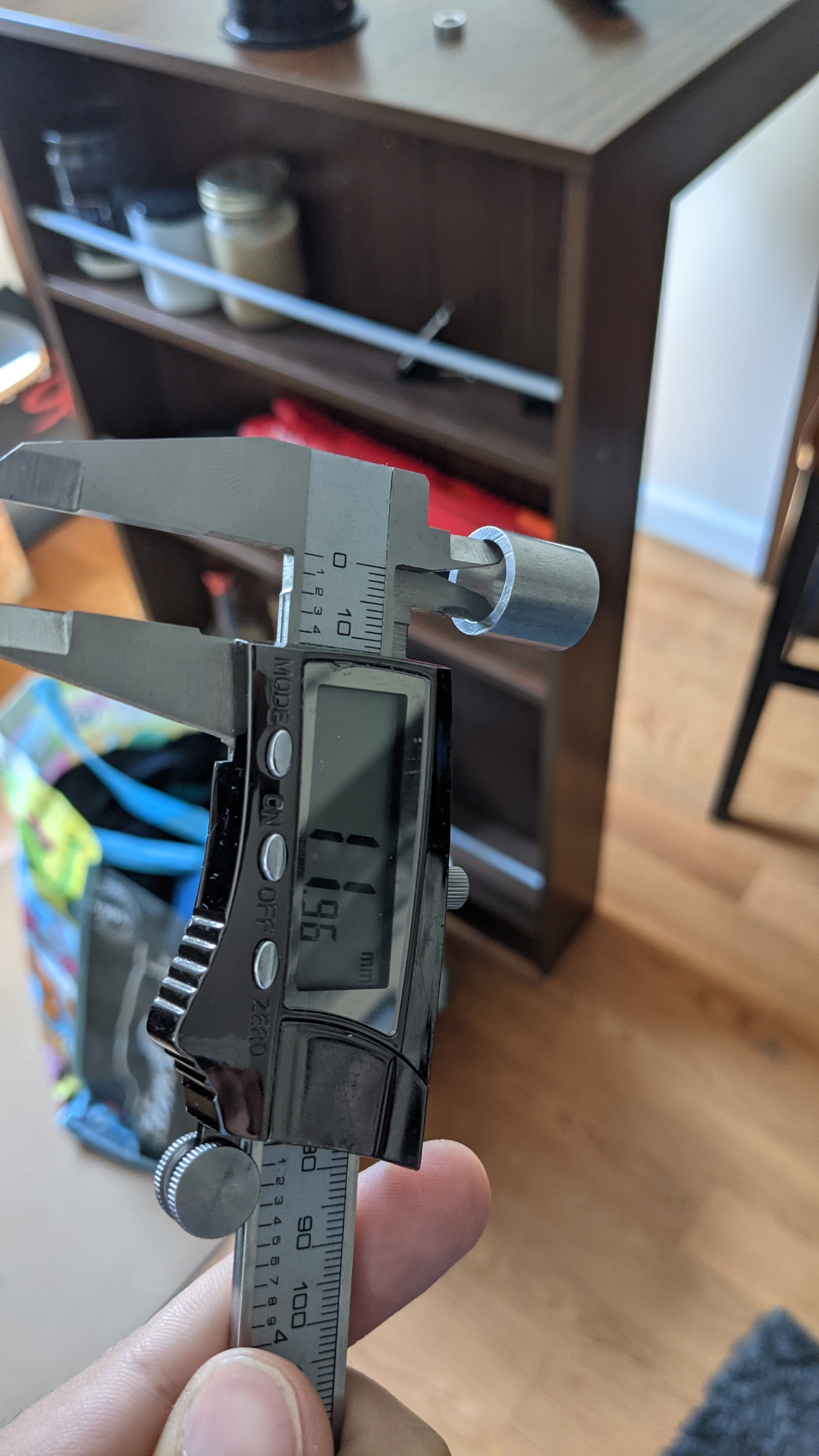

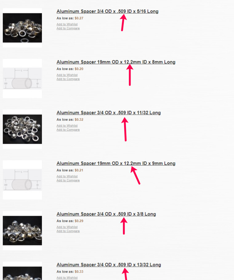

12mm (NOT .506" , NOT 12.2mm, NOT 1/2") aluminum spacers
Please show me where I can buy this in the USA. I really don’t think I should have to pay $1.26 each for these from Trampa.

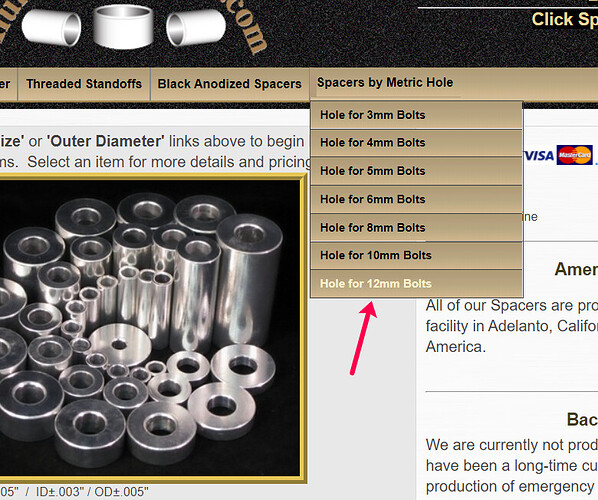

What about aluminumspacers.com

FFS… 0.2mm is .007874in… Less than 8mil. That IS the proper size for a slip-fit spacer. If you indeed managed to find 12.0mm ID spacers, you’d be installing and removing them with heat, a slide hammer, or both. I ordered the 12.2mm ID spacers from Aluminumspacers.com last summer, have put more than 1k miles on the set without issue on Matrix II trucks.
Trampa axles are slightly less than 12mm…

I ordered 22.2 length, 12.2mm ID (??? OD… who cares, so long as it’s not rubbing on the bearing seals) for MBS rockstar/fivestar. You think $1.26 is bad, try $25 for 4 of 'em from Lacroix. They were something like $12 for the set from aluminumspacers.com Trampa use different spacing between bearings? If so, you’ll need a different length… Or, just PAY TRAMPA $1.26 each… cheaper than any other option.

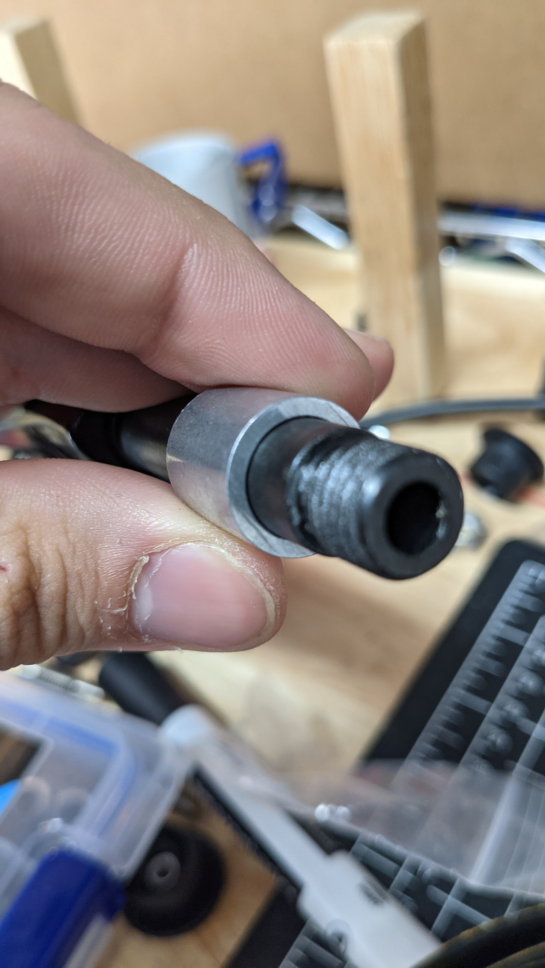

What’s slightly less than 12mm? 7/16in. I think MBS uses 7/16 thread (5/8 ~ 16mm wrench) nuts, and the OD of the threads is definitely less than 12mm. My rear hubs are pushed out as far as they go, meaning that the outer bearing is riding on said threads, not the smooth M12 shaft, so my rear wheels are a tad loose. You’re not going to solve this problem with tighter-fitting spacers. The only remedies would be longer axles (where the proper M12 shaft supports the outer bearing,) or using a larger ID bearing (15mm) and a custom-made nut that’s M15 OD (save wrench flats) engages the inner race of the outer bearing.

If you show me a photo of how close the fit is I will shut up and admit I am wrong.

I can confirm the “12 mm diameter” work great on matrix 2 axles. 12.2mm is a great fit as @emaxon is saying.

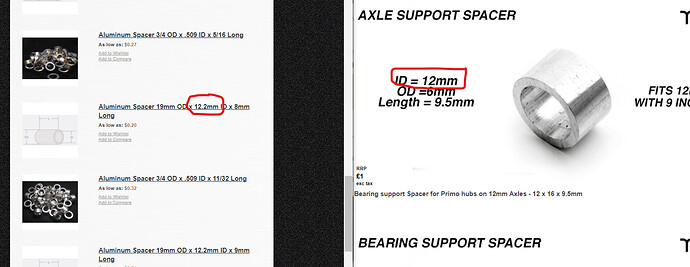

r u sure trampa’s spacer isn’t 12.2mm also?
Trampas spacer is in the pic above. But I do think 12.2 will be fine and that I overreacted
yea i know what u mean, but r they really 12mm ID if 12mm is practically rare as unicorn…
also, ID 12mm OD 6mm, nice going Trampa, another impossible dimension
