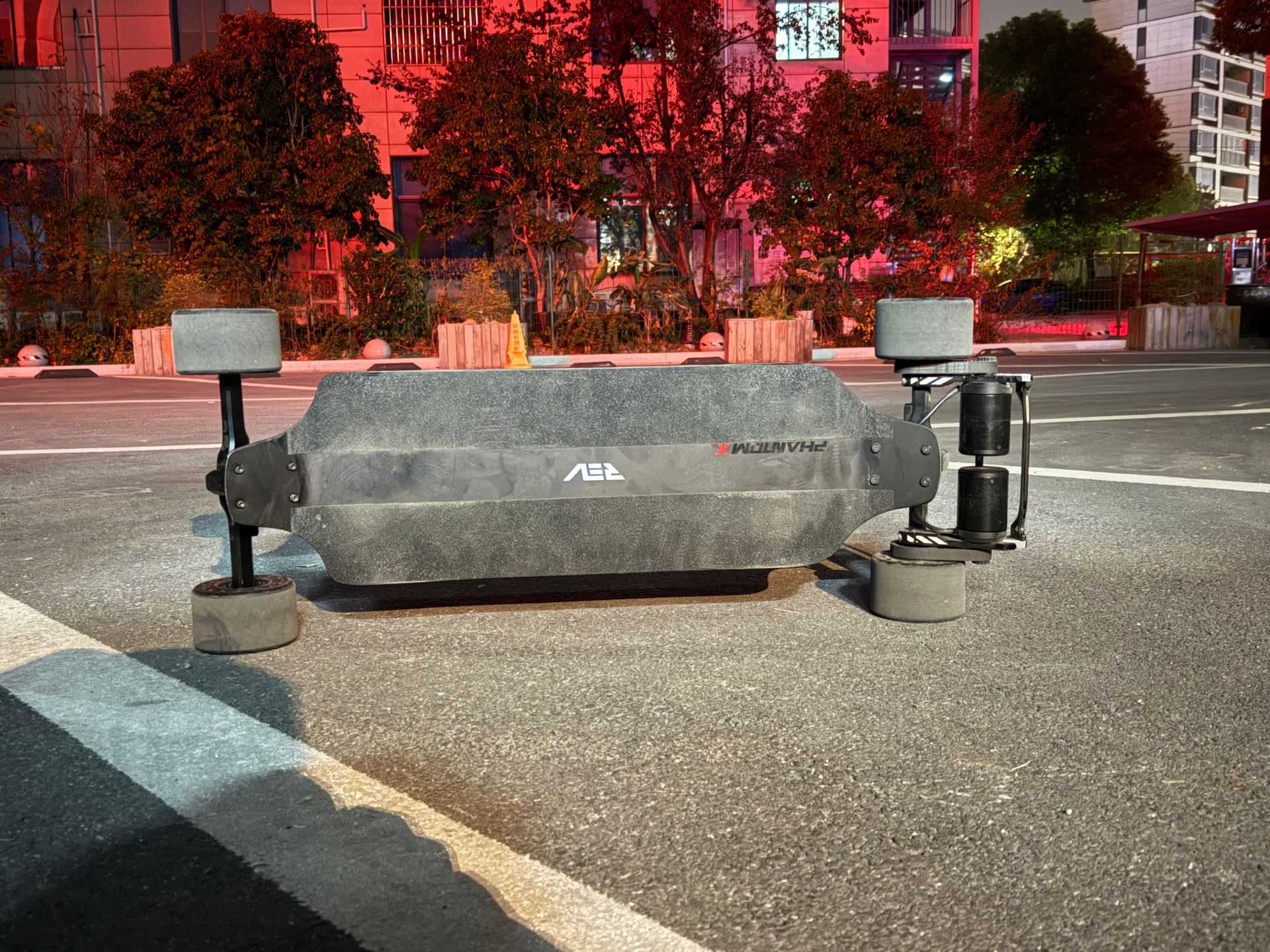

12kw beast designed by Revskateboard
blasting on this thing

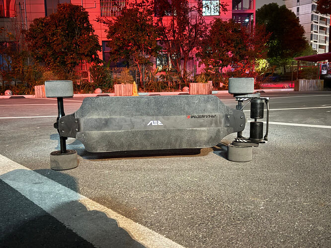

When can I buy whatever it is that lets you mount motors to the front like in this photo?
it was hand made by myself…for testing. but AWD on this thing is weird, very unstable, unpredictable control
How do the brakes feel? Stronger? Or does it wanna spin
break is strong for sure, but the dragging force on the front will spin your steering wheel also, if you only going straight it feels fine, but any tiny movement during accelerating…the front motor kind fight your steering.
@tuckjohn we need your tits

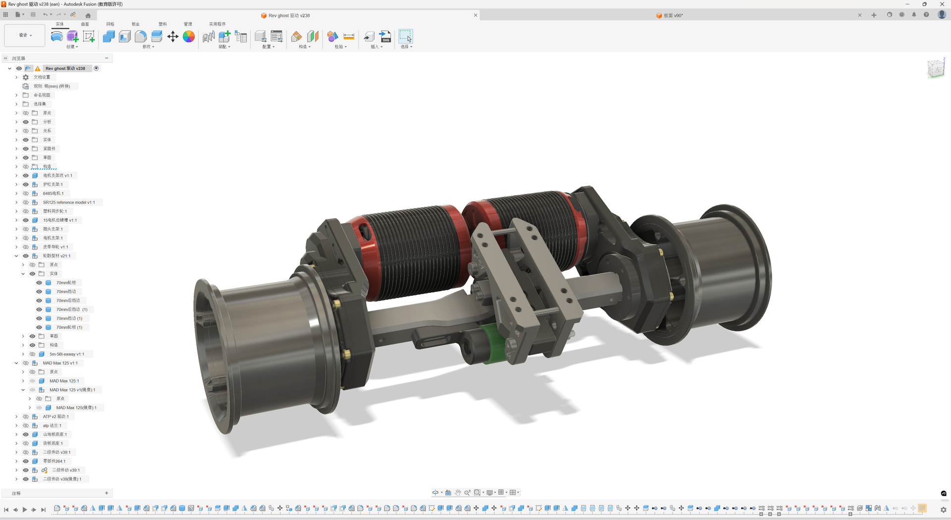

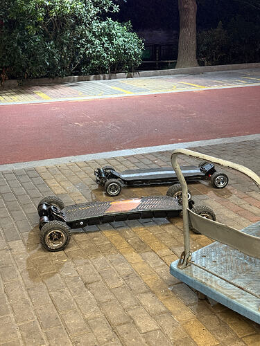

some updates, redesigned the truck system, trying different type of maple combination on the deck.
How wide are these trucks compared to the set on the Phantom?
Phantom truck full length around 450mm. this one is around 382mm
Is the Ghost series “waterproof”? I remembered seeing something like that mentioned on your home page.
Would depend which levels, even tho the ghost will use sealed ESC and BMS. But I don’t recommend play in rain condition
