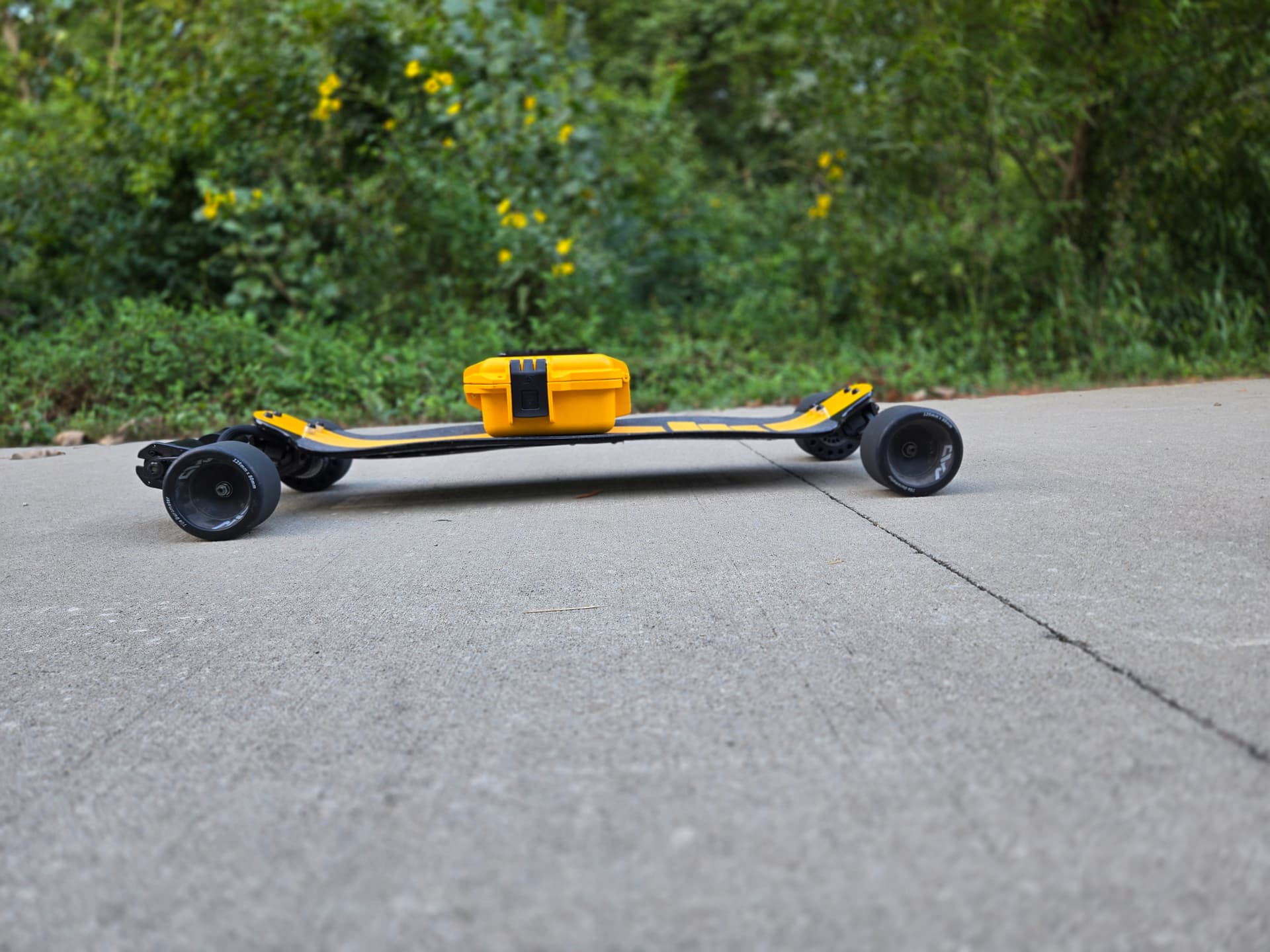

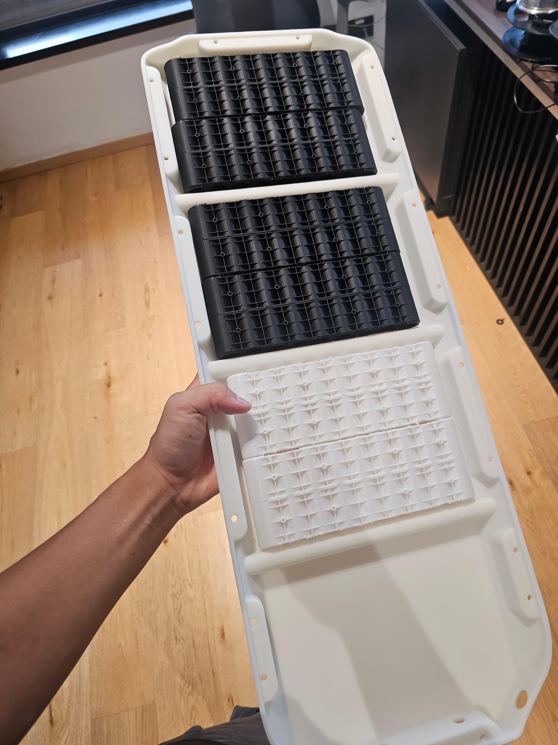

12kw beast designed by Revskateboard
Yep, 18s3p
Super sexy.
I love riding my set up with a similar deck and 125 wheels.

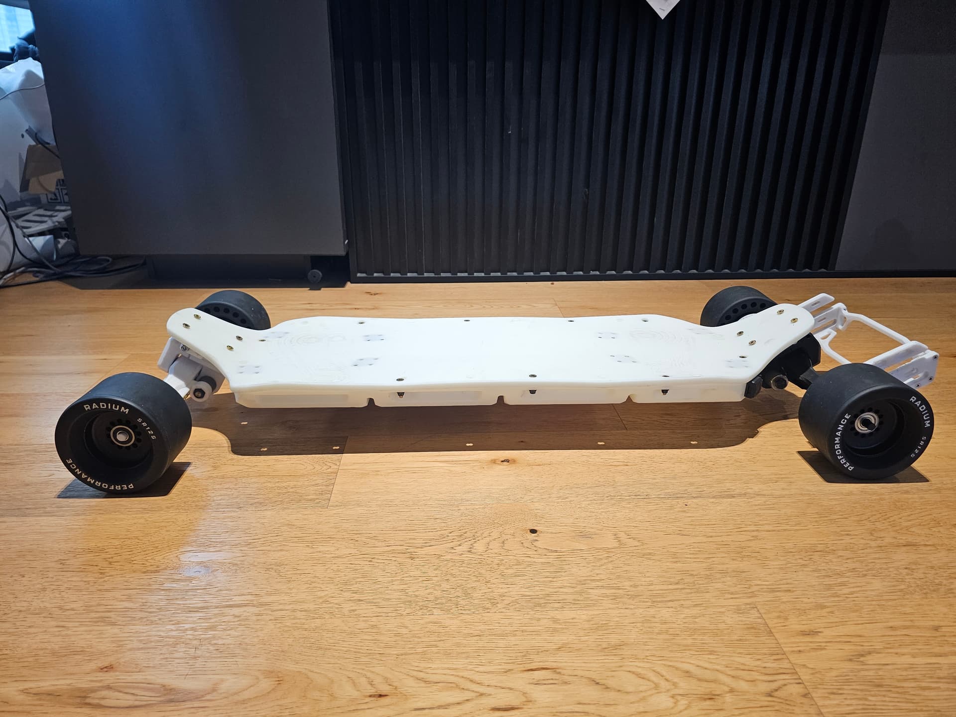

What is the length of this deck?
This was posted in the beginning of the thread. Not sure if it’s changed since then.
New model is 860mm deck length

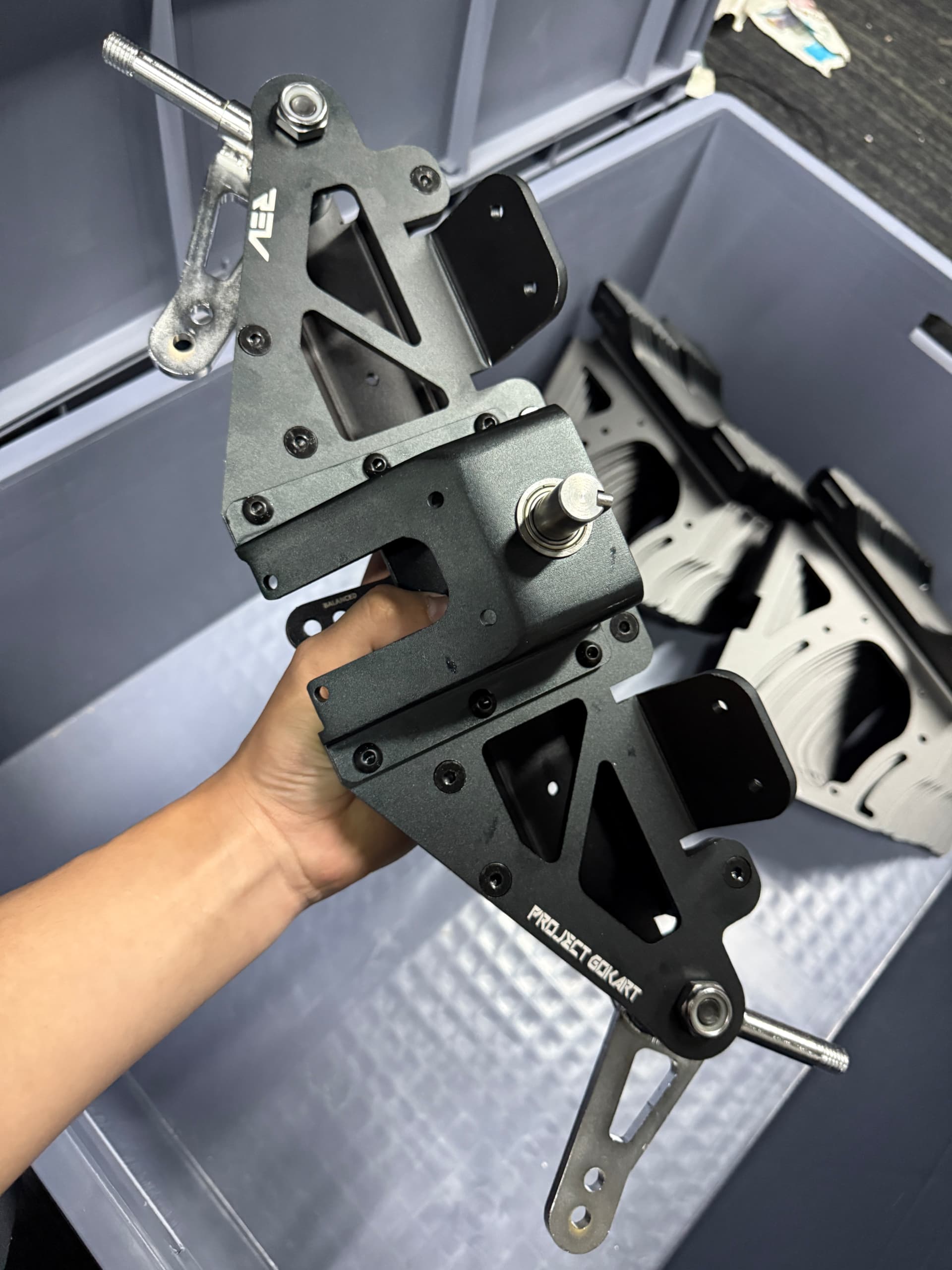

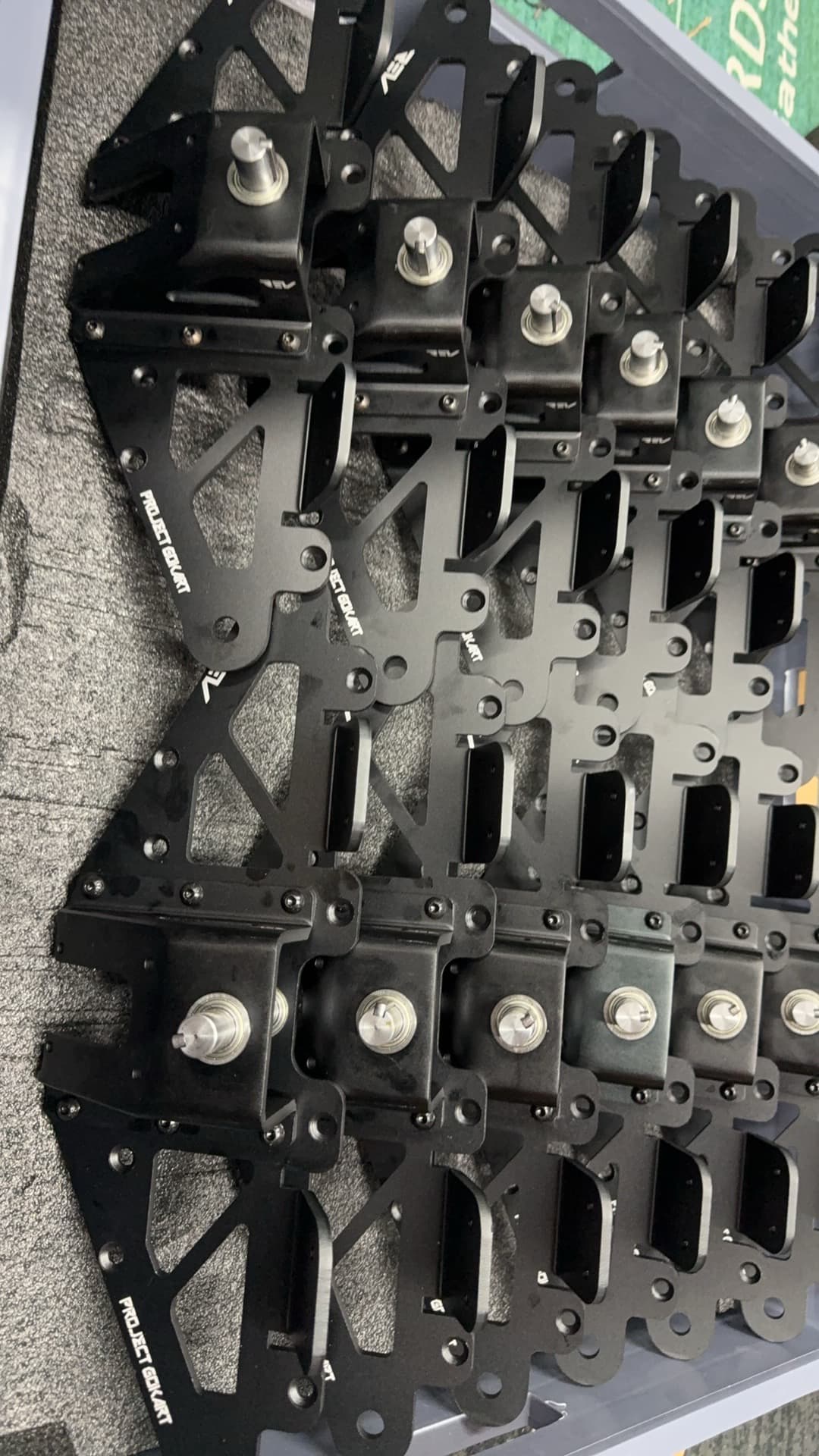

Gokart mod available soon.

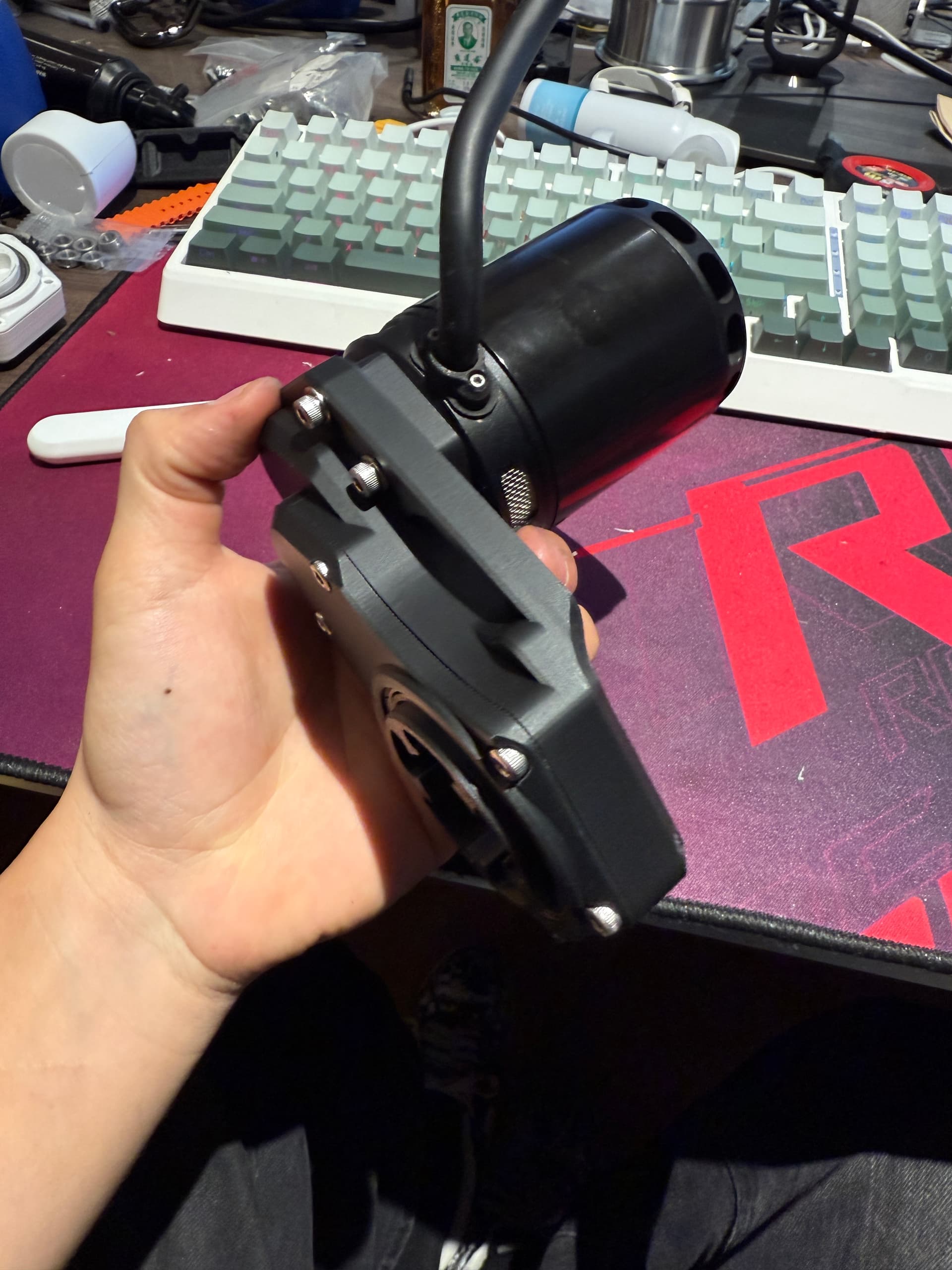

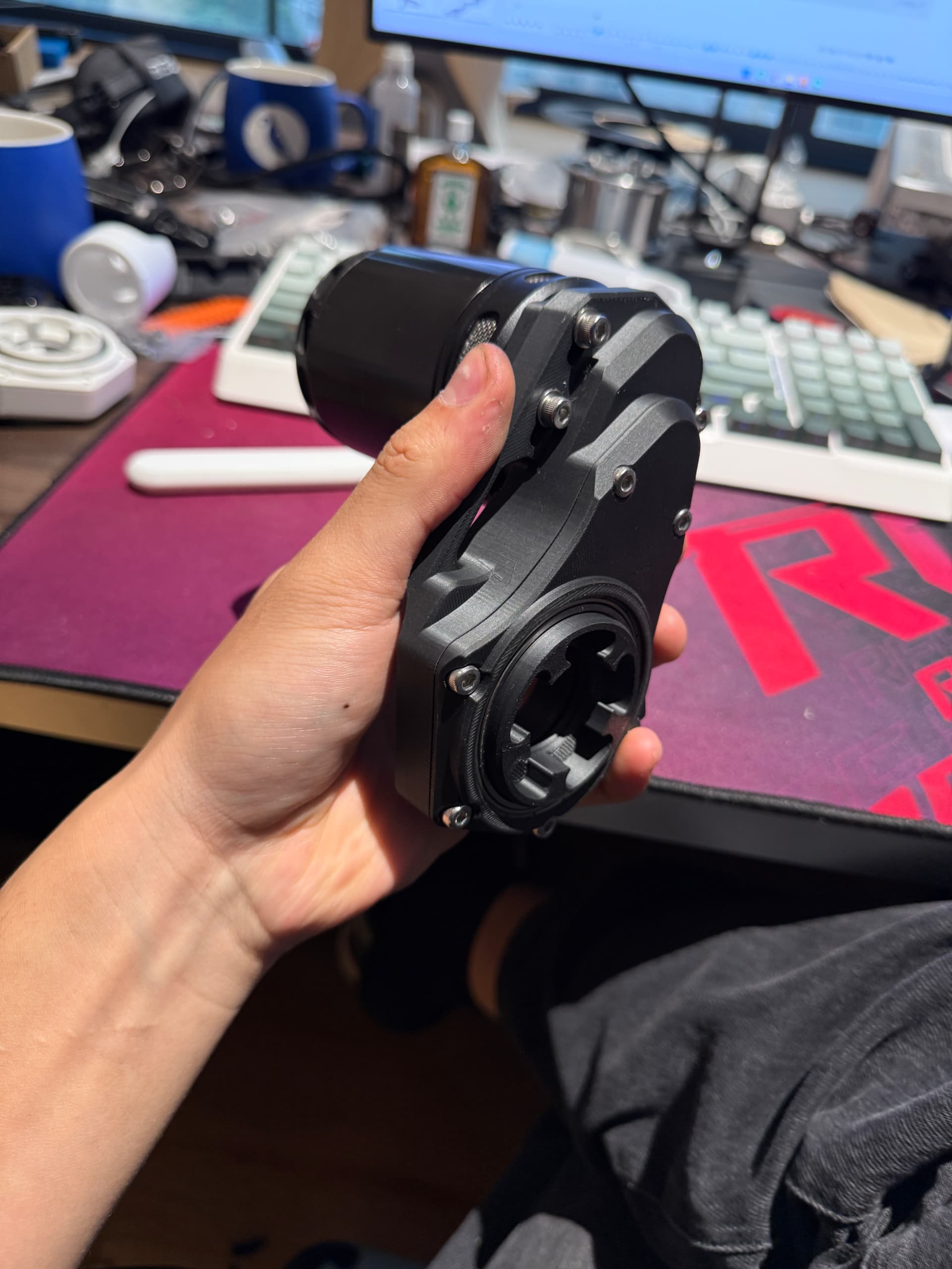

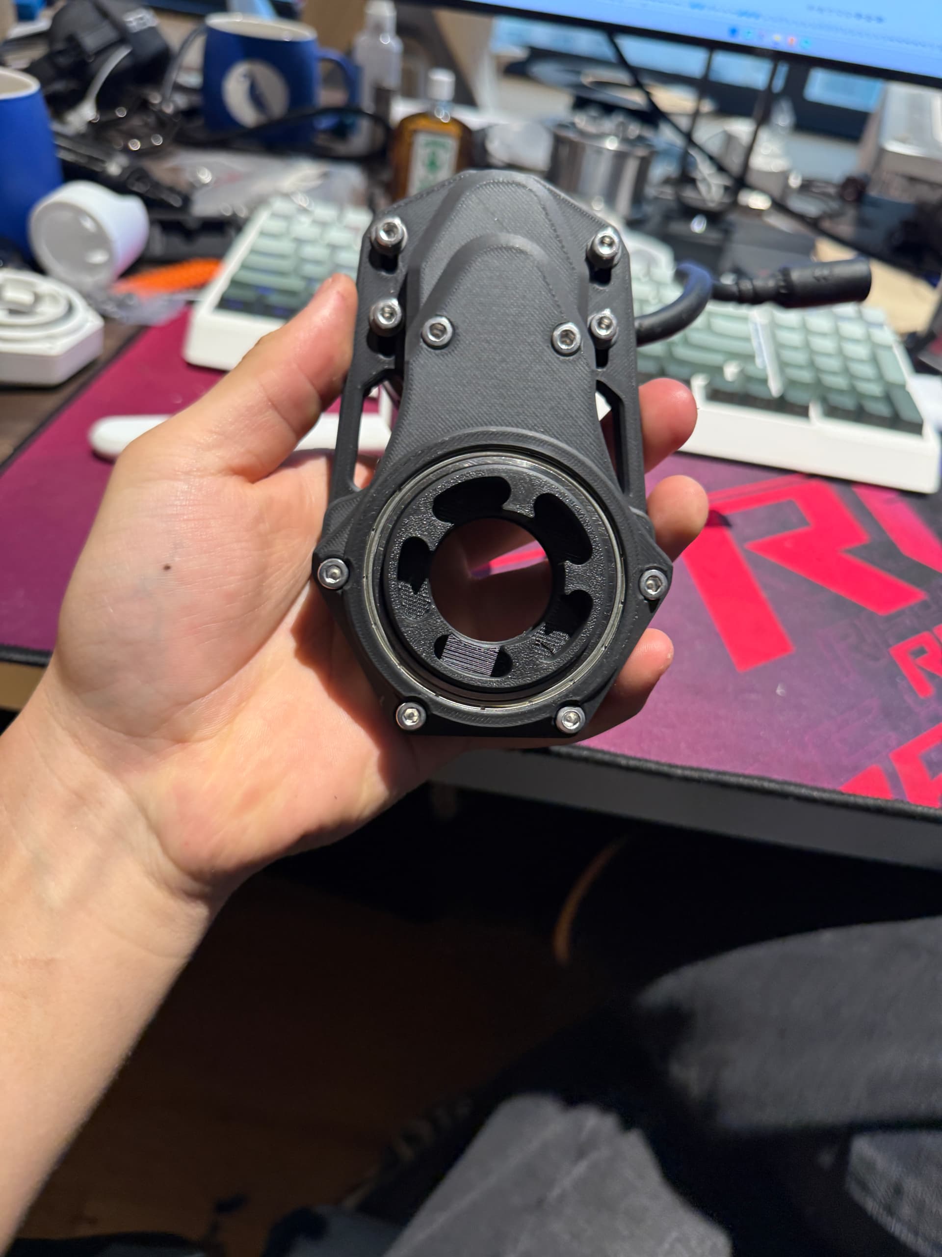

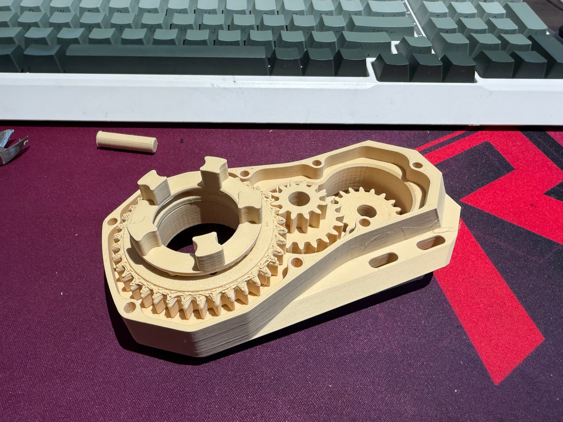

two stage gear drive working on progress

What is the gear ratio?
What truck mounting options will it have? And is it for pneumatic or urethane?
This is definitely my dream board! You have created the hypercar of esk8​:skateboard::battery::rocket::double_exclamation_mark:
3.0/3.8/5.6 optional
It share the same clamp 4gs using, so 22*22 files profile, matrix 3 etc…It fit both
Will the gears be POM or metal?
Will there be any slave gears like the previous drive?
When will they go on sale?) :-)))))))
gear full steel,even the slave gear
