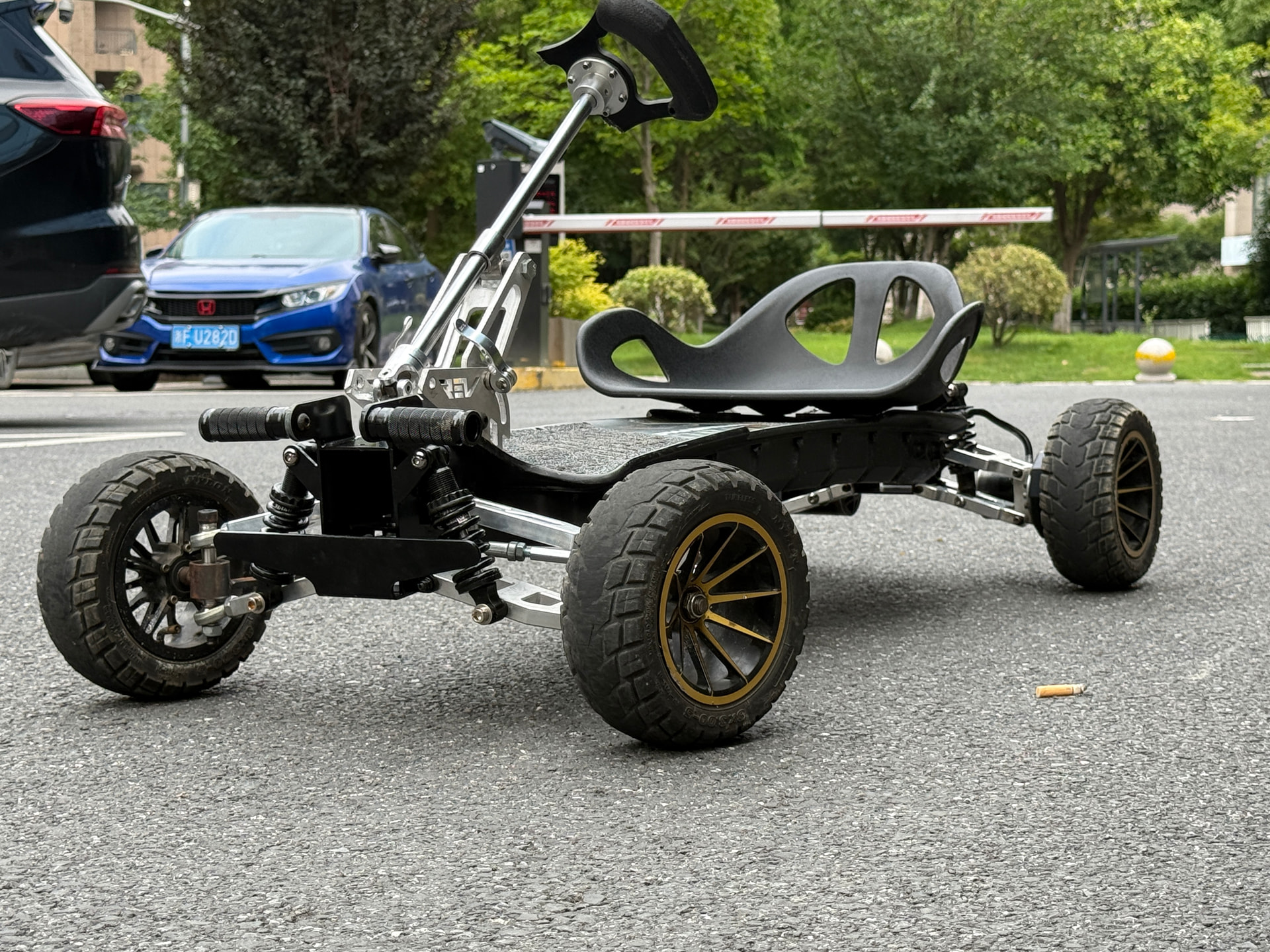

I bet, this board is 21s 160kv motor, speed is reaching to 90km/h top speed ![]()
I strapped kit to a board and went down a hill at like 15 and I was scared shitless

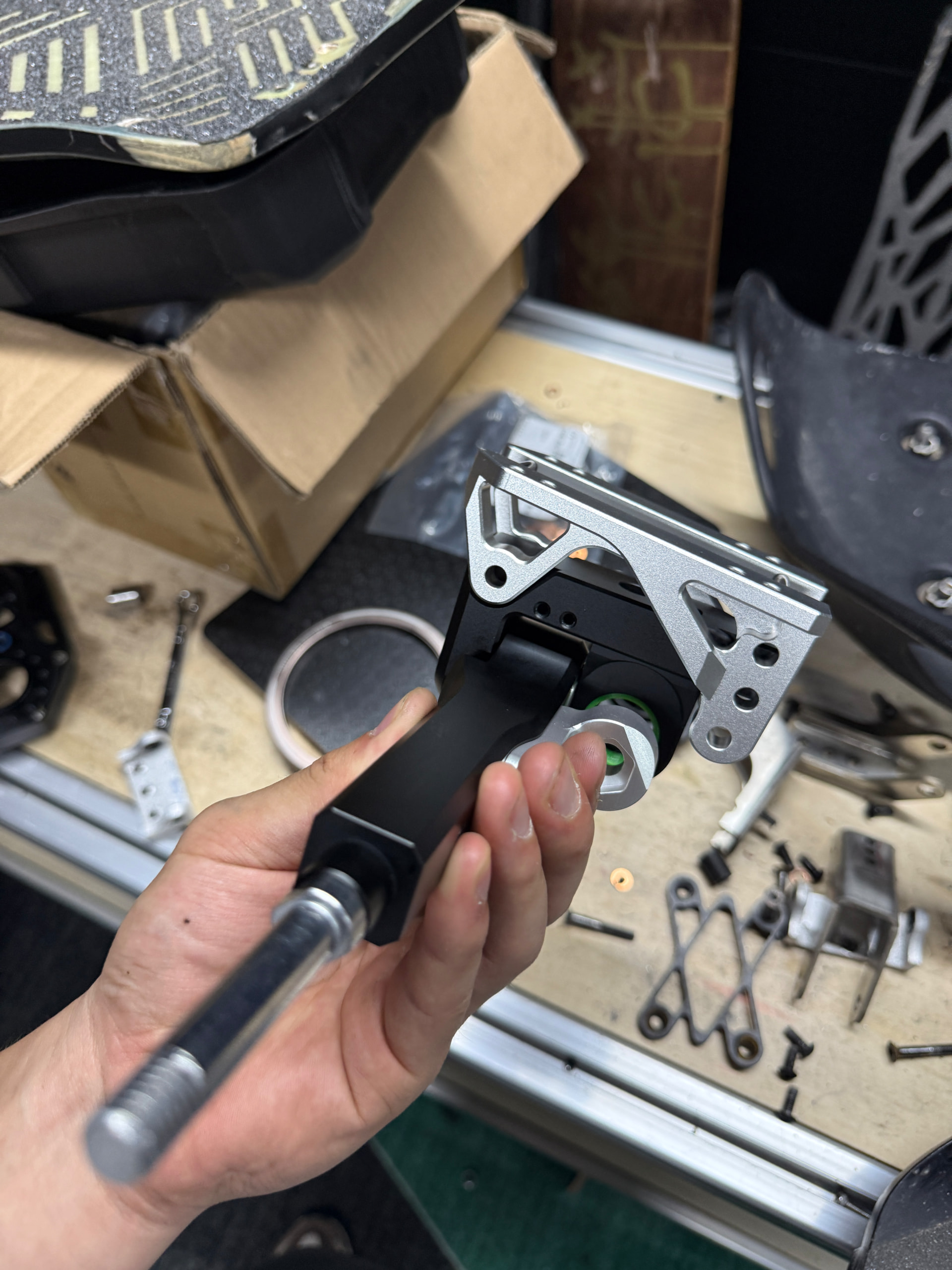

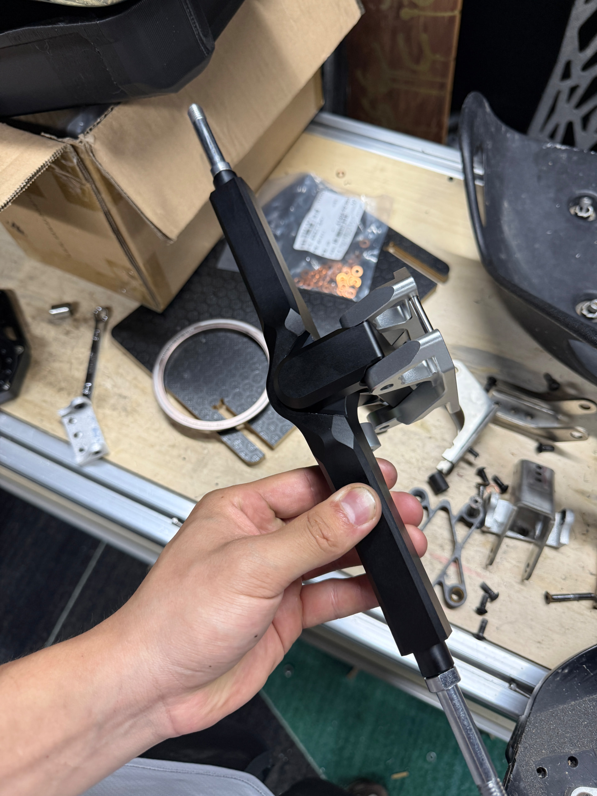

adjust the rods, make you wheel straight will improve the stability, add a 5 degree angle pad also help. I did a lot of improvement on the suspension kit to make it drive like real UTV and stability
after improved the dual gear combination, the two stage gear drive is durable af right now.
Lemme test with 13 inch (330mm) tires

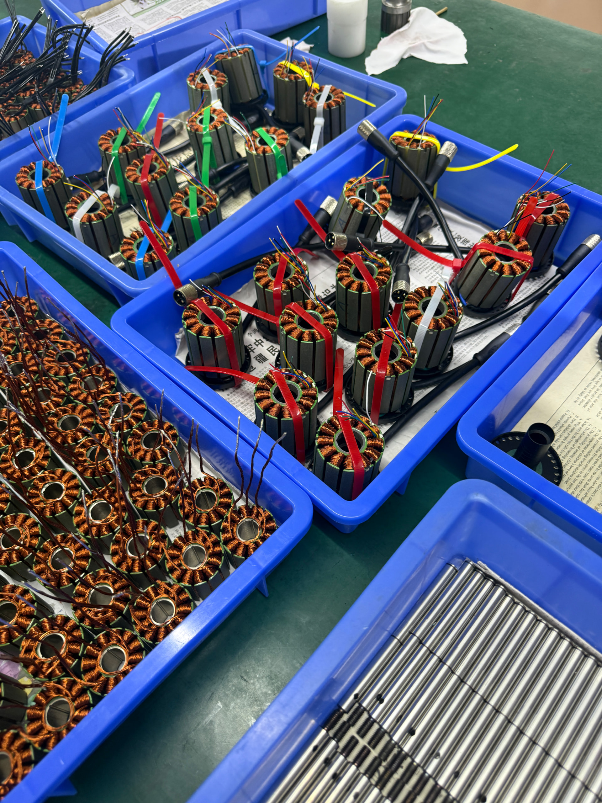

That’s really unique!!! Very good, Ethan! So, are these for the Rev Newbee board or for Dry? I’m asking because it has a dedicated connector for a specific ESC.
What can these motors handle as for Phase amps / brake current. And would these possibly be available to consumers for VESC? I’d be highly interested in a set of 190kv
Are those Exway/MBS style connectors??
It is the new motor for the rev, it will be offer to diy as well, I have other side of esc cable with 4mm bullet connector.
Sort of, but handling more current
we will have the 130kv and 160kv, it will be ready for diy too, we will offer esc side of cable. for me what we have tested each motor could go up to 8000w, motor is using 45uh magenet, and better sensor compare to reacher
