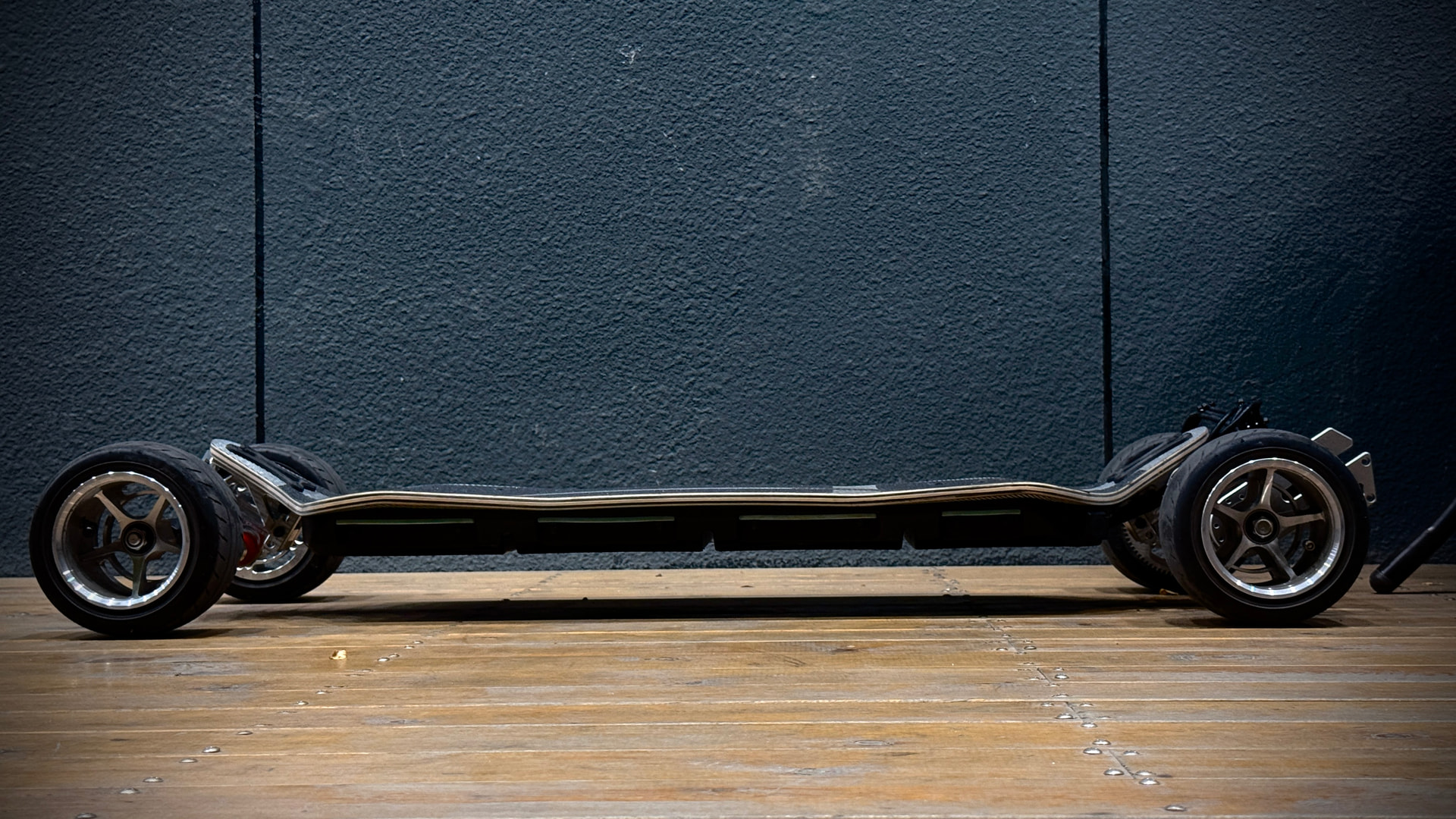

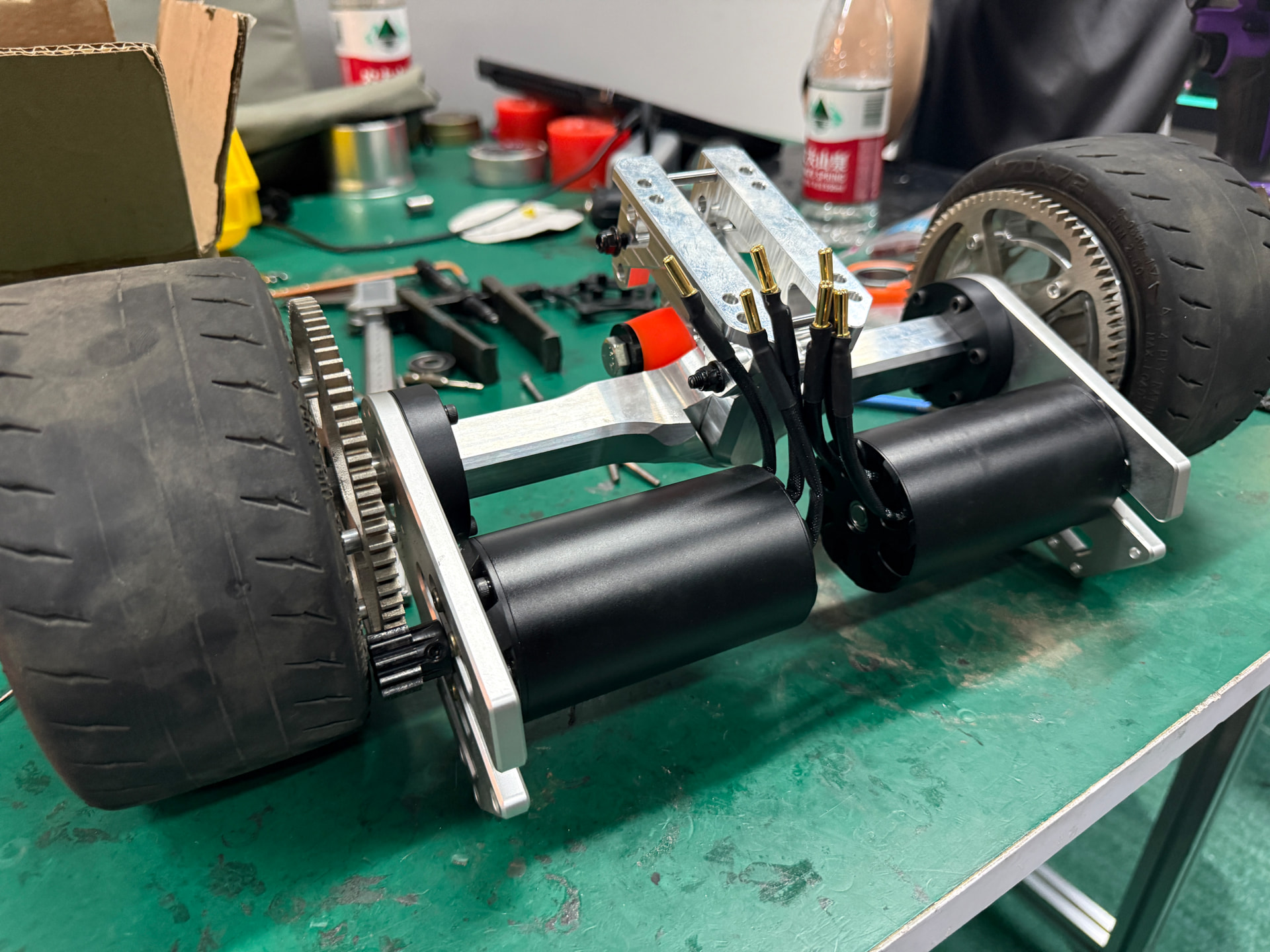

12kw beast designed by Revskateboard

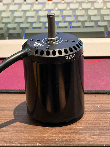

made the motor size 6485 finally…peak torque 8.7nm
Wow they’re pretty​:skateboard::battery::rocket::double_exclamation_mark:

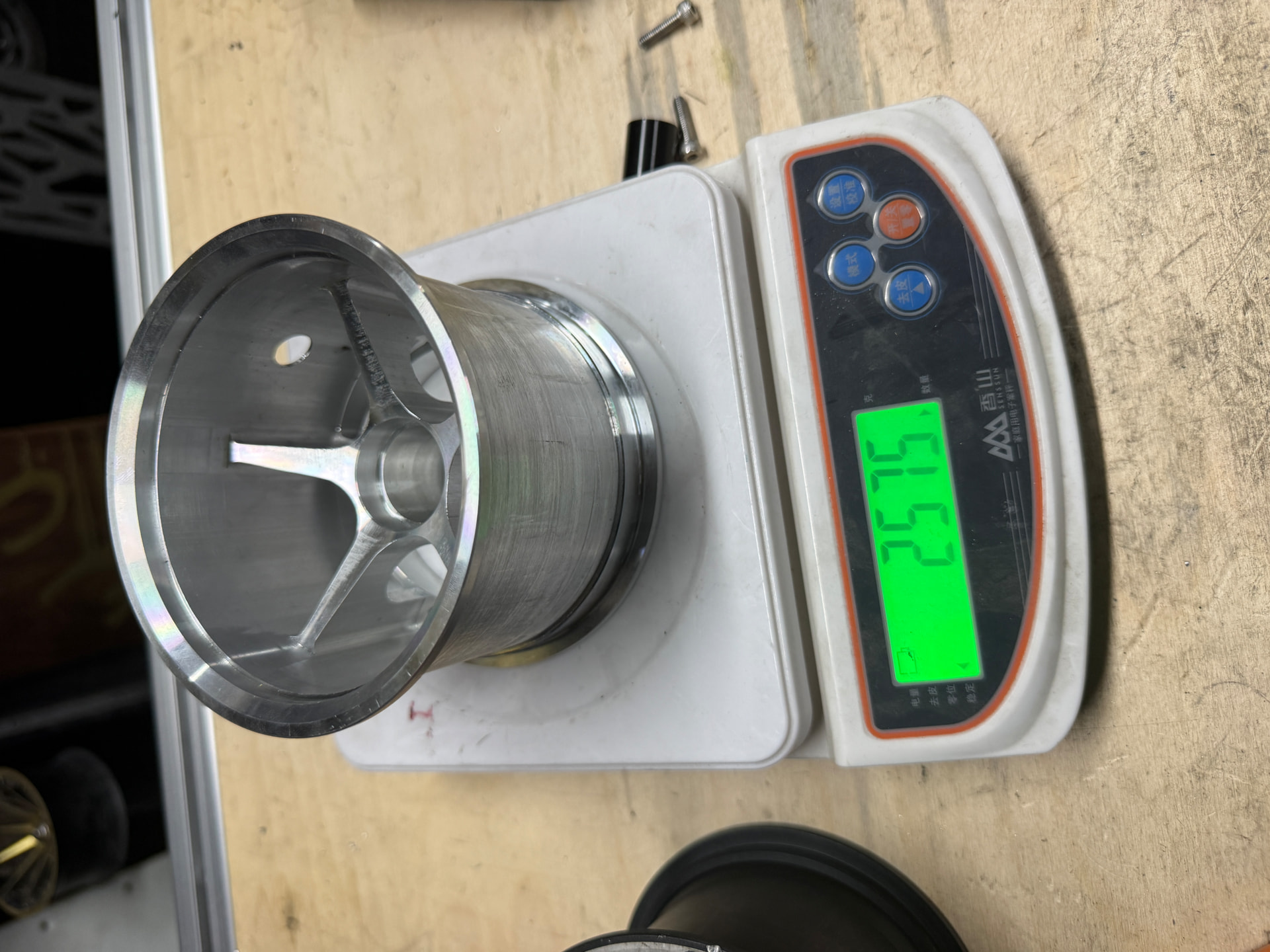

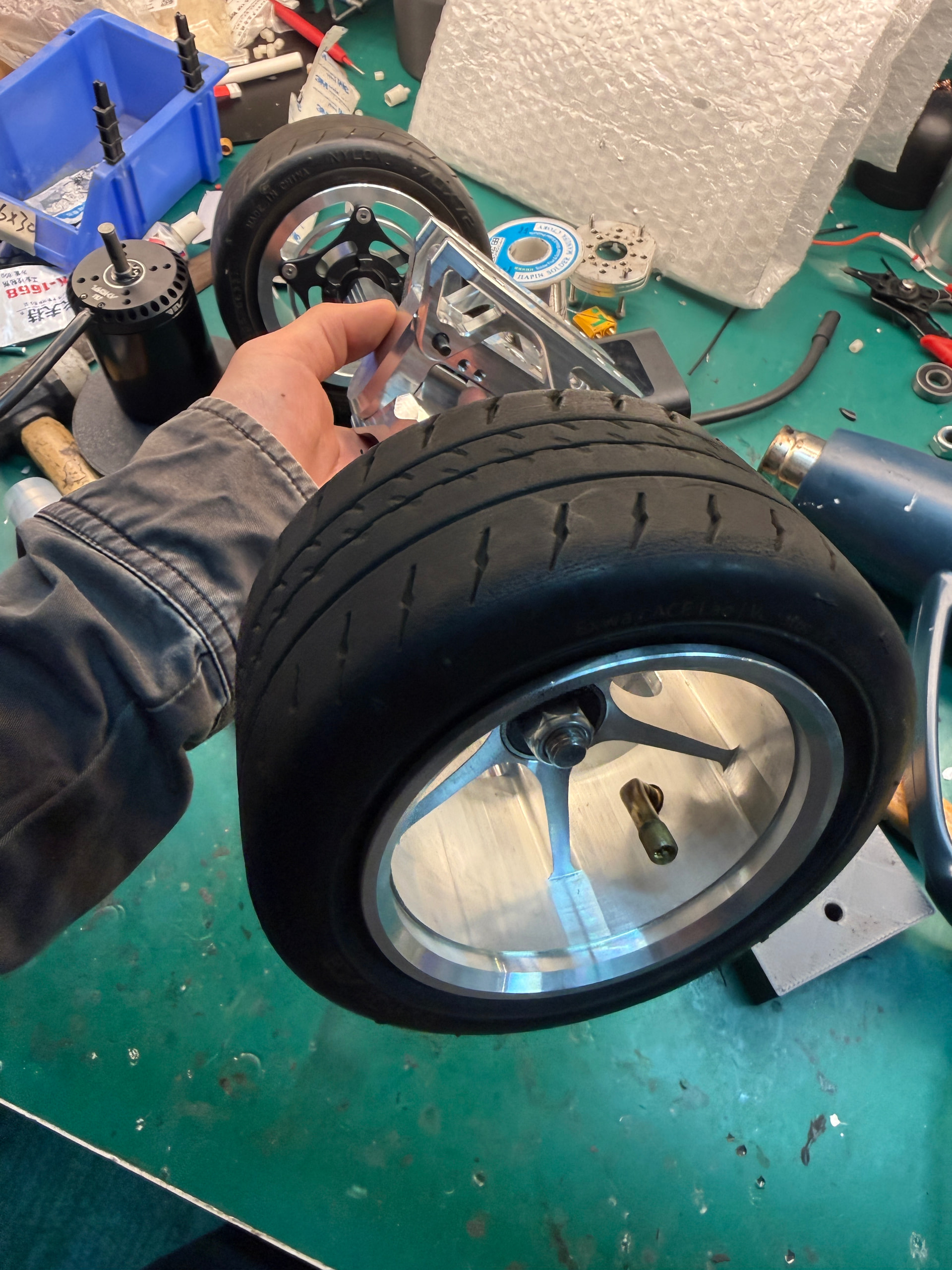

When will these rims be available for purchase? Compatible with both gear drive and belt drive?
Wow Ethan, you’re a genius, man! Congratulations!

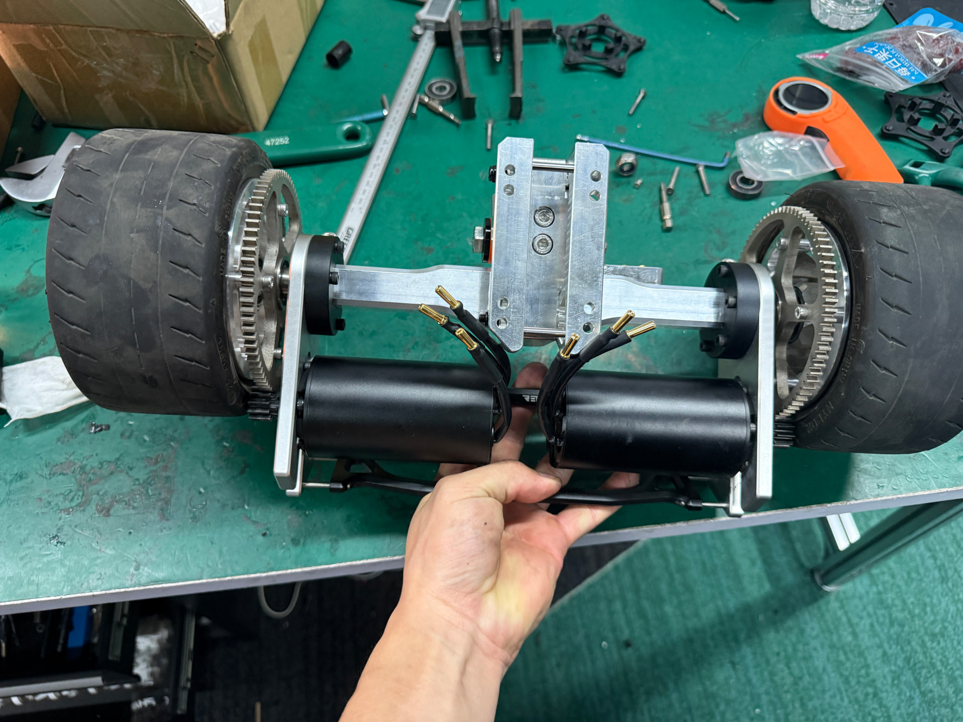

with two 56104 motor

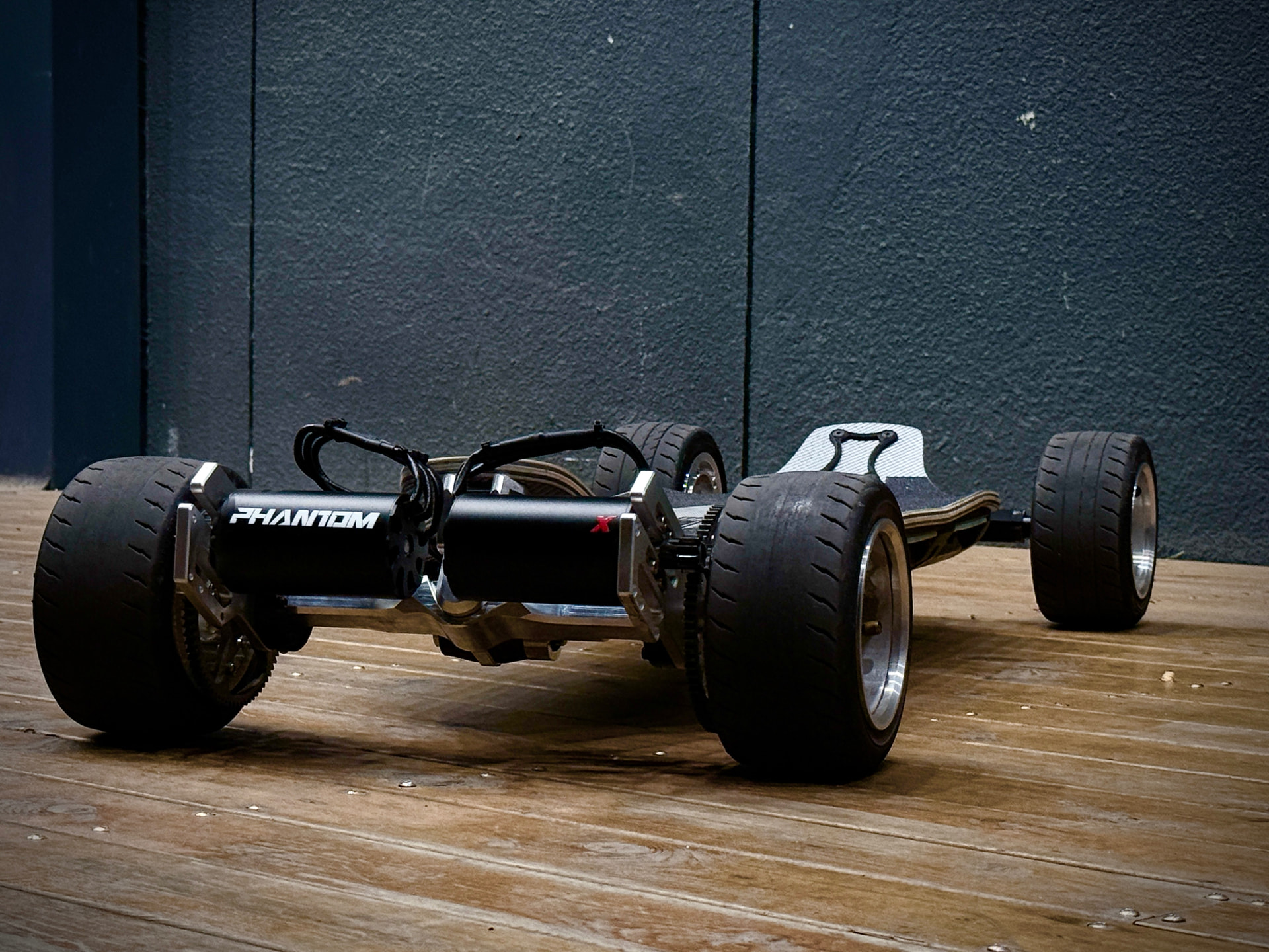

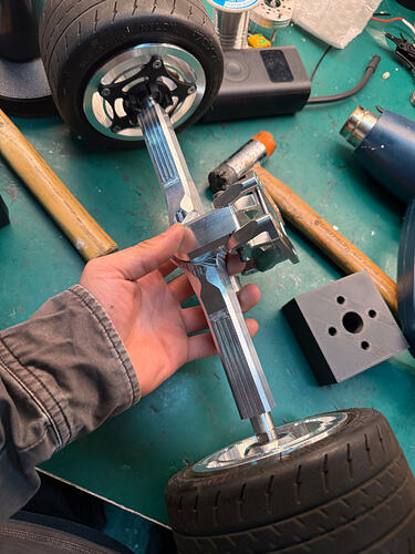

Are there any plans to release trucks with hydraulic suspension? And I’m also curious about the newly designed gear drive u’re working on. Thx.
two stage gear drive will be ready June 15th, suspensions truck is under testing.
That’s great news. I’m especially curious about the suspension truck. I think it would be awesome if it could be released as a kit compatible with existing trucks from other brands, but would that be too difficult?
Videos suggest that it’s a special deck design as well. He can speak to it more but I don’t think it’s feasible for a lot of decks out there.
I didn’t notice that part. Looking at the photo again, I can see that the top part of the deck is cut off.
but as longer I provide the drawing of of the mounting, people could manual their own deck

I think these motors are rated for up to 45000 rpm, what rpm / kv are you running?

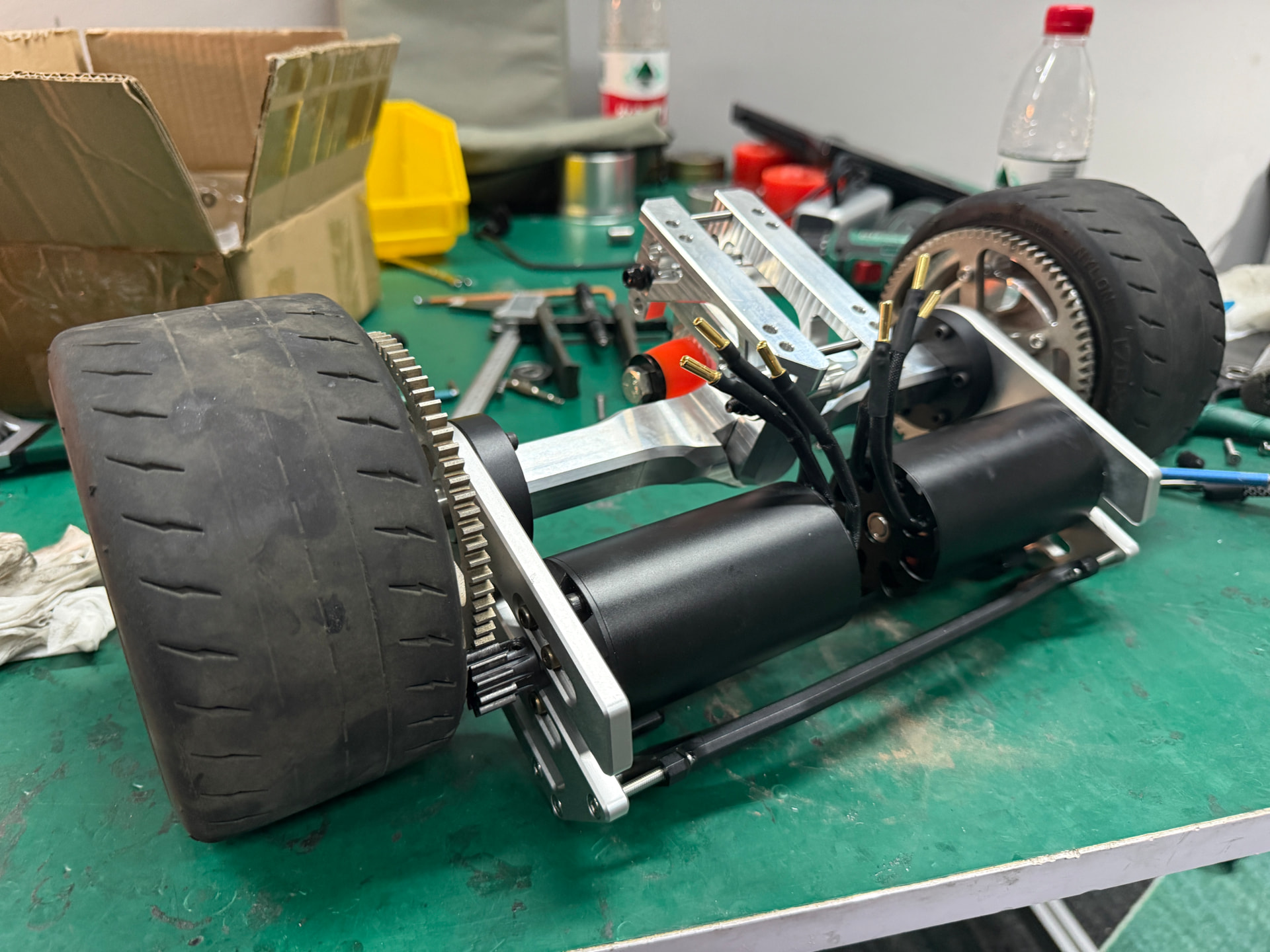

What’s the ratio on the 2 stage?
18s 360kv
available in 12/68 18/68 and 22/68
