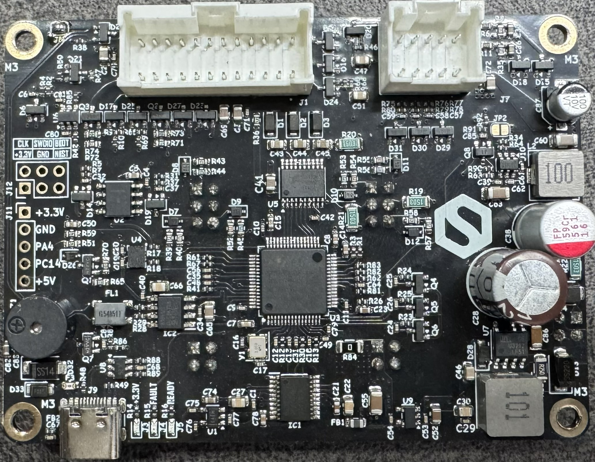

Here I am sharing some internal board photos. Wanted to share the hardware and showcase about filtering, layout, and build quality.

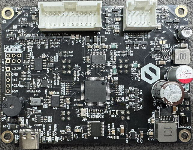

Control board overview:
This is the top side of the control board. MCU in the centre, power supply chain on the right (you can see the bulk electrolytics for the 12V and 5V rails), signal conditioning and communication interfaces spread across the board. USB-C on the bottom left for direct VESC Tool connection. The six-pin header on the top left is SWD for firmware development — yes, we flash and debug our own firmware directly, not just loading someone else’s binary.
Two connectors along the top — 24-pin main connector (throttle, CAN, UART, AUX, modes, switches) and 10-pin sensor connector (hall, SIN/COS, motor temp). Everything breaks out to these two connectors, no loose wires hanging off the board.

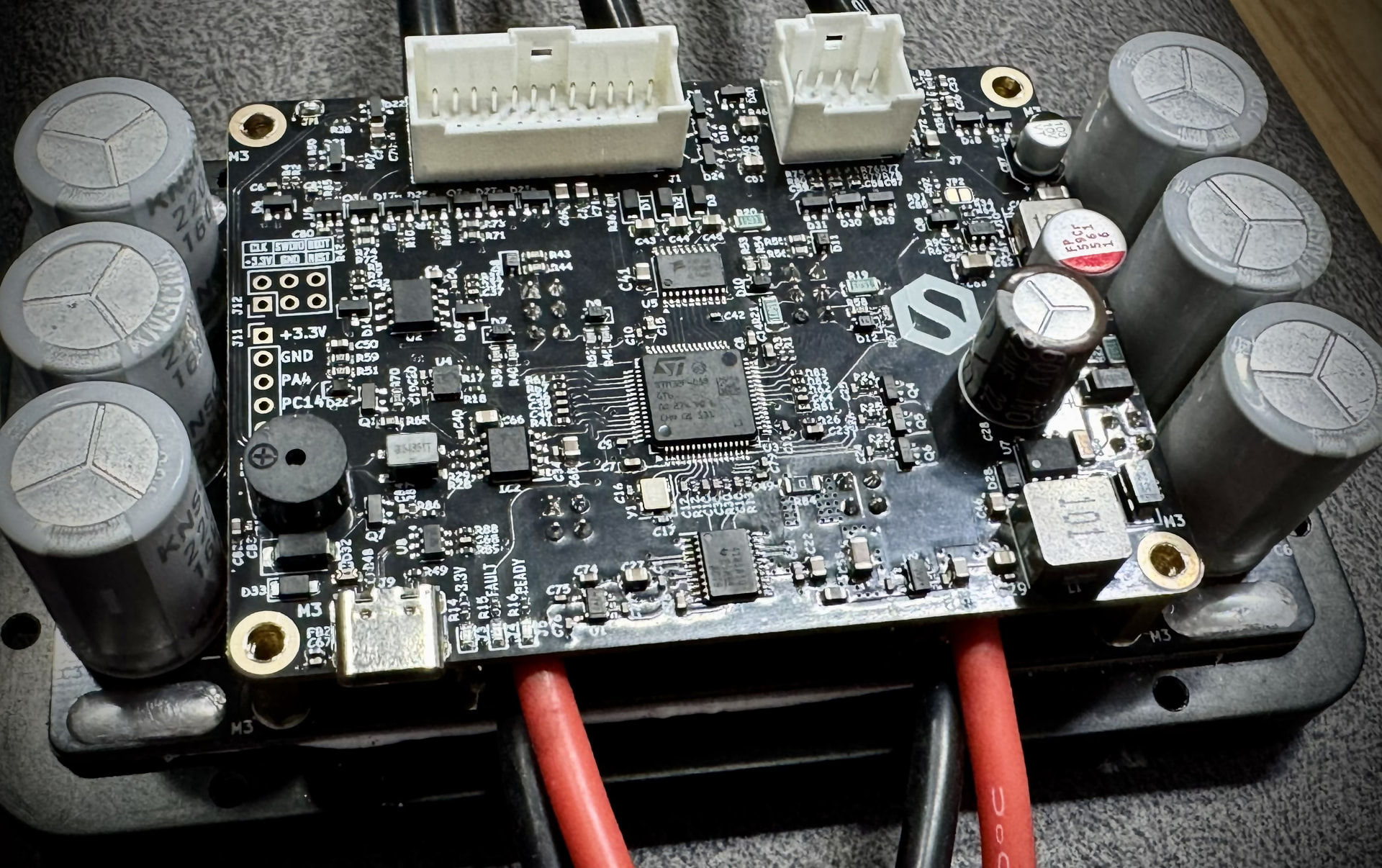

Full assembly — control board on power stage:
This is how it comes together. The control board sits above the power stage. The six large cylindrical caps around the perimeter are the bulk DC bus electrolytics — energy storage for load transients. Phase wires (black, 8AWG) and battery wires (black & red 12AWG x2) come off the power stage below. The aluminium baseplate underneath the power board is the thermal interface — MOSFETs dump heat directly through the aluminium-core PCB into whatever heatsink or chassis you mount it to.

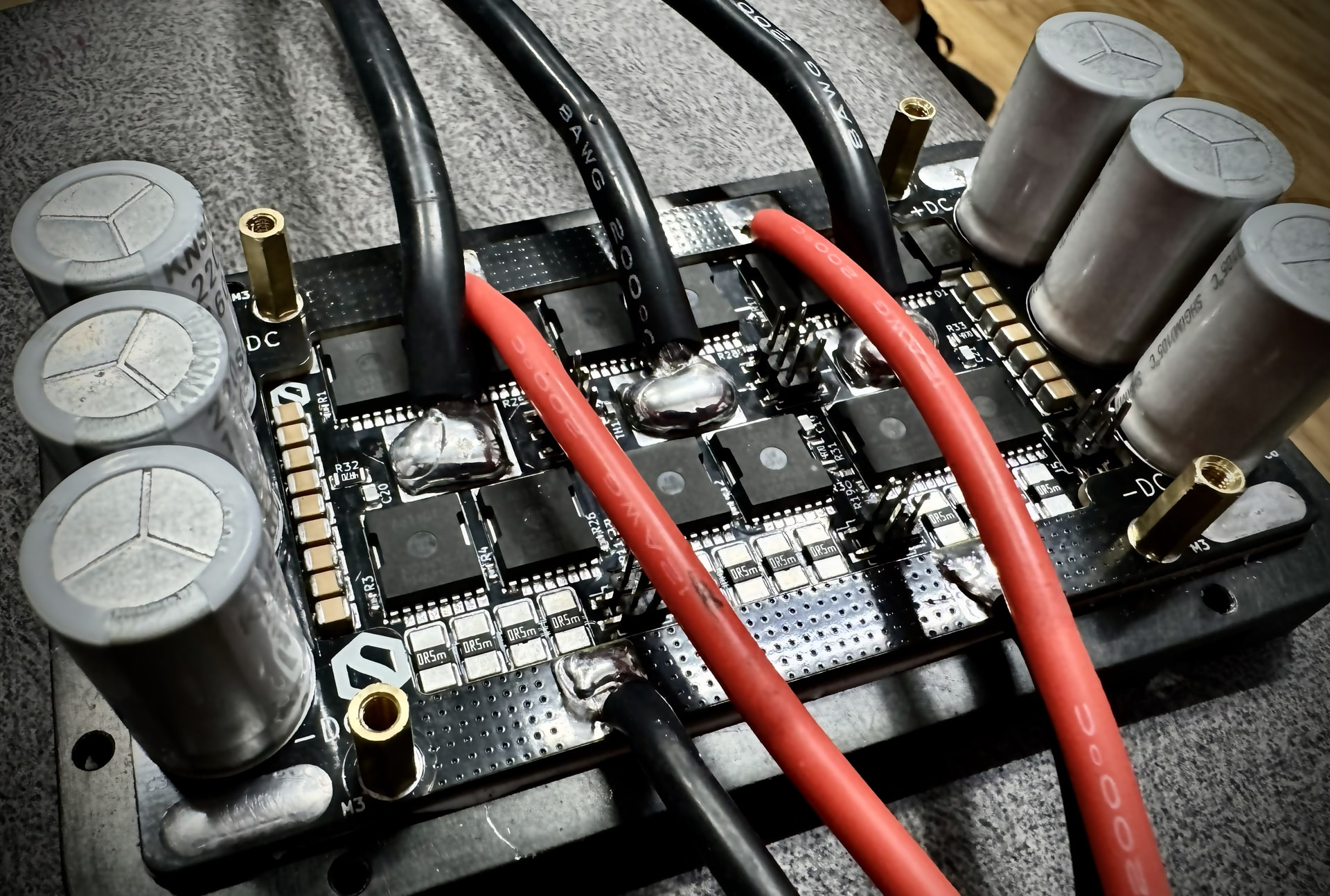

Power stage close-up:
The MOSFETs are in TOLL packages, two paralleled per switch position, twelve total across the three-phase bridge. Between the FET positions you can see the small ceramic capacitors distributed right at each switching node — these are the high-frequency DC bus decoupling caps that keep the voltage clean during hard switching transitions. This is the filtering that matters for sensorless performance — if these aren’t close to the FETs and there aren’t enough of them, switching noise couples into the current and voltage sensing and your FOC observer gets garbage data. It’s the single most common cost-cutting move on cheap controllers and it’s the reason sensorless performance varies so much between boards that technically run the same firmware.
The current sense shunts are the four small resistors in a row between each FET pair and the phase output — four paralleled per phase. More shunts in parallel means lower effective resistance (better efficiency, less heat in the sense path) and also spreads the power dissipation so no single shunt is thermally stressed. The precision instrumentation amplifier on the control board reads across these.
The bulk electrolytic caps along both edges handle the low-frequency energy storage — keeping the bus voltage stable when the motor pulls hundreds of amps during acceleration.
A note on build quality: What you’re looking at is a hand-assembled prototype — the solder on the heavy phase wire connections is functional but not pretty. Production units will use machine placement for all SMD components and proper fixtures for the power connections. The circuit and PCB layout are final, which is what matters at this stage.

I see Similar power Vesc use same gauge wire for battery
Did you consider doing screw terminals rather than wire-to-board soldering? If so, why did you decide against them?
In my experience, screw terminals are significantly lower resistance and higher reliability than soldering a massive wire to a flat solder pad on a board. Wire-to-board soldering can be ok for smaller gauges of wire, but I’d personally have chosen something else for 8AWG.
Good question. We did consider screw terminals during design.
The reason we went with direct wire-to-board is entirely about size and layout. This controller is designed to fit into tight spaces — inside a skateboard enclosure, inside a scooter deck or inside a one wheeler tight enclosure. Screw terminals or lug posts add 15–20mm of height above the power stage, and more importantly, the terminal mounting points would need cutouts through the control board that sits above. That costs us component space on the control PCB and forces the board to grow in footprint.
So the typical install is just plug the controller phase bullets into the motor bullets. No tools, no wire prep, no torque specs to worry about.
For builders on larger platforms where vertical space isn’t a constraint — a screw terminal variant is planned. Same board, same electronics, different power connection format. Two versions for two different build styles.
Appreciate the feedback — helps us gauge demand for the lugged version.

I never trust designs that have separate control boards and power boards. Have you tested this under extreme vibration?
Maybe consider a flat super flexible ribbon cable soldered between the two boards instead of a hard connector? Just an idea, I don’t know if it’s better. But I would not use this on a skateboard because of that.
That’s a valid concern, especially for skateboard use where vibration and shock loads can be harsh.
In our design, the boards are not just held by the connector. They are mechanically secured with screws and threadlocker, so the connector is not carrying the board load by itself. We have also tested the controller rigorously on e-bikes in off-road conditions for a month, where it sees continuous vibration, impacts, and thermal cycling.
A flexible ribbon cable is an interesting idea, but it also has its own failure points, especially solder fatigue, strain relief, and noise pickup. So we are validating the current approach based on real mechanical testing rather than only theory.
If you have not used this type of controller architecture before, I’d honestly say give it a chance. We are building it with reliability in mind, and I don’t think it will disappoint you.
