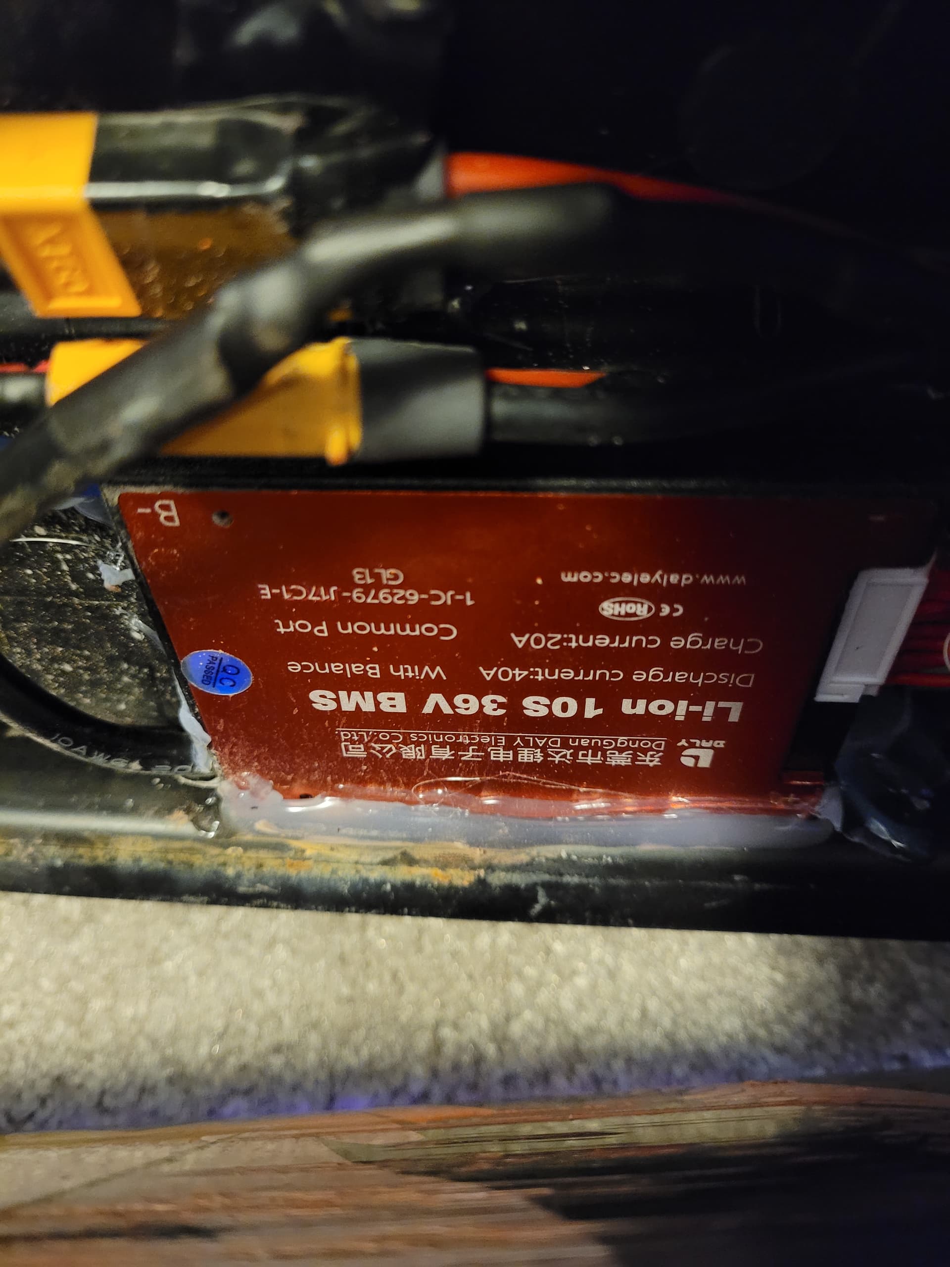

can u snap a pic of the bms? its possible that u got the lifepo4 version instead of li-ion

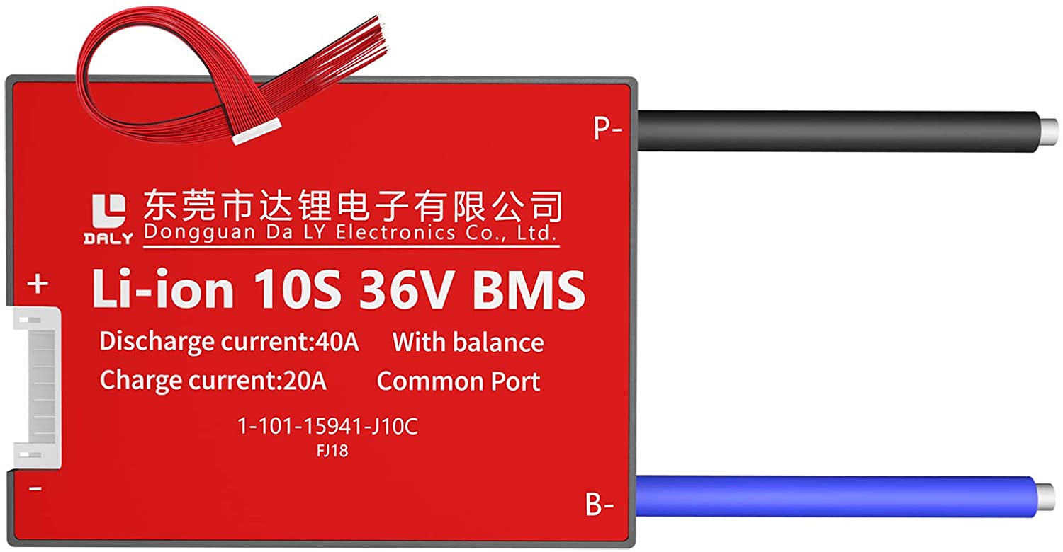

Ill do better than a pic. A link
…this is why a link doesn’t help…because the box could have been labelled incorrectly and u actually got the lifepo4 version instead, a 10s lifepo4 pack full charge voltage is at 36.4v, which fits what u r describing
funny thing is…the box wasnt labled :sweat_smile:
lemme take the ole girl apart real fast
maybe post it in the battery building thread would be more useful, there are many battery experts there who monitor the thread regularly
honestly u and @b264 have been amazing help with my journey lol
it is the correct version, i guess its time to ask around in the battery building thread for more answers
