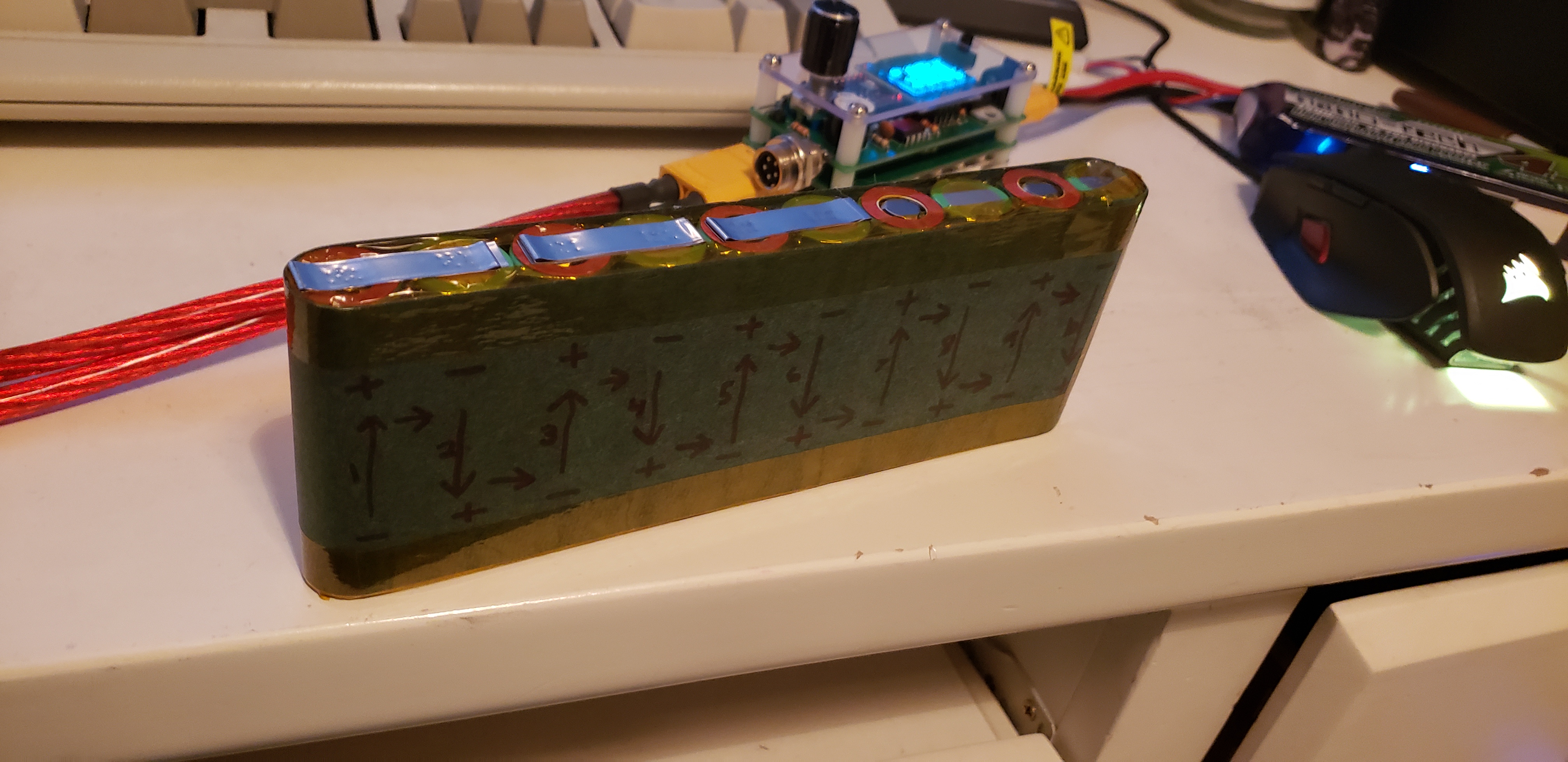

Since I’ll be travelling soon, I’d like to take my board on a few airline trips.
I have some 25R batteries I am considering fashioning into a 10S1P configuration to hit 90watt hours for airline travel.
Since I don’t want to rip a 10S BMS out of my secondary pack, do you guys think it would be fine for a couple weeks to run without a BMS on such a simple pack with appropriate discharge cutoffs on the VESCs?
No, you need a bms. Do it right, do it once. Your charger will keep charging an overfilled series group. Then one series will be high while the other is low and this all leads to failure or a fire.

As long as it’s under the watt hour limit and has some mechanism to prevent fires (BMS) they should be fine. Especially if it actually looks reasonably professional - no duct tape!

It will look professional and be as safe as I can possibly make it. Rounded nickel, fish papered terminals, isolated connections, fishpaper around whole thing and between P groups, and under 90wh.
I’ll go ahead and strip the BMS from my other pack, that seems to be the clear consensus.
that sounds good. Usually the limit is 100 or 160Wh so <90 should be fine. Worst case you can ship it to your destination beforehand - same restrictions as flying but no TSA to fight.

You can run a battery without a BMS if you set it up for a balance charger. There are a few 10s balance chargers out there, but 6s chargers are much cheaper, so you’d have to break out the balance connectors into 2 5s packs.
All this might be too much trouble if you have a BMS laying around or can wait for a delivery. Personally, I like using an external balance charger and have no on board BMS’s on my boards. So yes, it is possible and may even make sense depending on your situation.

Okay, after some research, I will not be flying with a self made pack. Airlines require batteries to comply with all UN tests part III subsection 38.3, like smashing them, forced discharge and overcharge, thermal tests, short circuit tests…
I know I can make a safe pack with BMS for charge/discharge, fasioned in a way that would probably pass these tests, but still, DIY is in no way certified so I’ll just leave my board at home and maybe take an analog. :face_with_monocle::confused:
