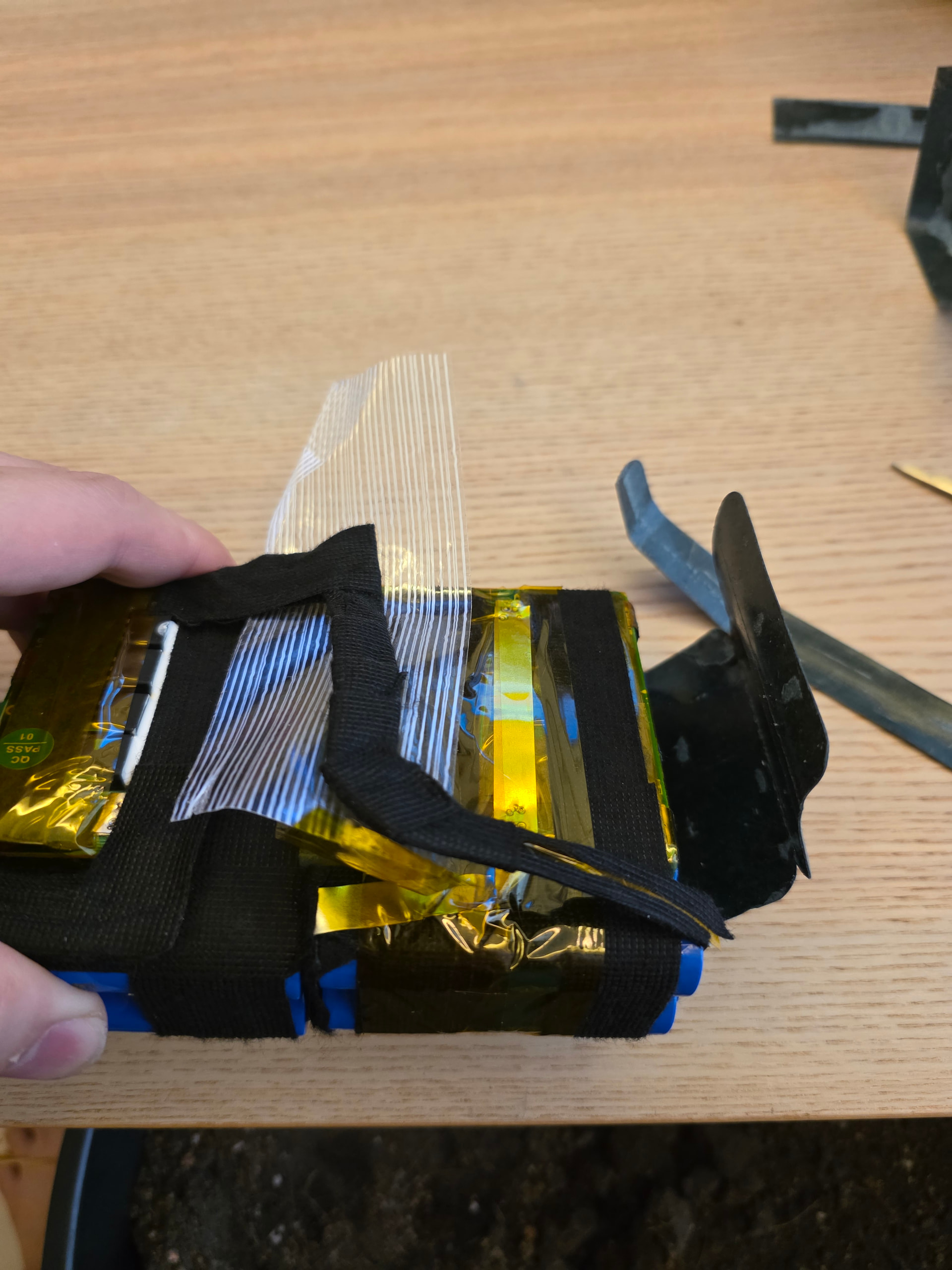

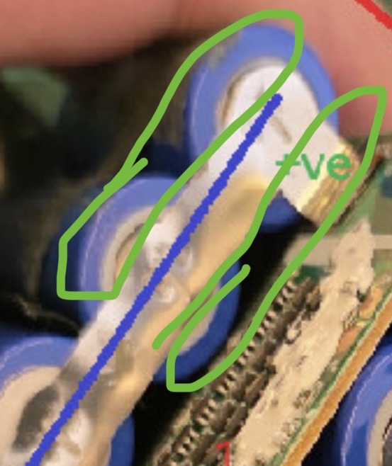

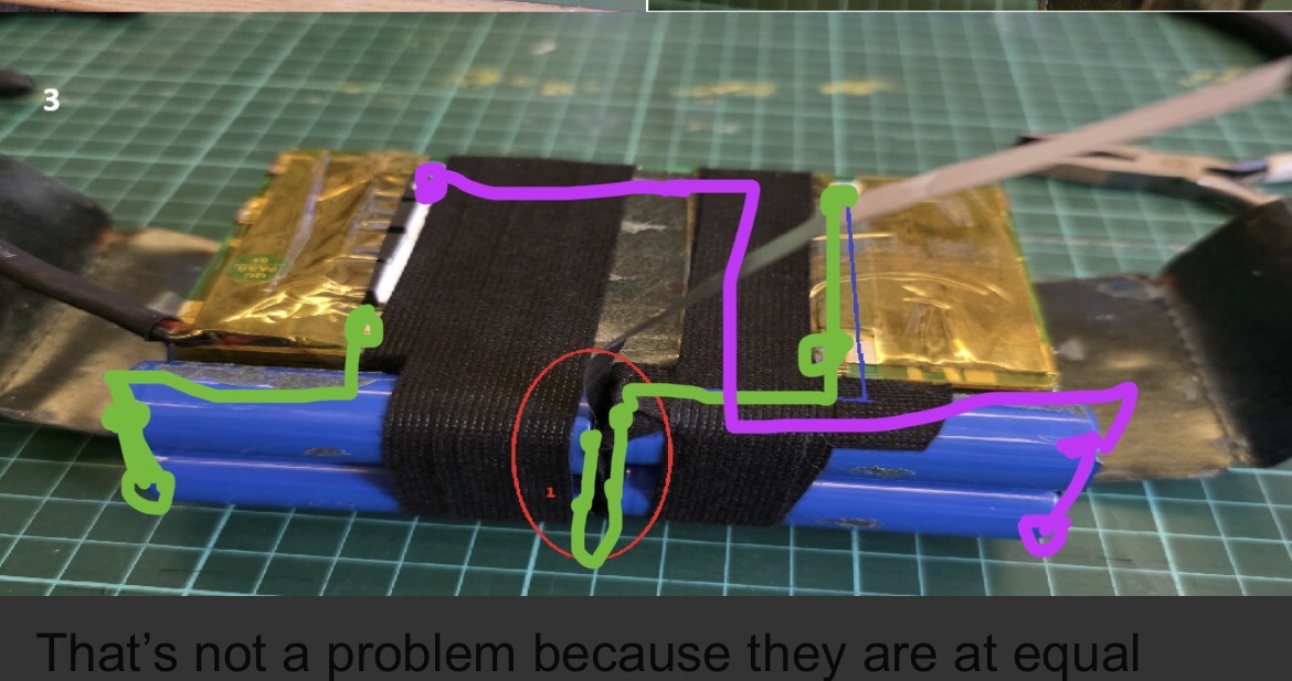

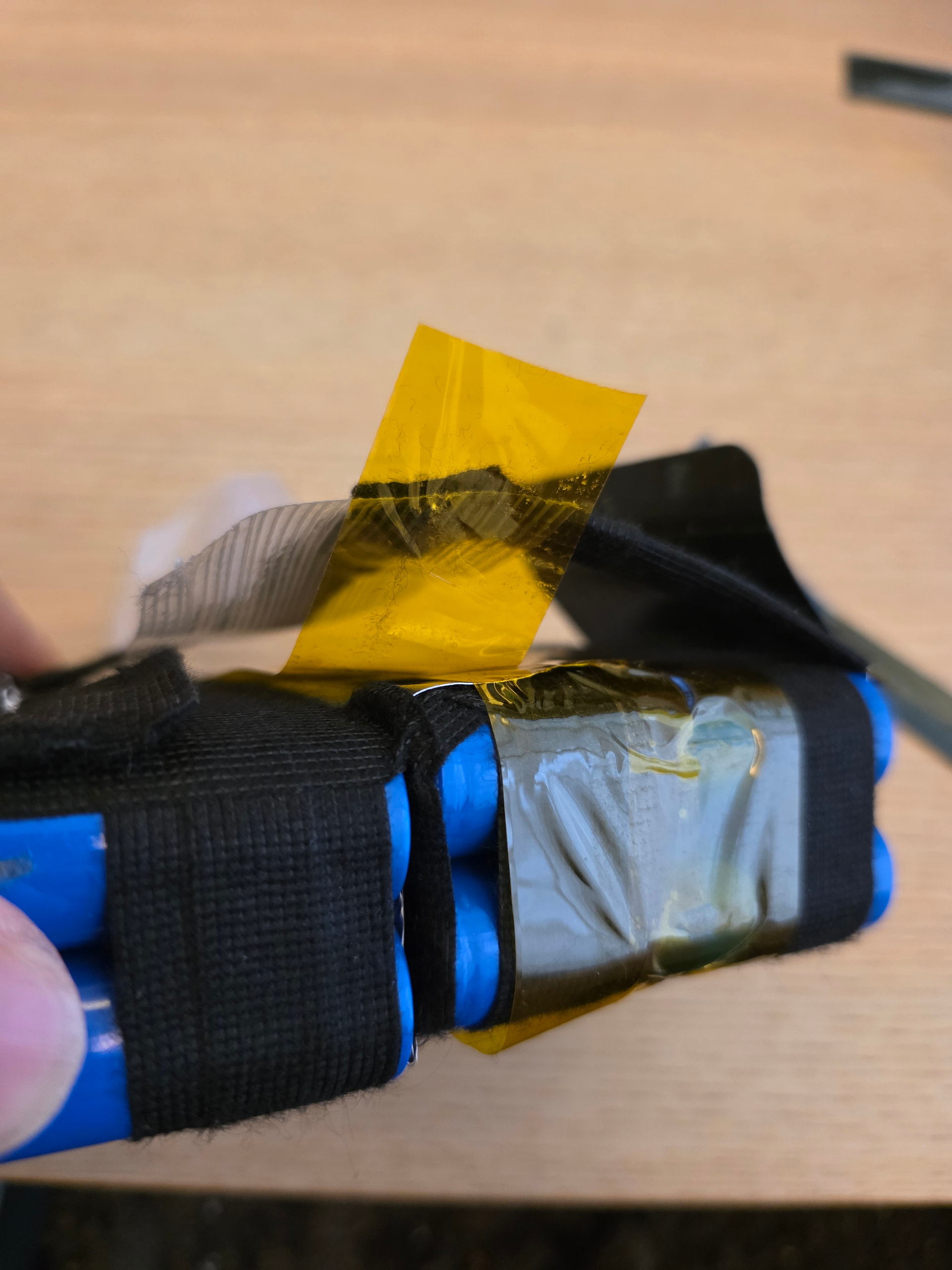

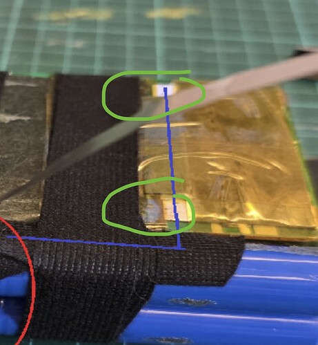

That’s not a problem because they are at equal potential. Also why the strip from the center folded part is to connect to 2 points on the bms. The biggest issue is protecting the “shoulder” of the positive cells when folding as that has the potential to short.
I didn’t show it but you need to put some fish paper right over the cells that sticks out here to protect it. All the reas can be in firm contact without issues

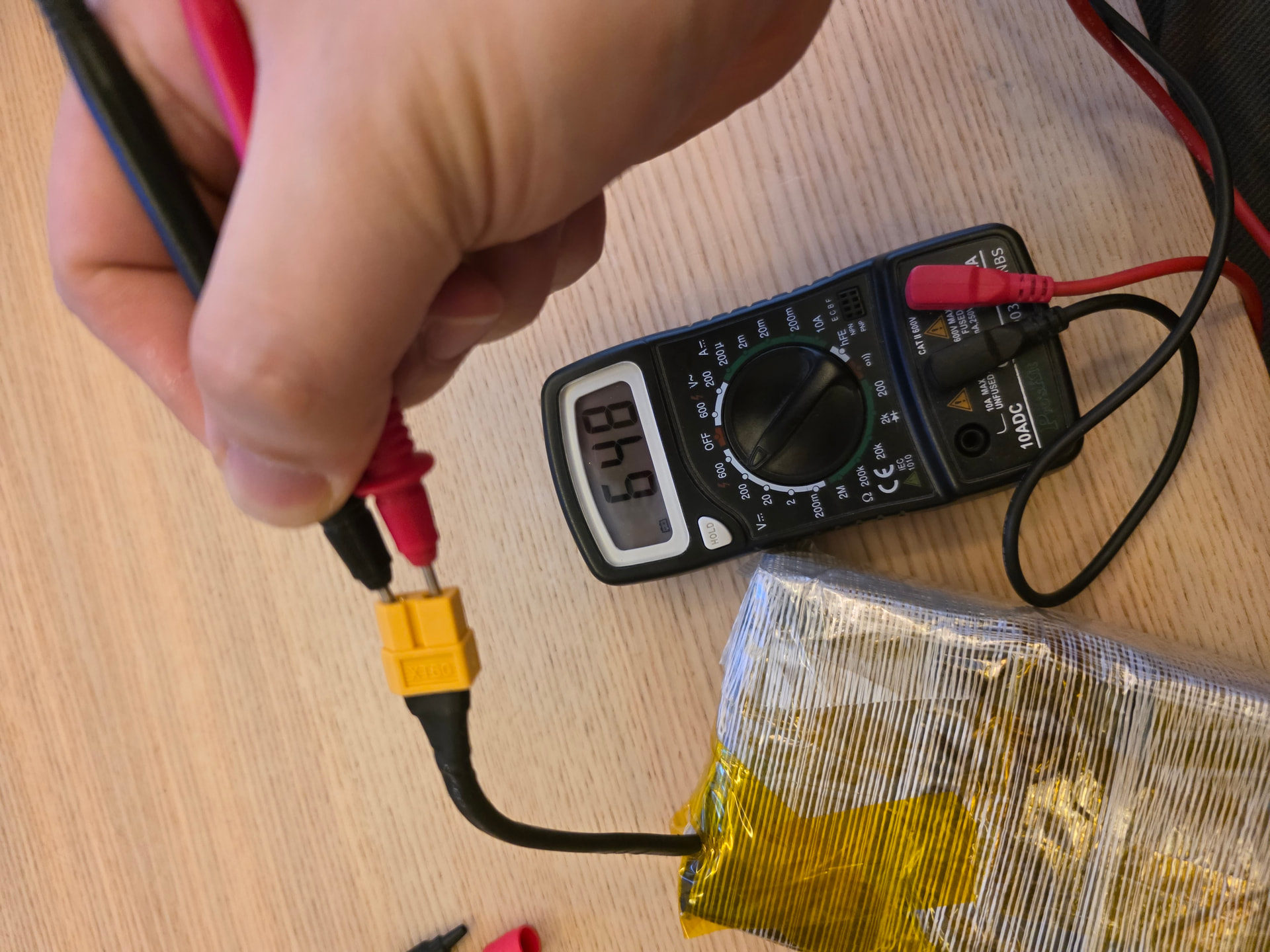

Okay, i’ll go ahead and take it apart and add more fish paper in, but that doesn’t explain it got to 46v right?
Did you connect the nickel to both spots here?
Yep, i did, let me take it apart and take a photo
Ya that doesn’t make much sense unless you somehow connected the 4 cells you moved into 4s1p somehow and then connected it to the side. I don’t see how that’s possible without doing it intentionally.
They should connect like so. Left most cell positive to B10, B9- and B9+ to the center connecting all 4 cells, then right most negative connection to B8

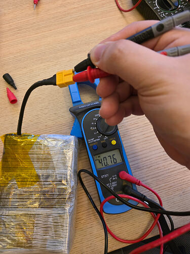

yep thats what i did, what are the probability my multimeter is busted :sweat_smile:
anyway the fish paper in between the terminal, apparently i already added tesa tape on the +ve terminal :sweat_smile: but since i am here, i’ll try to stuff in a fish paper

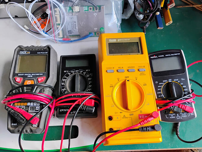

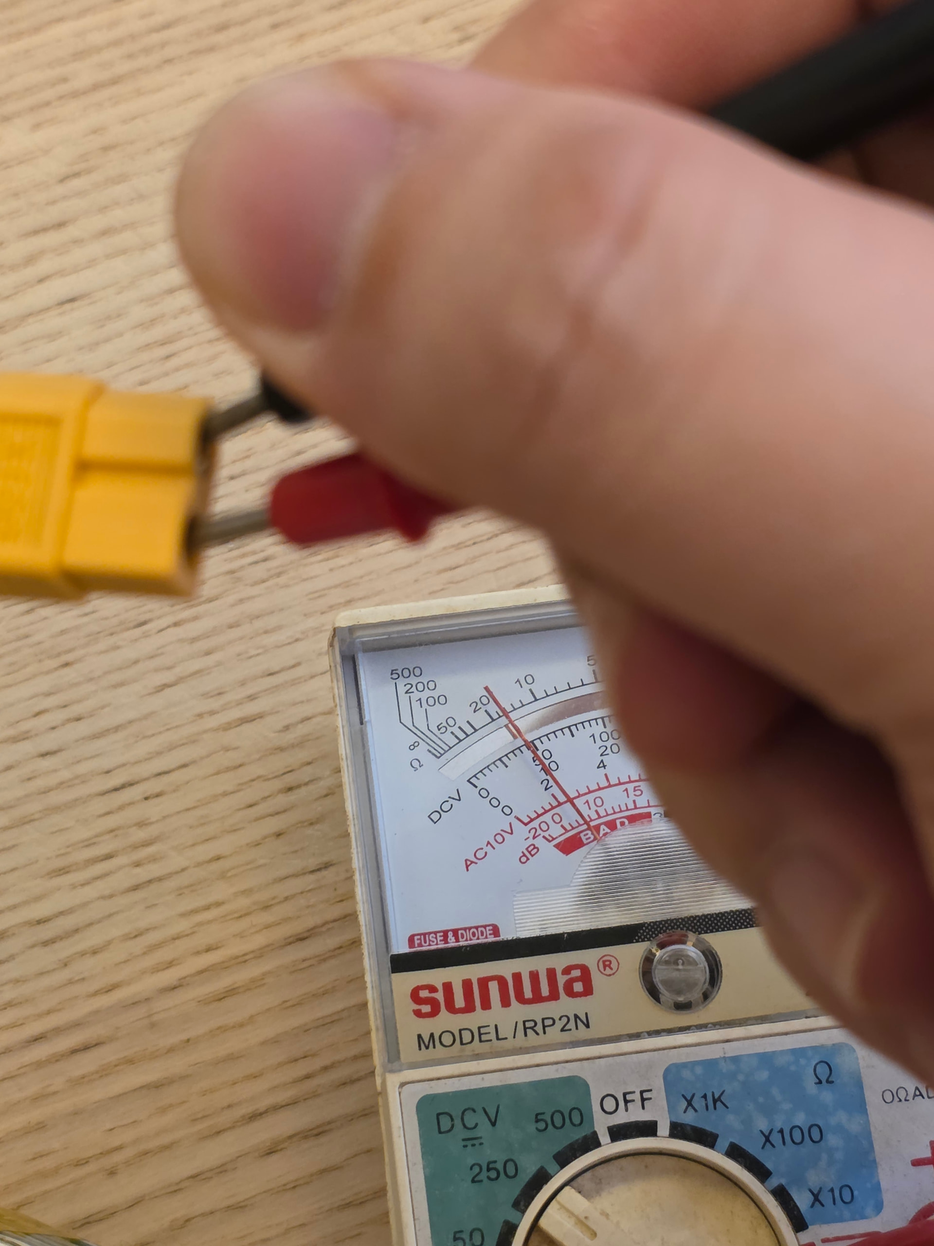

Yeah.. i think one of my multimeter is busted
oddly my ancient one also worked it around 49v?
:person_facepalming:, i think i’ll hv to hook up the serial and see the debug log
Try replacing the battery, might be borderline dead. The analog one probably just needs a calibration. Good thing to find out now about it the meter so it doesn’t throw you into a panic trouble shooting something else :grin:

Looks like your analog meter is reading 40vDC to me, not 49v.
I have had 2 digital multimeters read way high voltage when its internal AA batteries or 9v battery were failing.
I have also had them behave weird with Nimh rechargables or the lithium Energizers that seem to be in the 1.82v range out of the box. where plain old alkaline are about 1.62v
I have to use plain old alkaline, but get suspicious or readings as those age.
I can confirm all my DMM’s read wacky high voltage when the internal battery is low(dead).

Thanks for checking! I’ll be sure to get battery replacement for the DMM and retest!
