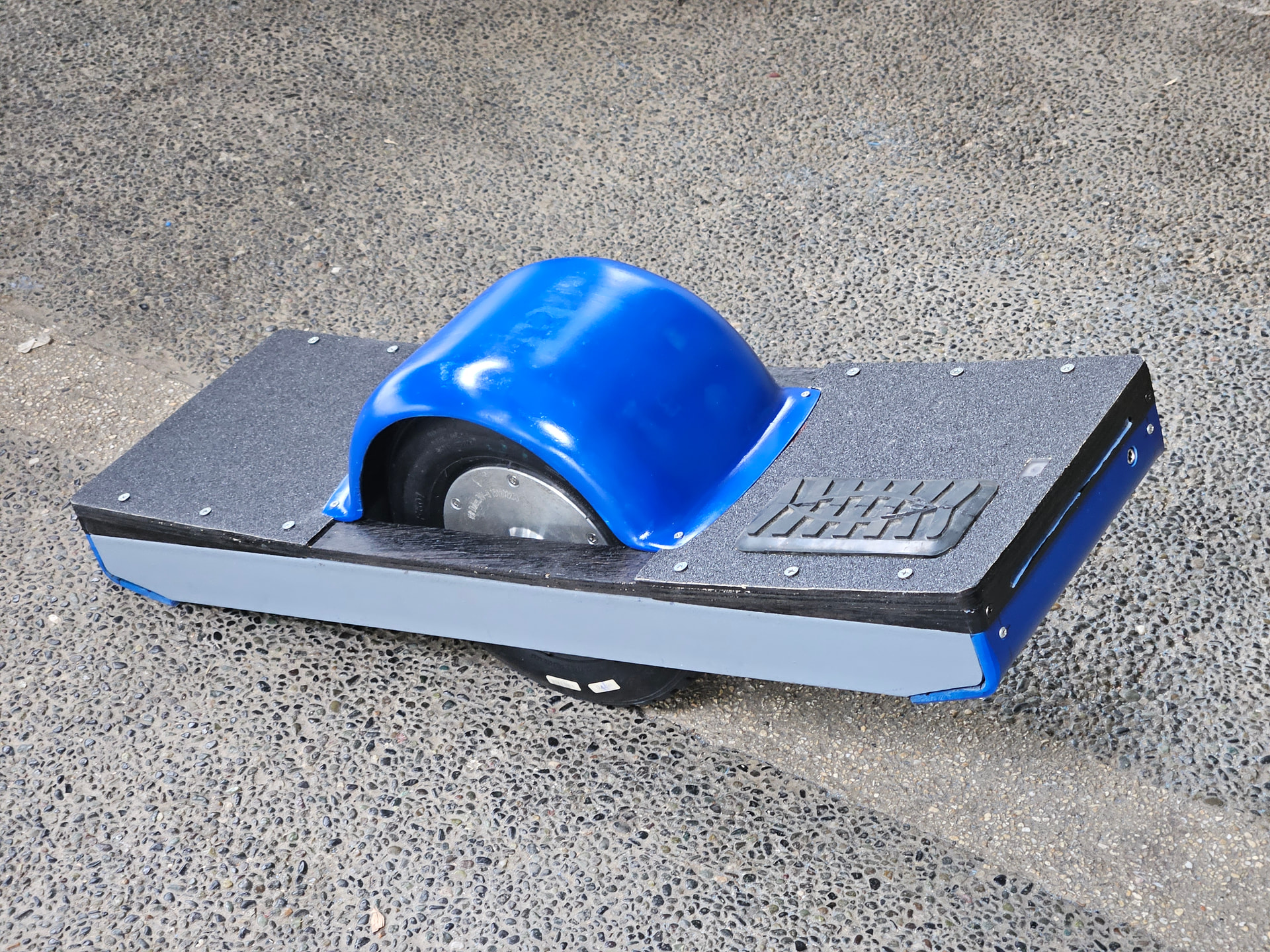

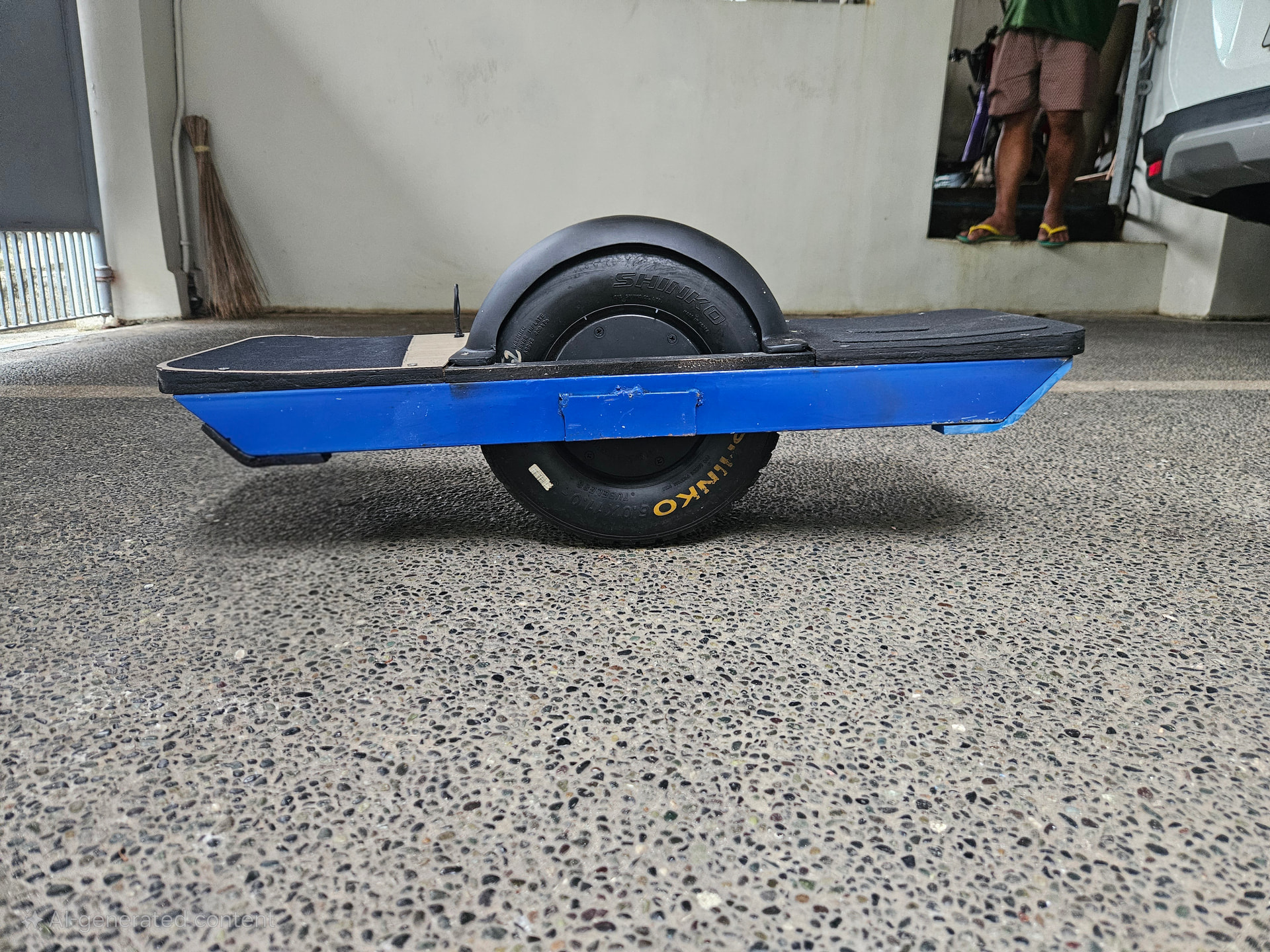

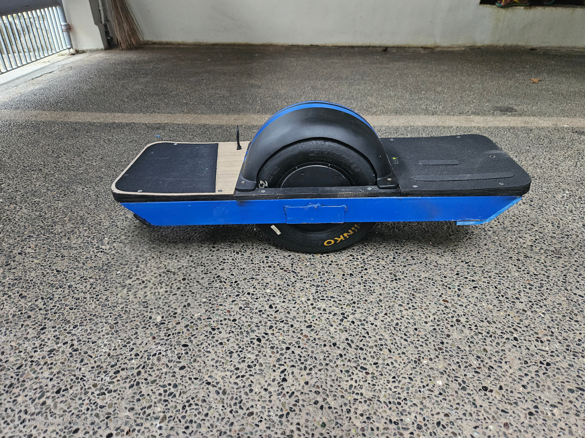

this is v1

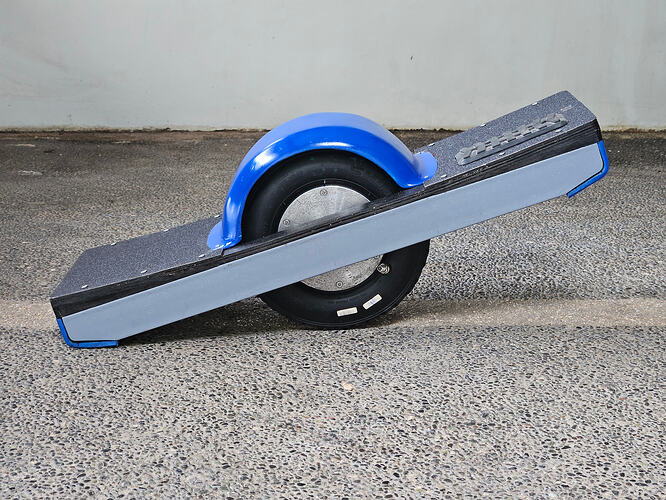

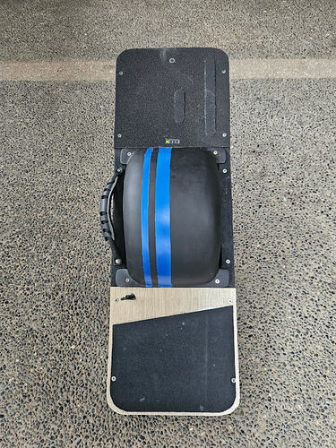

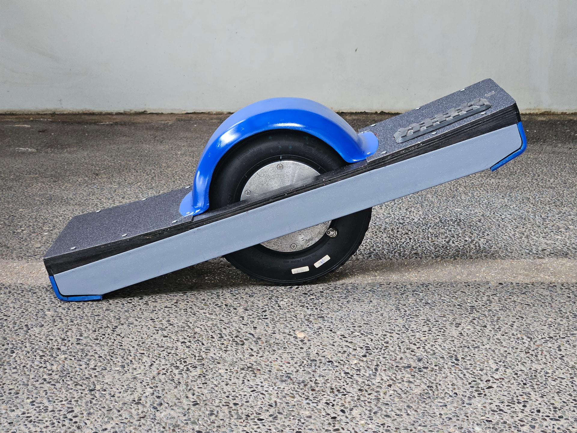

This is v2 the one using a car seatbelt sensor.
