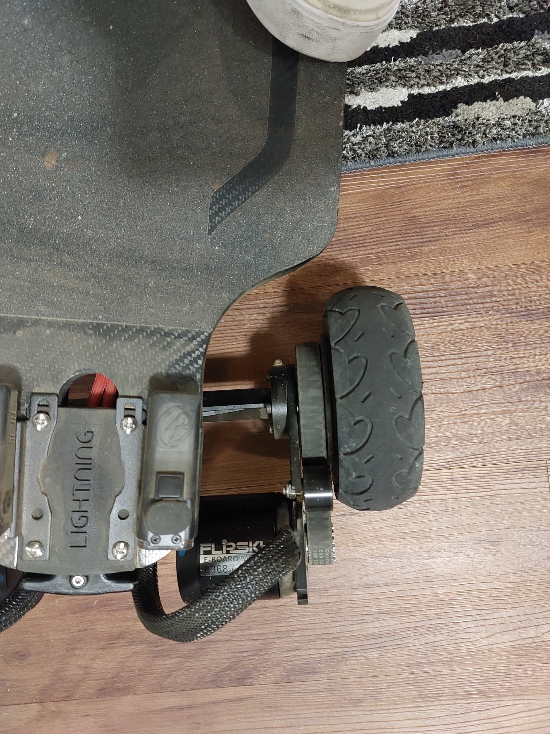

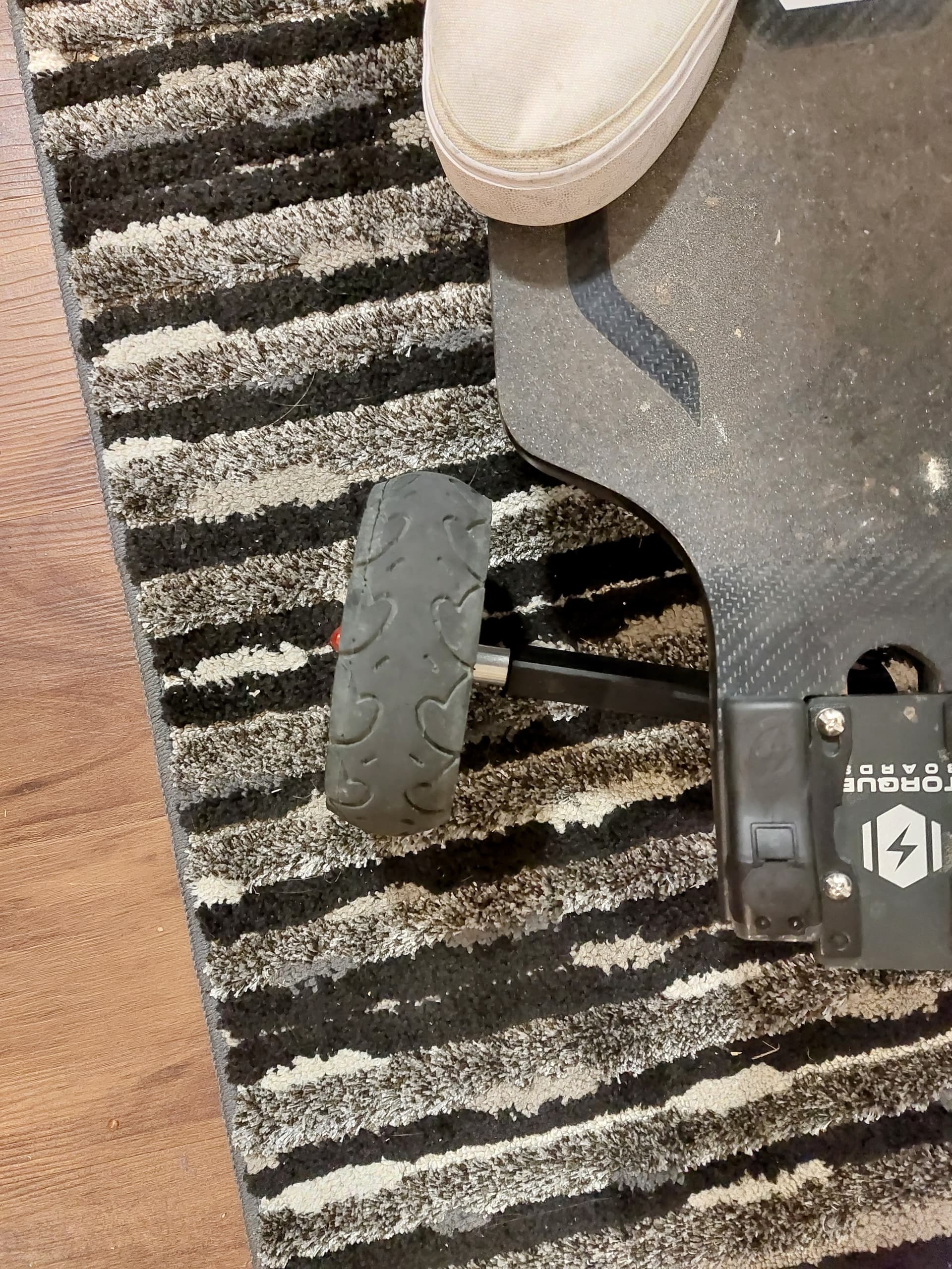

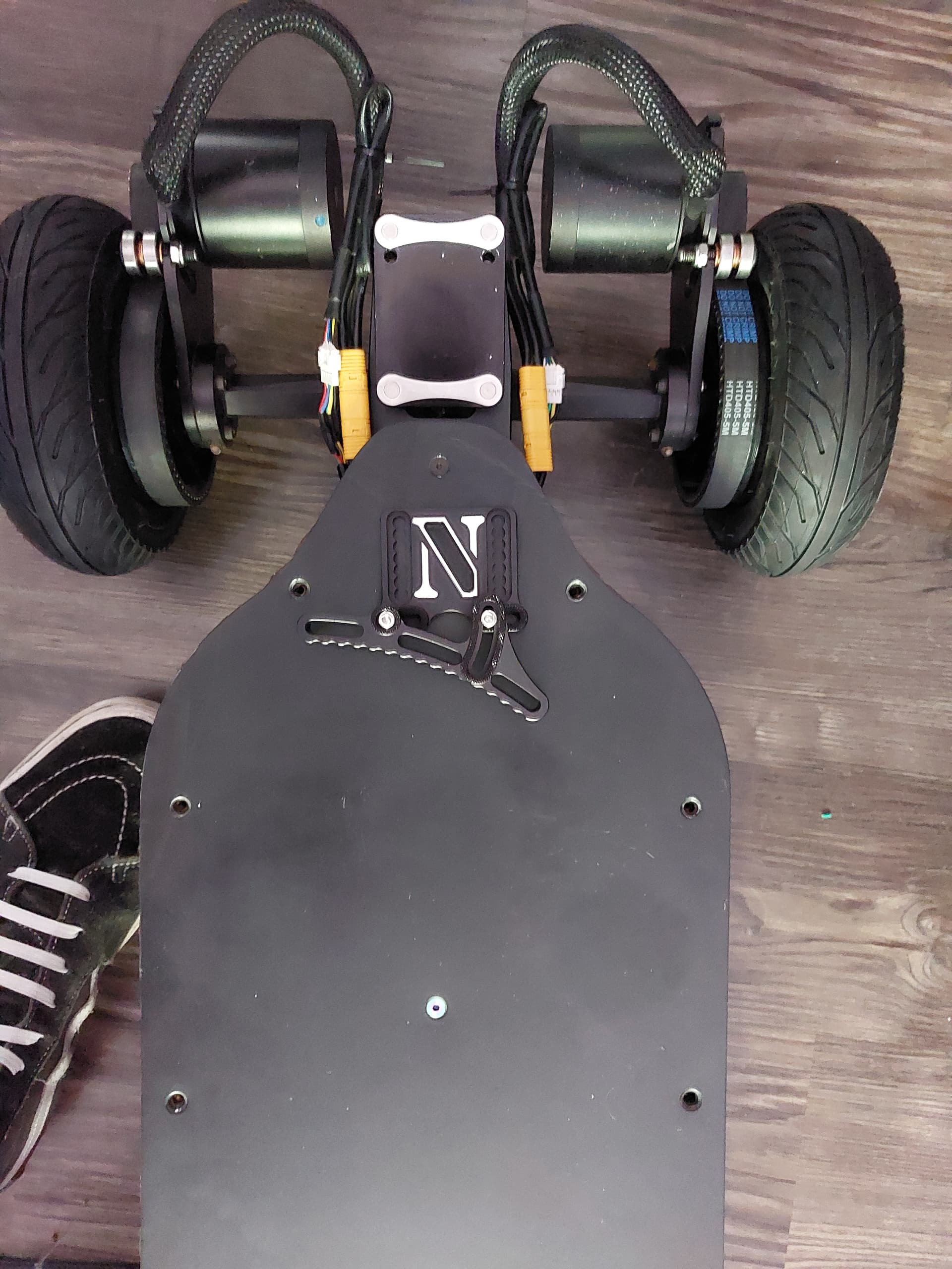

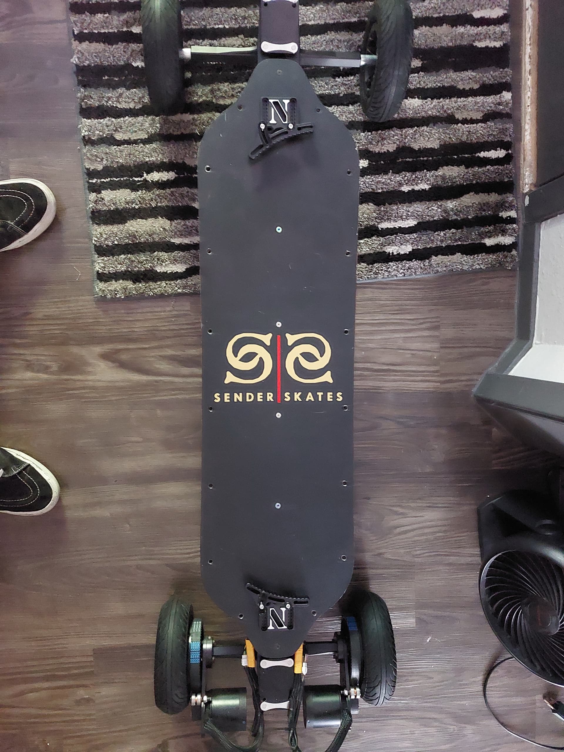

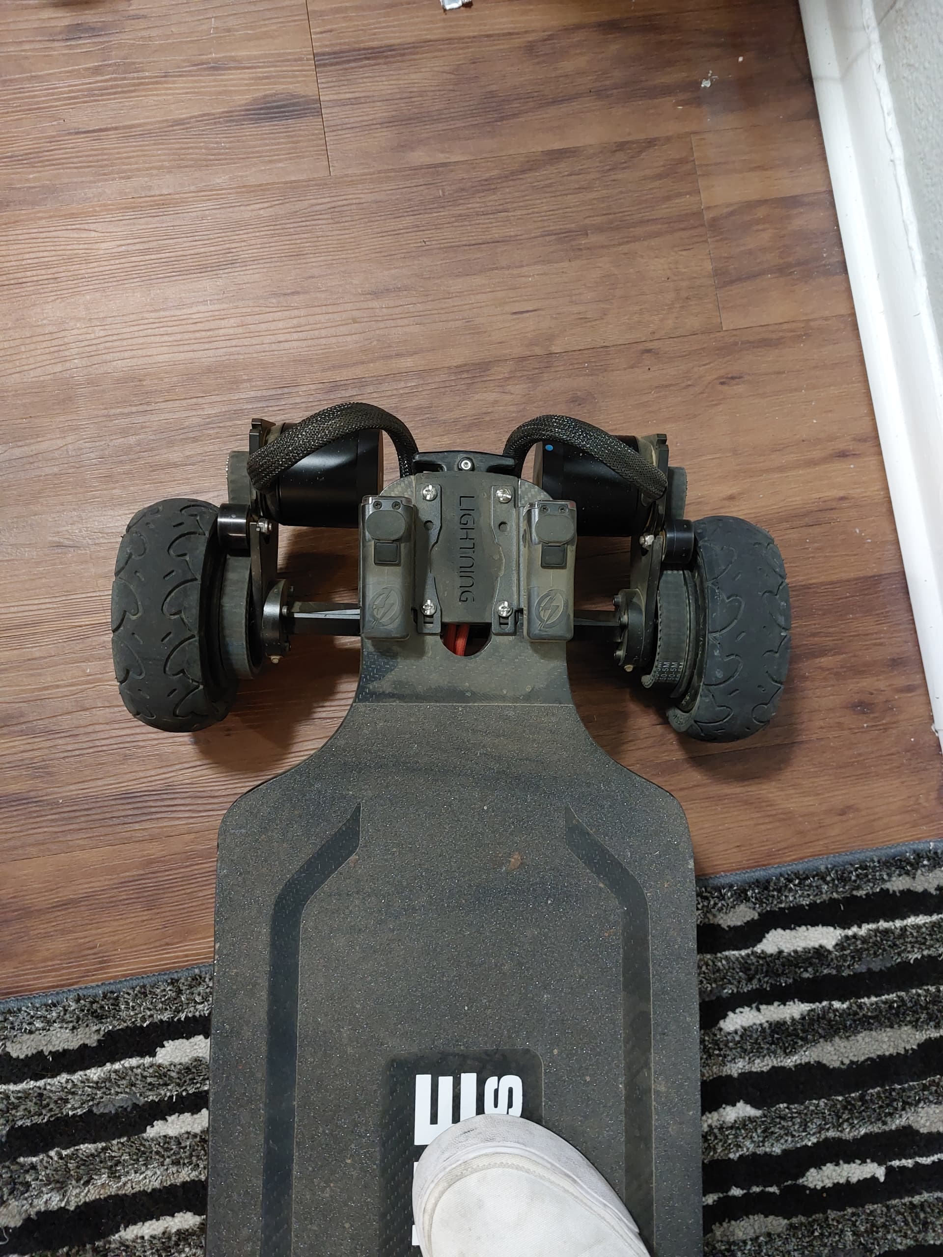

Question for you guys, you think I’d be able to fit 7" on here? I worry about the clearance specifically on the front truck.
Not opposed to shaving off a bit of the deck of necessary but would like to avoid that if possible.
Also is it normal for the BN adjustable baseplates have a little back and forward play? If I move the truck by hand there is a little wiggle room. Not sure if that affects anything in actual riding tho.
Assuming those are 6” tires, I think you could fit 7” / 175mm tires on there.

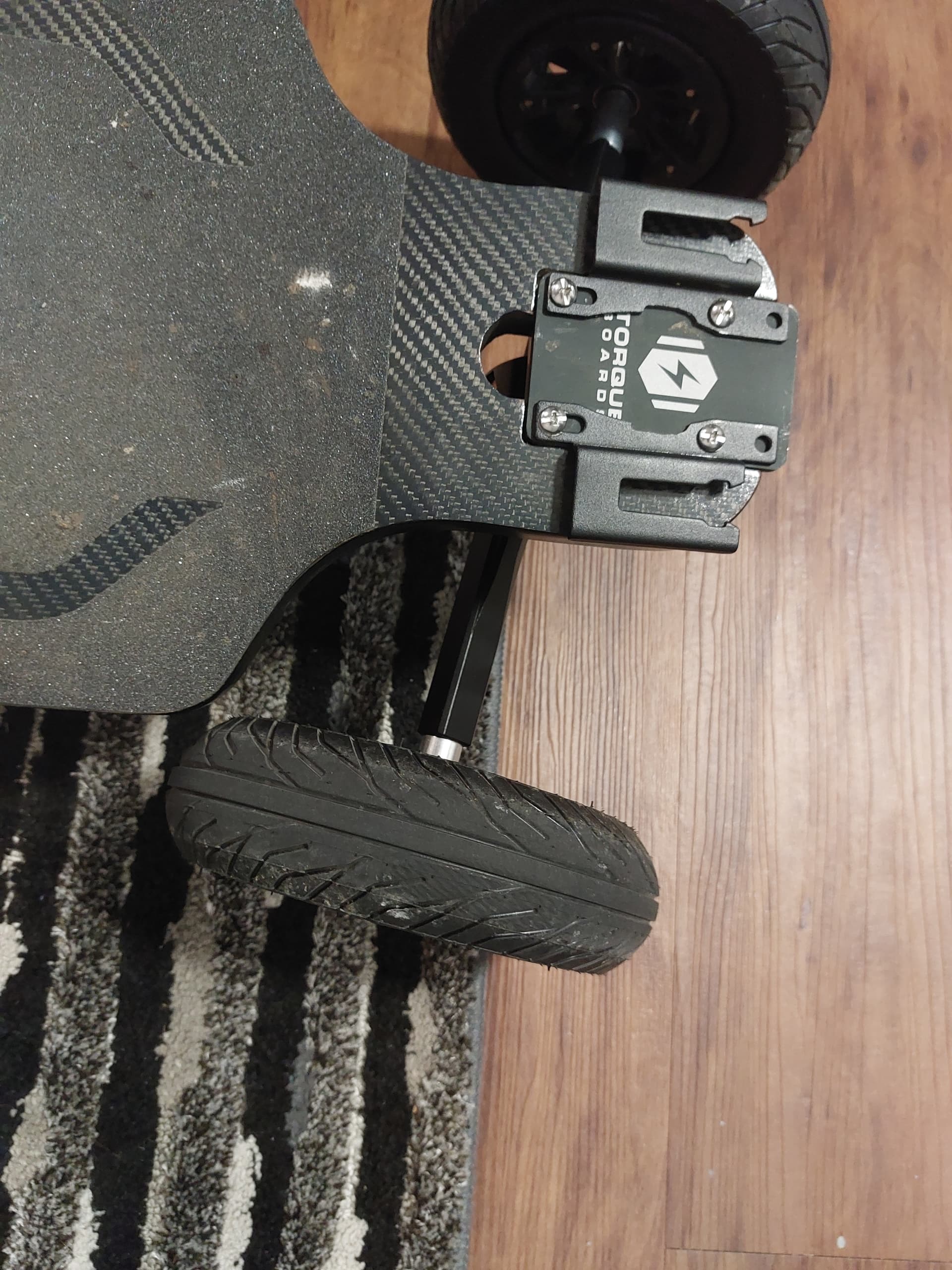

  • Finally got in some 7" Sunmates and put them on. They just barely have clearance with the deck without wheelbite but I’ll take it.
    Really liking them so far aside from getting some wobbles when I first tried them out. Started wobbling around ~23 mph. Not sure if this is a skill issue or if my bushing setup just isn’t optimal. Setup is currently 50/30 barrel/barrel front and barrel/chubby rear. All riptide APS 87.5a.

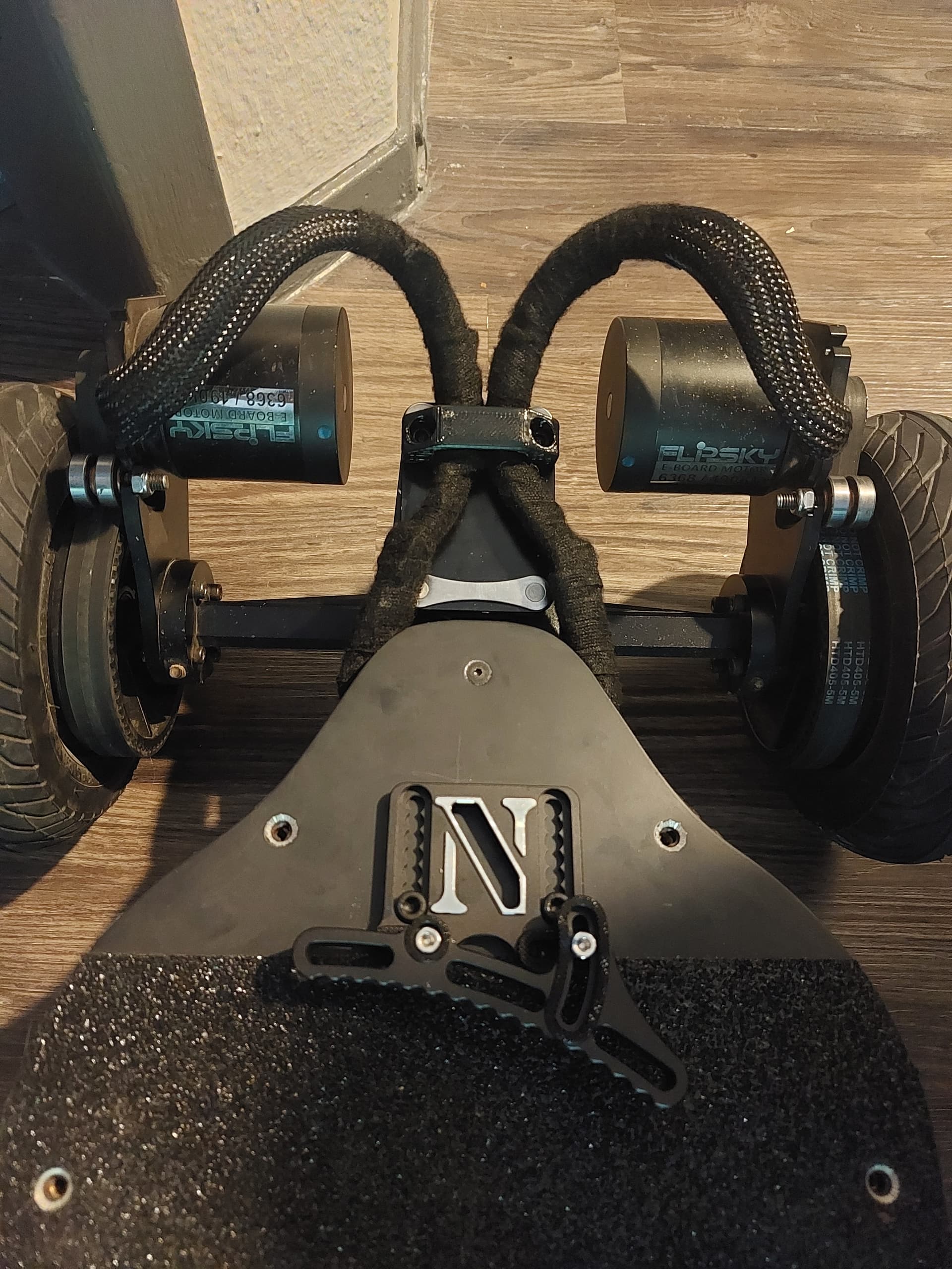

Has anyone else experienced creaking with the BN baseplates? Here is a vid:
Not sure what could be causing it, maybe rubbing in the baseplate? I picked the board up and manually moved the truck and it didn’t happen so idk.

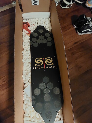

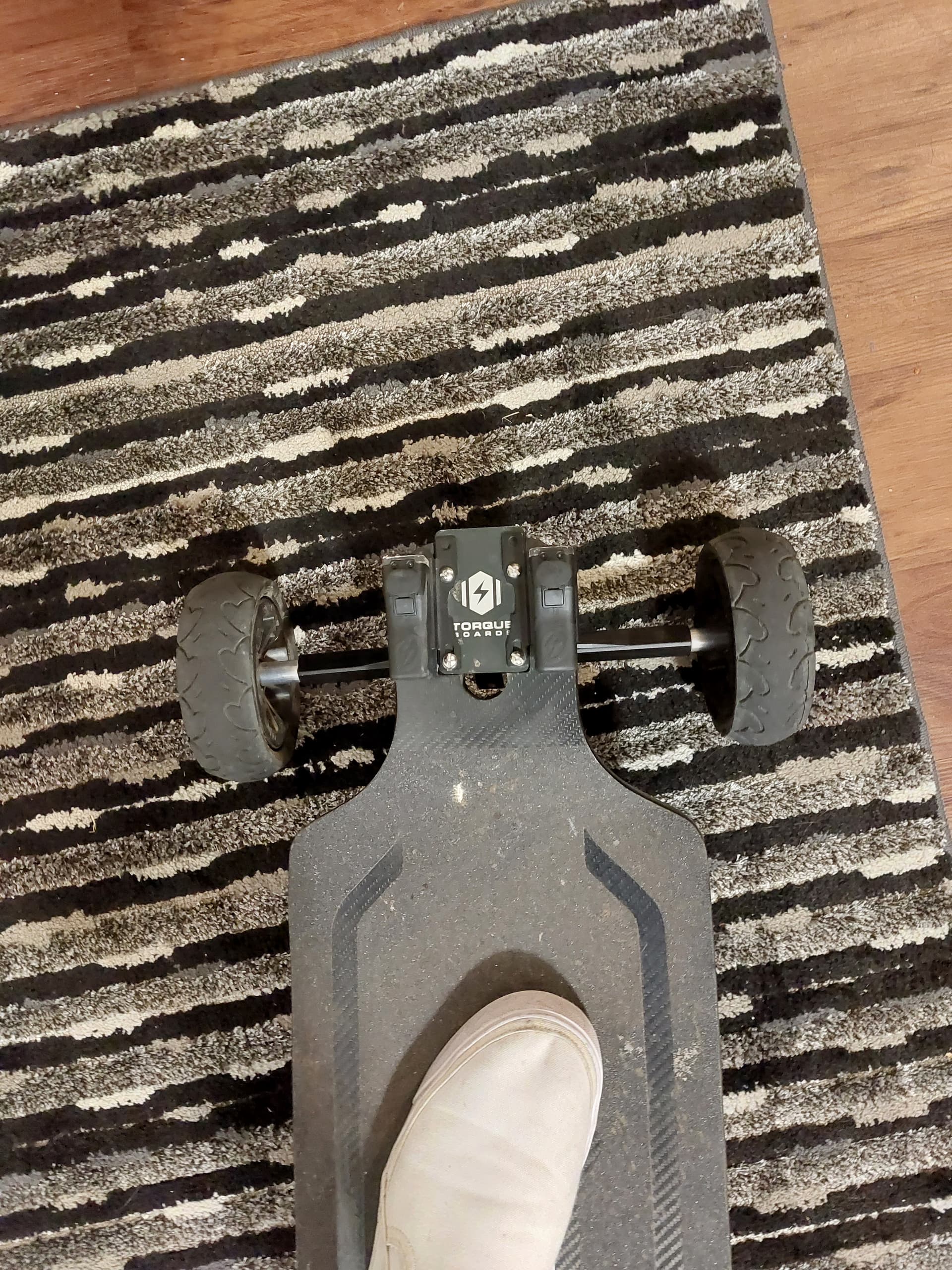

Doing a deck, battery, and possibly ESC swap on this one! I like the TB40 but it is a bit chunky and I absolutely could not pass up this HAYA because it is absolutely beautiful:

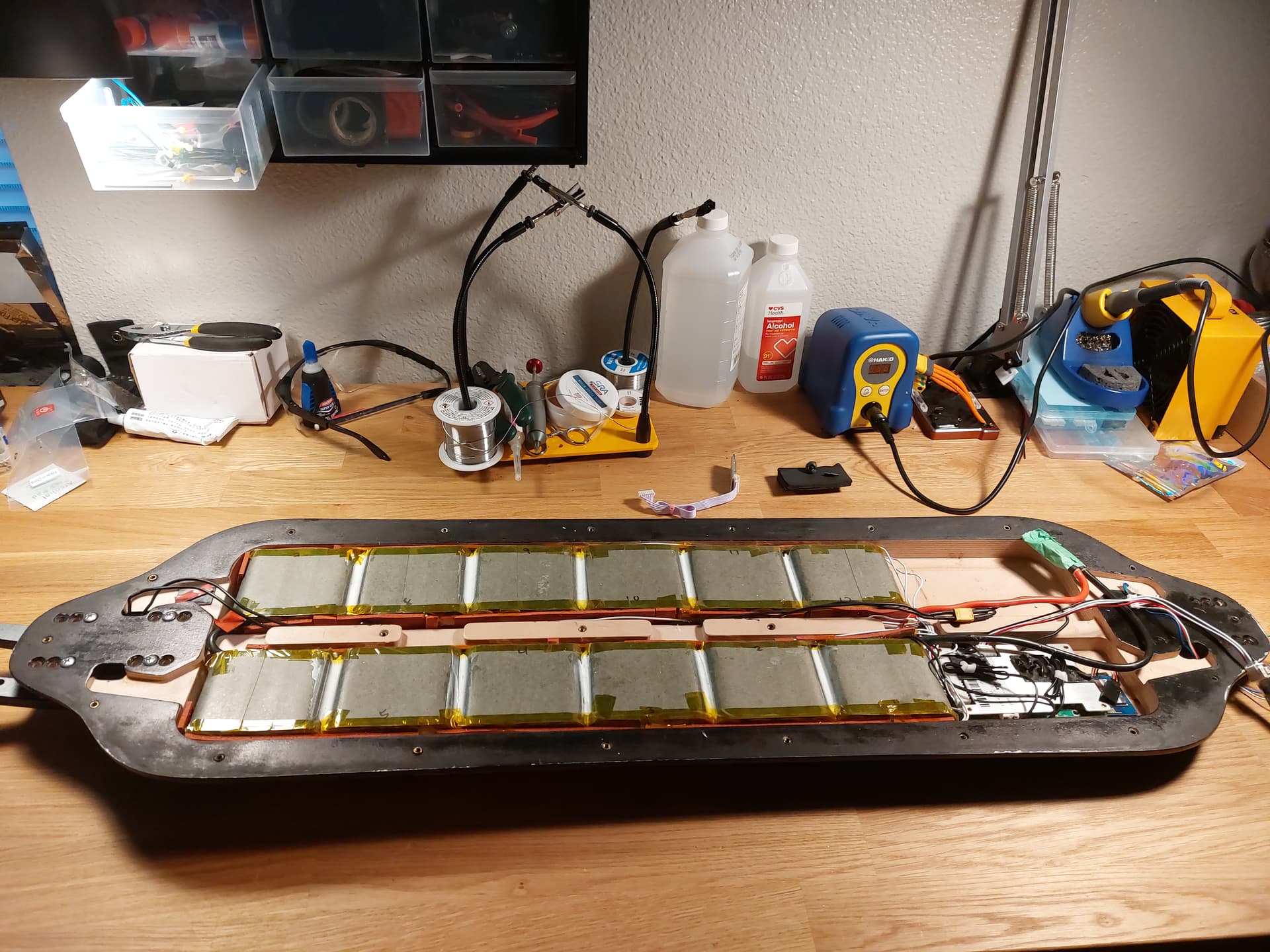

The deck came with a 12S4P P42A battery and a unity, so at the very least the battery is going to be quite the upgrade in both range and power. Not sure if I am going to go with the Unity or stick with the Stormcore, the unity would be much easier to fit so I’m most likely gonna do the swap. At what point are we considering things an entirely new build :sweat_smile:. I’m considering my first build to be continuously evolving at this point, I can never settle on things and instead of making another build I just end up swapping the parts all around. As long as I have something from the previous iteration, it’s still the same build!

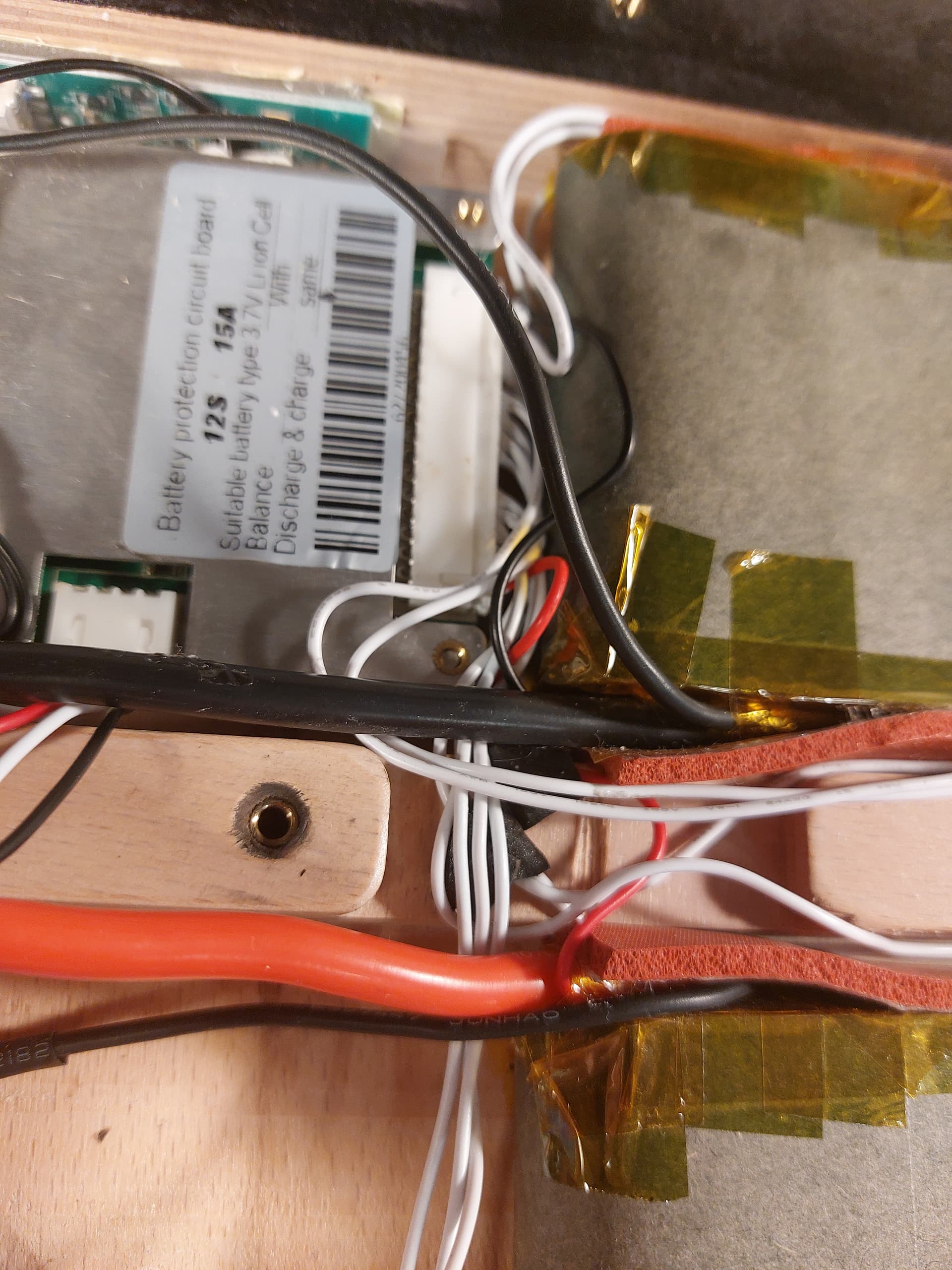

After looking at the internals I’m gonna spend some time tidying things up a little bit. It came with a gx16 charge port and stormcore power button that were mounted in the risers. I like this setup but I got some Weipu SF-12 connectors at the recommendation of @Evwan and like them sooo much more than any of the gx series. Gonna make some 3D printed risers that can accommodate the Weipu and might redo the stormcore riser as well in the meantime. I think it might juuuust barely fit the weipu but I would rather make something custom.
I would also like to add a loopkey but I’m not sure that there is going to be enough room. Balance wires also worry me a little bit so I may make my own harness and redo the connections. Rest of the battery construction looks good though, verified everything looks good through the BMS.
Battery and internals pics:

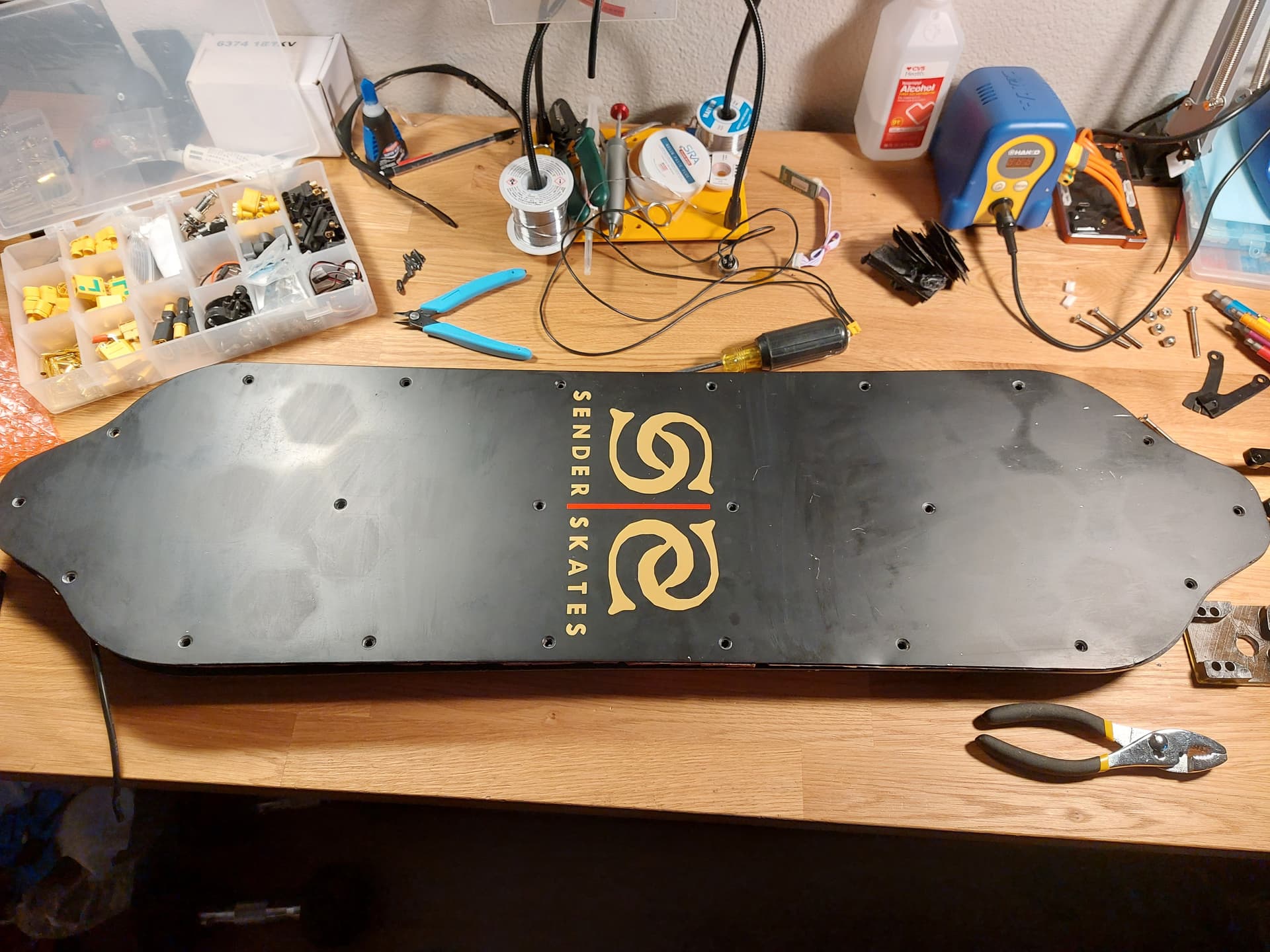

I started off with cleaning things up by removing all the griptape hexagons as they weren’t really the look that I’m going for.
Not sure how I’m gonna go about it but I’m thinking something along the lines of what hoyt does in this griptape pattern, except with sharper corners:
I’m also going to replace the bottom rubber gasket on the underside of the top plate with black rubber instead of red as it is a bit mangled around the edges. I also feel the red doesn’t really fit with it being able to be seen around the edge of the deck.

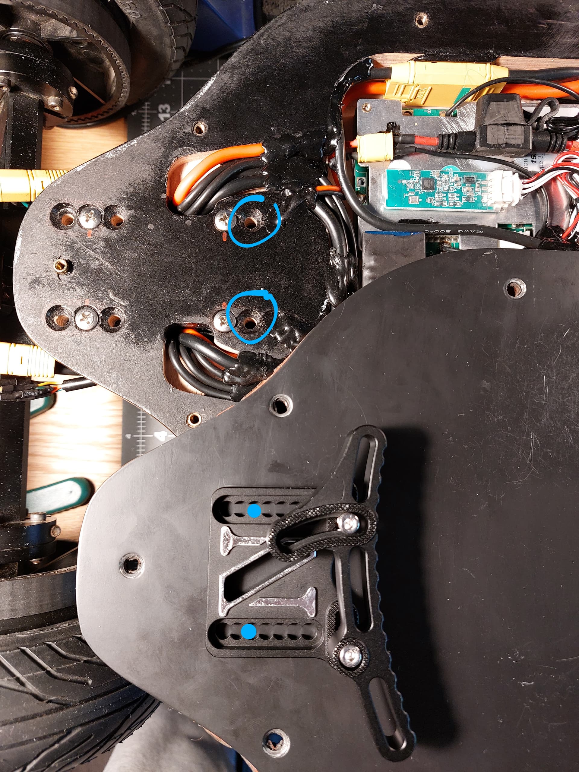

3D printed riser with power button, charge port, and loopkey (I don’t have the files anymore for the riser, computer got wiped :sob:):
Wiring all soldered and tidied up:
Footstop locations, currently only using the back one. Just bolted it through the top sheet metal deck above the back deck holes.

Went on another ride after that debacle and even after swapping out bushings quite a few times I couldn’t find a setup that didn’t cause wobbles. After double checking the angles turns out I was running 45 in the back and ~60 in the front. With the gbomb brackets being 15 degrees I had to adjust the baseplates. Lo and behold when I went to adjust themmmm:
They were warped and the metal cracked.
According to BN you are supposed to REALLY wrench down the adjustable baseplate pin to cause the outer sides to grip the inner portion, and apparently I didn’t wrench it down hard enough and now my baseplates look like this. So once I get replacements in for those the angles are going to be updated to 30/65 (15deg bracket+15deg baseplate, 15deg bracket + 50 deg baseplate) and I’ll see how that fares as far as stability goes.

Also the board is really creaky?
Trying to figure out what is causing that, I think it is the deck screws. Going to vibra-tite them in and torque them down good and if that doesn’t work I will put some superlube or something on the metal holes to hopefully alleviate the issue. Open to suggestions though.
