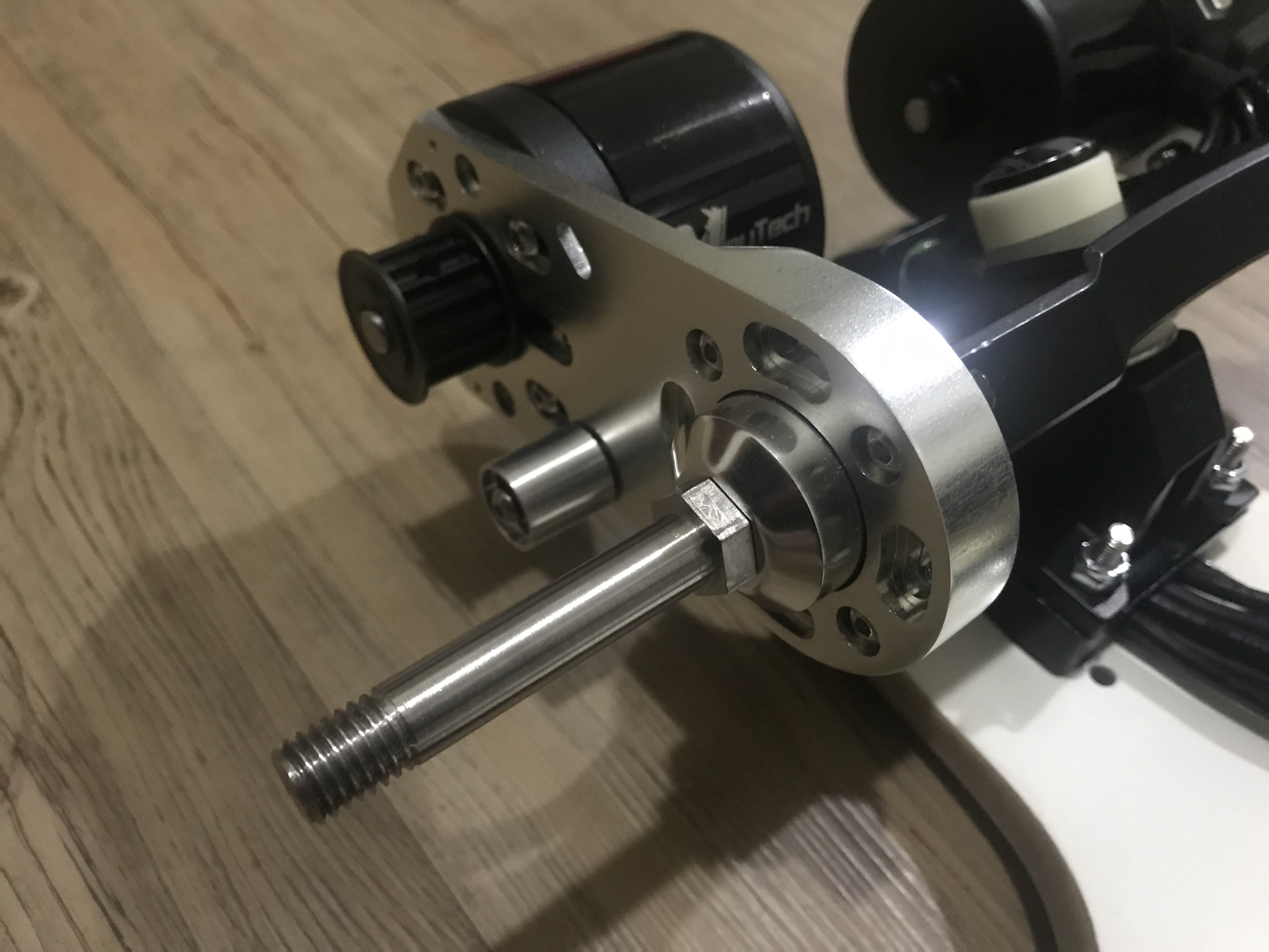

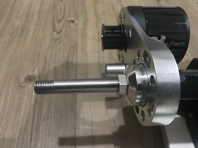

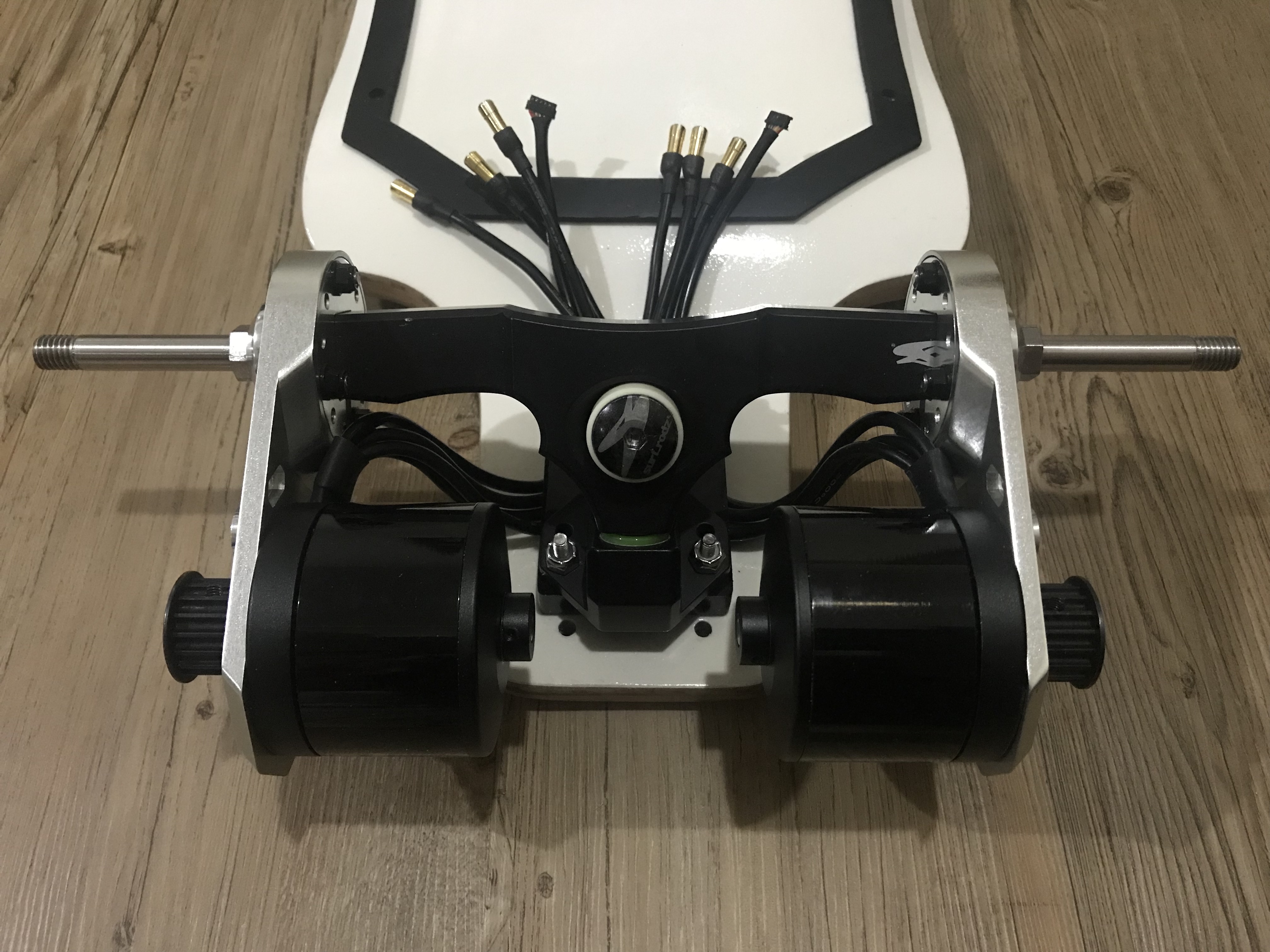

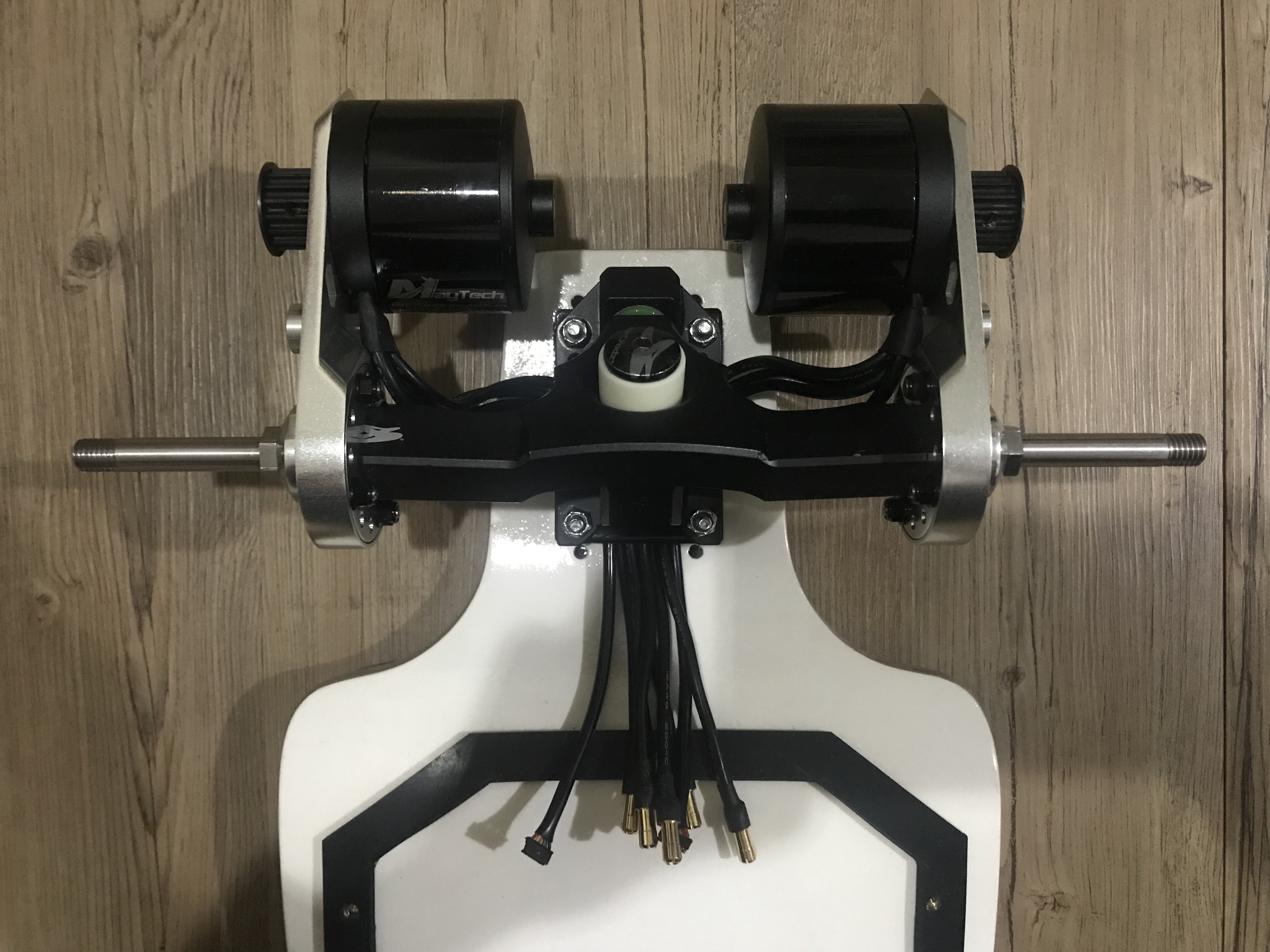

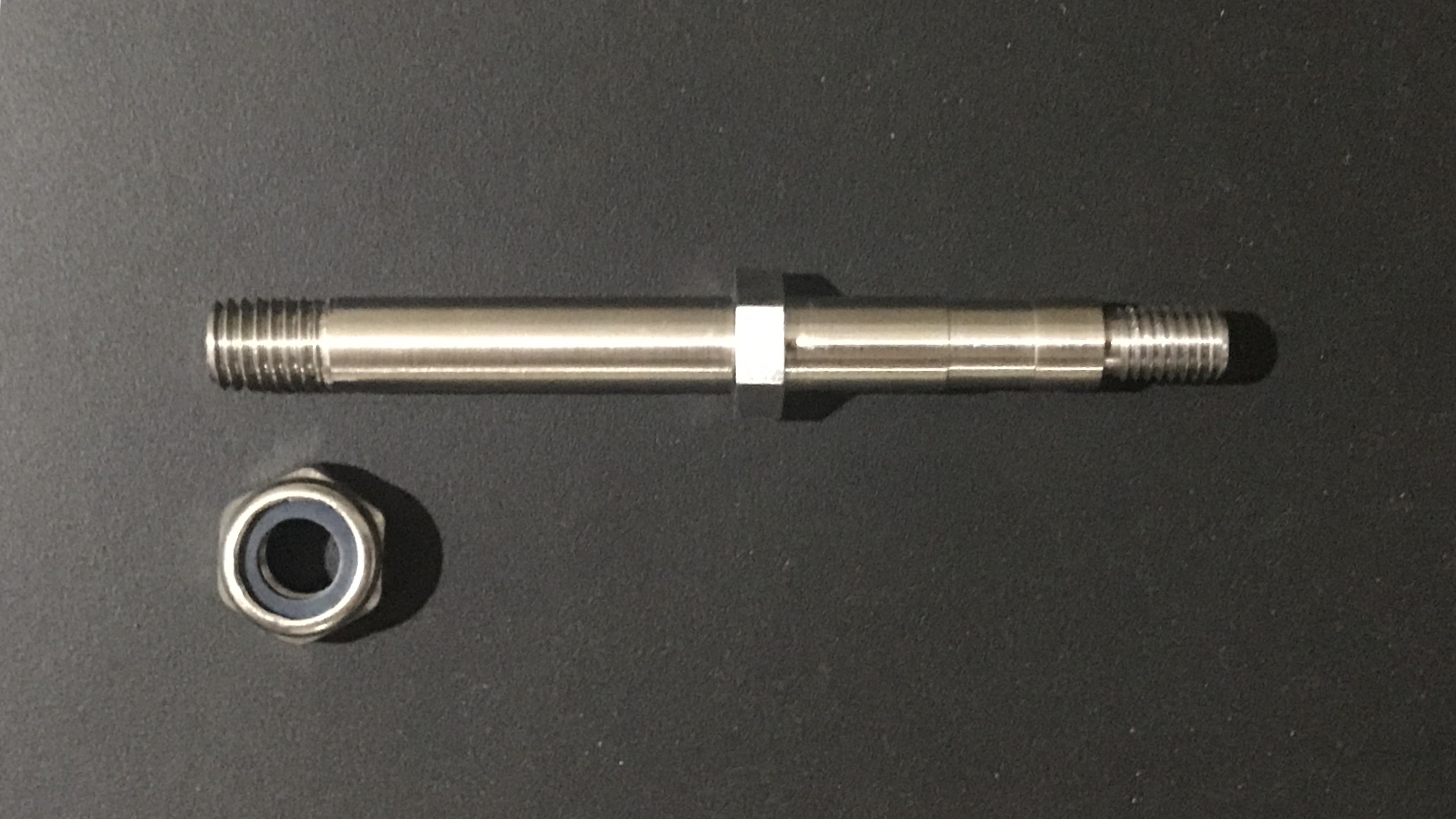

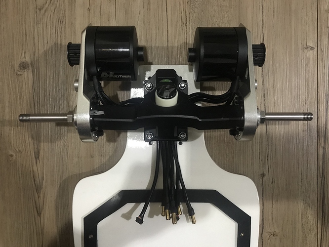

A little update, i manage to make my own double thread bolt axle for this surfrodz trucks and turns out it fit perfectly, i don’t need to loctite them or even using the thread insert.
Bruh I am so confused. That looks dope. How did you make it? Did you start with hex stock and then turn it down on a lathe, using dies for the threads? That’s the only way I can think of making it.
Yes hex stainless bar d14mm, and yes for the process.
Ah nice, that is pretty cool.
Kinda annoying to remove axles every time i need to adjust something there and worrying that one time i will destroy the thread hanger. that’s why i made this.

Maybe later, if i made this for sale what axle length everyone prefer not include the lock thread (just wondering) mine base on 80mm surfrodz shoulder bolt so about 50-53mm useable axle and still using 10mm diameter.

Boardinamics using 8mm hanger i think so the inside thread maybe M6 i dunno. I made this for 10mm surfrodz.
If you could reduce it down to 8mm for the wheel side that would be sick. Wayyy better bearing options
Ya i can do that
