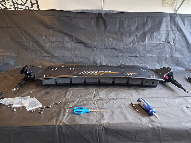

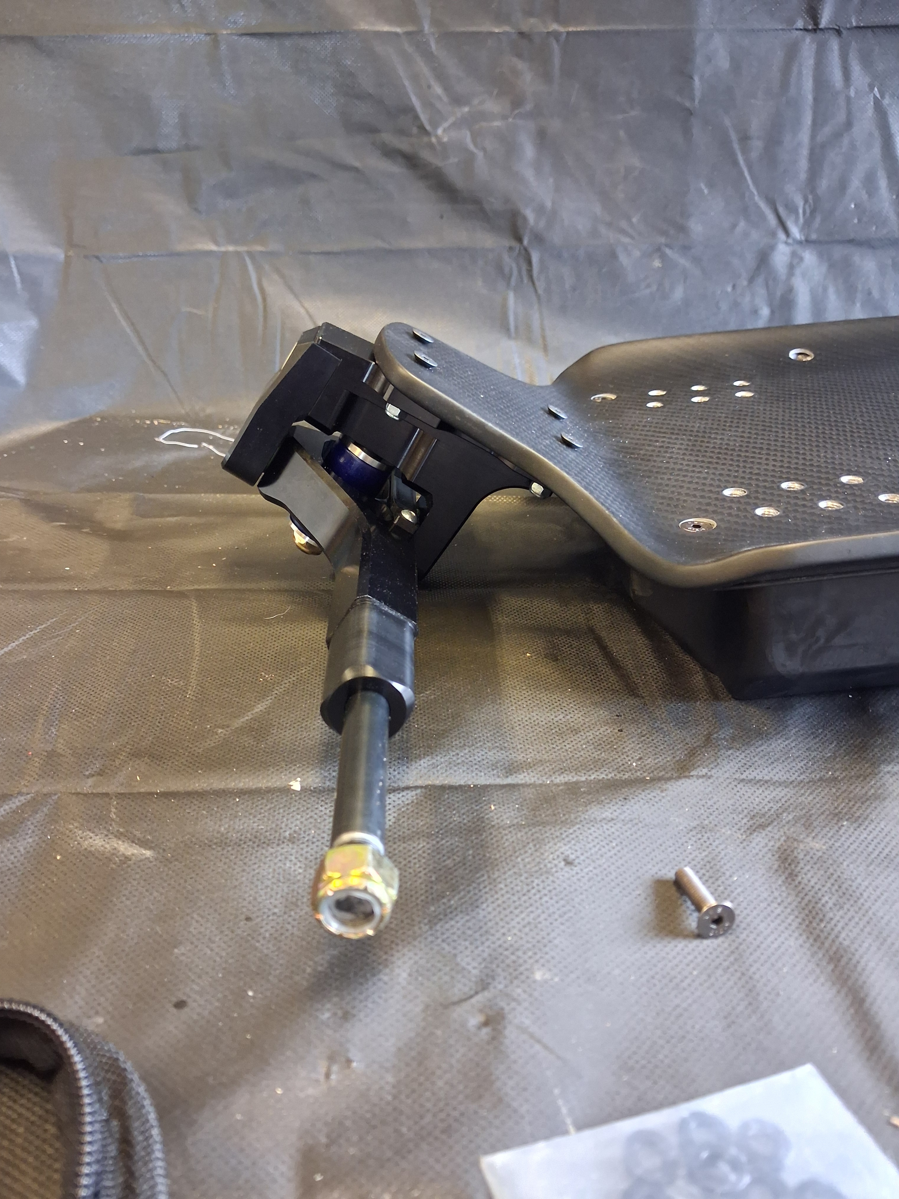

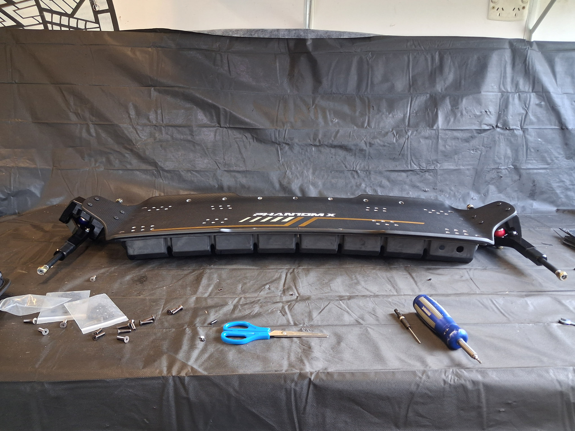

Ok! So after quite a lot of fucking around and finding out, I have the dualities mounted correctly and everything seems to be fitting quite well.
I have the 5 degree baseplate wedged at the front and the 15 dewedged at the rear. I am definitely concerned about deck/foot bite at the front and think i’ll likely need to flip that front hanger as well as riser/extension plate to push it out a bit further but I have to wait for the wheels to determine that.

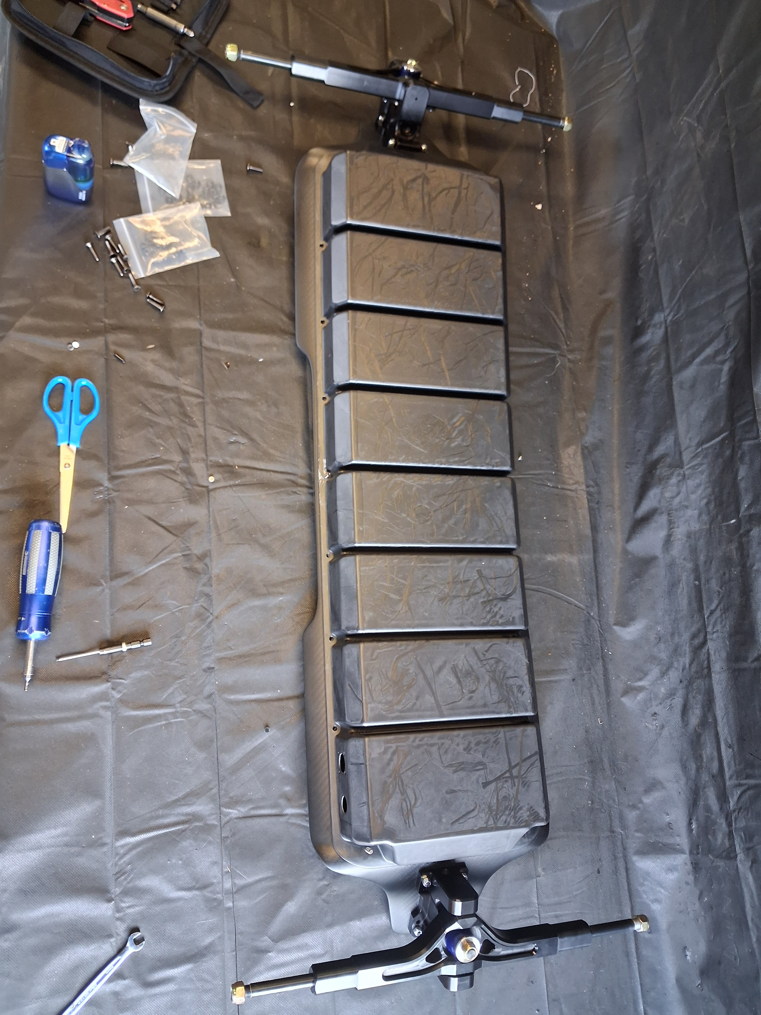

The enclosure/deck interface is awesome. It comes with an adhesive rubber that sticks down to the deck to seperate deck and enclosure, and all of the holes line up PERFECTLY. It’s actually quite amazing considering some of the combos I’ve fucked with in the past… looking directly at you here Lacroix :rofl:
There’s predrilled holes in the enclosure that i’m gonna end up filling in, but i’m gonna try and use the ones at the very back, will just need to design some sort of pass through plate.

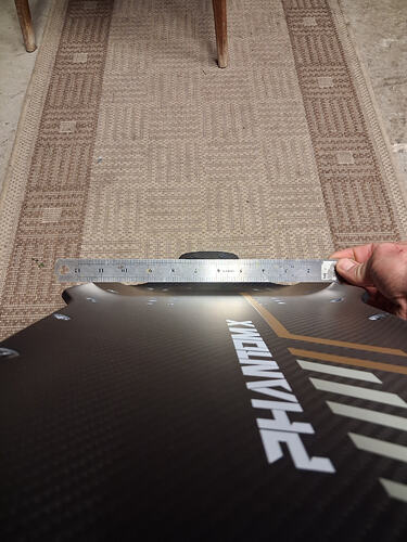

I REALLY love the concave on this deck!!! :heart_eyes:
I haven’t even stood on it yet :rofl: but just looking at it, i feel like the wings kick up a little too aggressively to be comfortable for long range riding. The width of the deck is pretty much dead flat and then just kicks up at the wings. Not as aggressively as a Kaly, but it looks pretty hectic to me.
I’ll be making stomp pads for it in any case, to cover/protect my phases, so I can tune the concave with those if need be. Will likely aim for similar concave depth but with mellower curvature and some slight W
I don’t think the outer part flare up too much. Granted I’ve never tried one so idk how it really feels.
It’s not that it flares up too much and more how aggressively it turns up over a small distance
I’d prefer the concave to be spread across the width of the deck, rather than just 1.5 inches on either side.
Concave is a very personal preference tho, i’m sure this works for many.
I can’t imagine riding my journey on a board with edges curved up like that – my heel would probably die from such a weird stance. :sweat_smile: I went with the Flux precisely because its deck is almost flat.
That said, the curvature of the whole deck looks super sexy, but does it actually flatten out when you step on it? If not, it must feel like a really unnatural stance, in my opinion. Just as unnatural as on the Onsra Velar – my feet were killing me when I tried that one :thinking:
I don’t think it will flatten much to be honest, but if i do find that curve too much i can tweak that with the stomp pads as well.
But yeah, comfort while riding is a priority so the stomp pads are likely to go through a series of revisions to get them just right.
