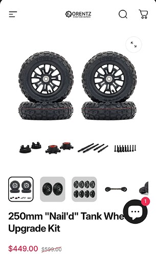

@glyphiks for big scooter tires maybe look at Lorentz board for parts? They do sell 10x3in complete wheel.
Edit: Revskateboard also have 8.5 in scooter tires + hubs. But they’ll cost a pretty penny, almost $600 just for the hubs.
Yeah i did look at the rev ones but that price is hard to swallow…
Those Lorentz ones look pretty good! I’d so much rather buy something off the shelf than fuck around trying to cobble shit together.
Thanks @MichaelWA, these are now top (read 1 of 1) of the shortlist for wheels!
Are there any other known hub options for 10 inch?

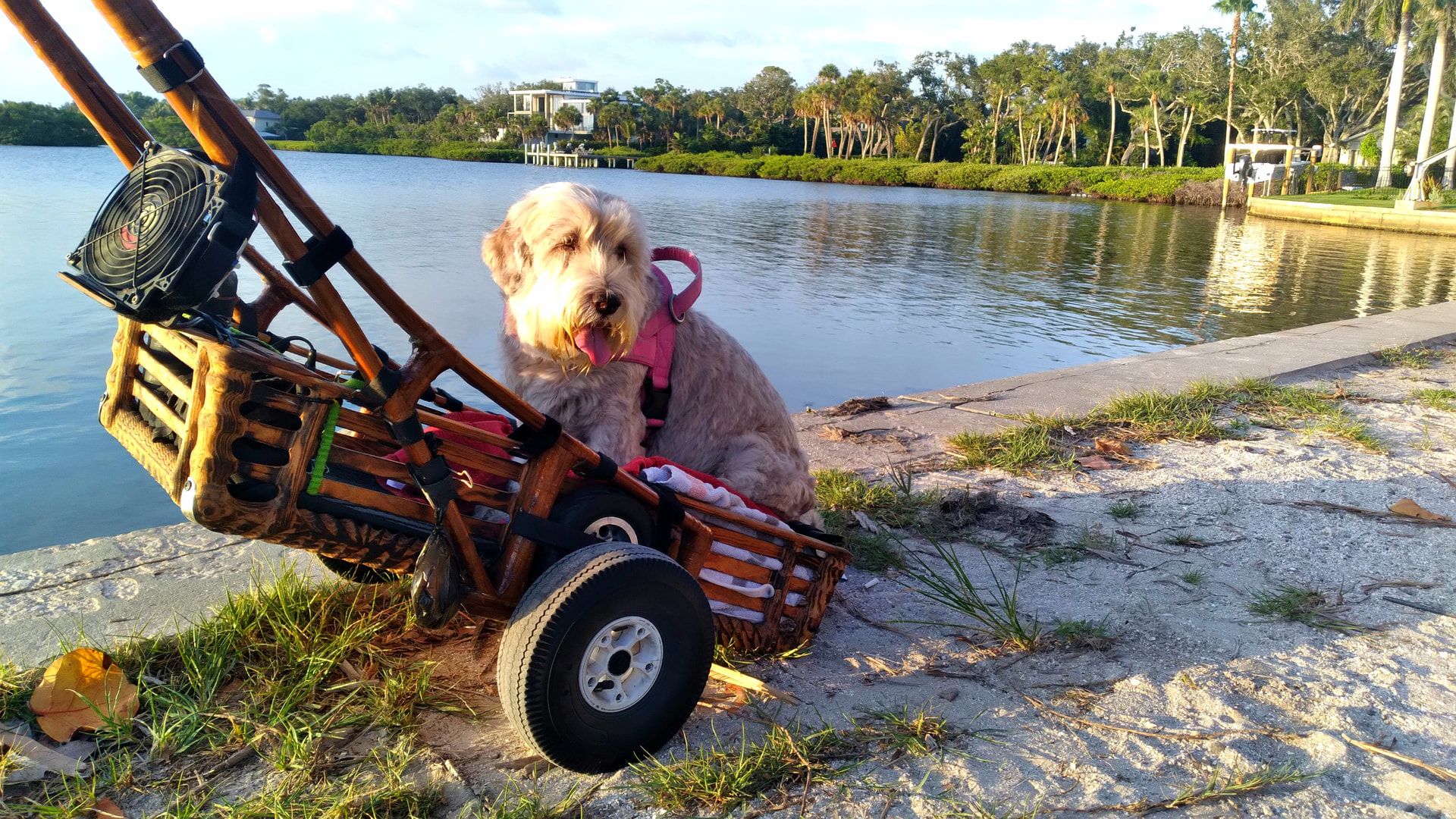

I’d expect a 6 inch tire for a scooter to be built better, require less balancing weights, and have less wobble and runout.
The inexpensive 4.10-3.50-4 Handtruck tires on Fiona’s chariot are pretty wobbly.
The 9” 2.80/2.50-4 Kenda K473’s, my second set, are almost perfect, wobble/runout wise, but the first set, one of them had some wobble and runout I was unable to get rid of.
The first set of K473’s and the 4.10’s started their rotational life on different rims, and required careful centering before inflation. Later, after ~2000 miles, transferring them to the Five stars pinched their sidewalls by 4mm more, but no centering was required, and the one Kenda’s runout and wobble got slightly worse.

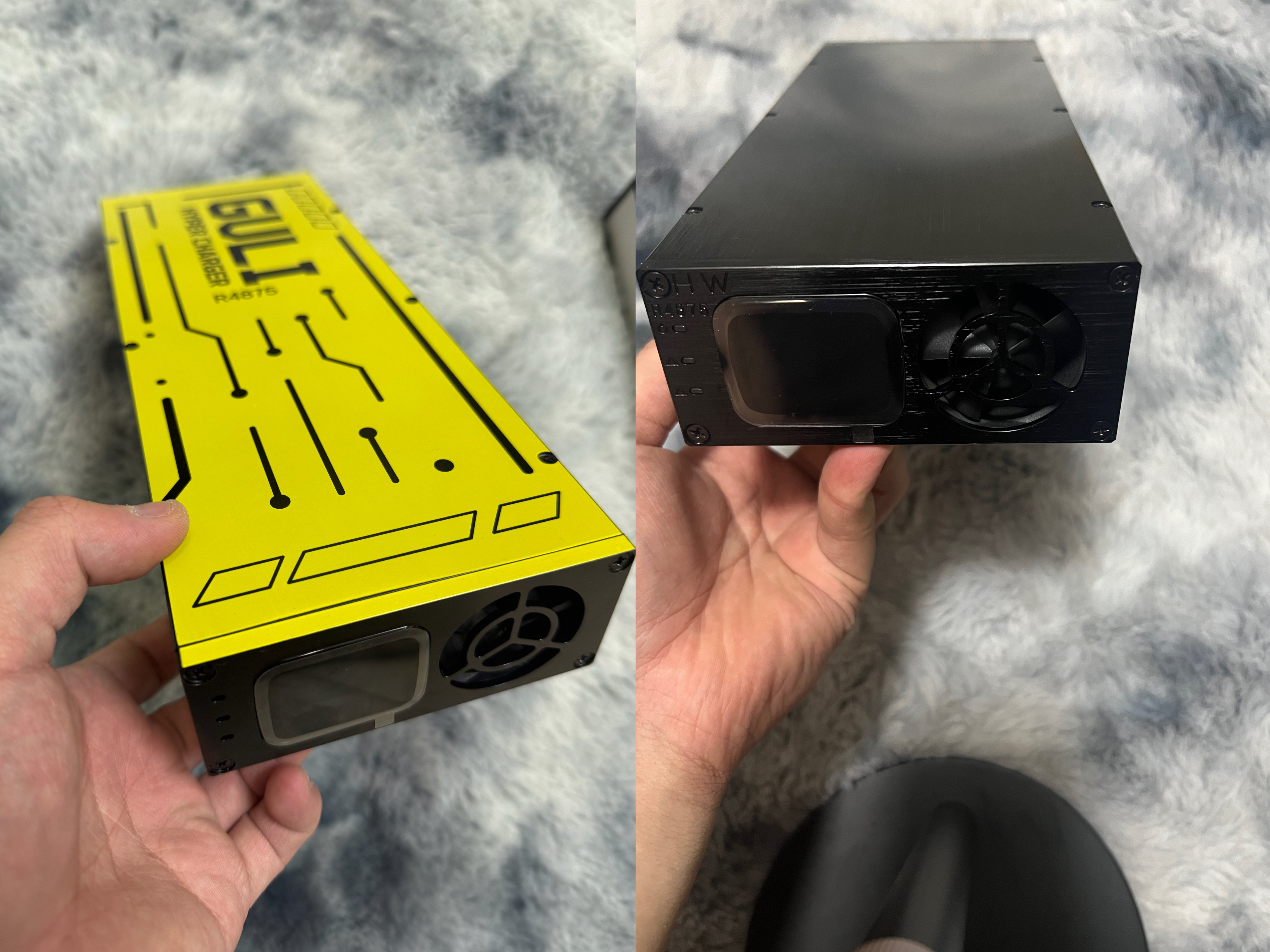

chargers: 4kw charger, interface is great and output is tested and the gui is well developed. lots of these and the smaller 4830 based chargers in Seattle with only minimal failures. so few that when i was asking around in the big (200+ active members) pev chat i could only find one that had failed that I could cannibalize for science. roger charger has an app but its absolutely not necessary and i love that - not everything needs an app ffs

Similarly with the charging situation, i’d rather use 4 x 1kw chargers rather than a single 4kw. A single 4kw charger limits me to only charging at car chargers, whereas if i used the 4 singles, i could still use the car charging stations, but i could also use/max out whatever regular power points i have available to me. This approach also minimises the inconvenience of a broken charger as i’d still be able to charge, just a bit slower.

For charging, those fast chargers are adjustable so you’re not limited to just EV stations. Highly recommend getting the touch screen version.

I’ll look further into those chargers, adjustable current does sound pretty sweet, but one charger to rule them all does sound a lot like putting all my eggs in one basket…maybe i’ll just get 2 of them :rofl: one for each battery!
