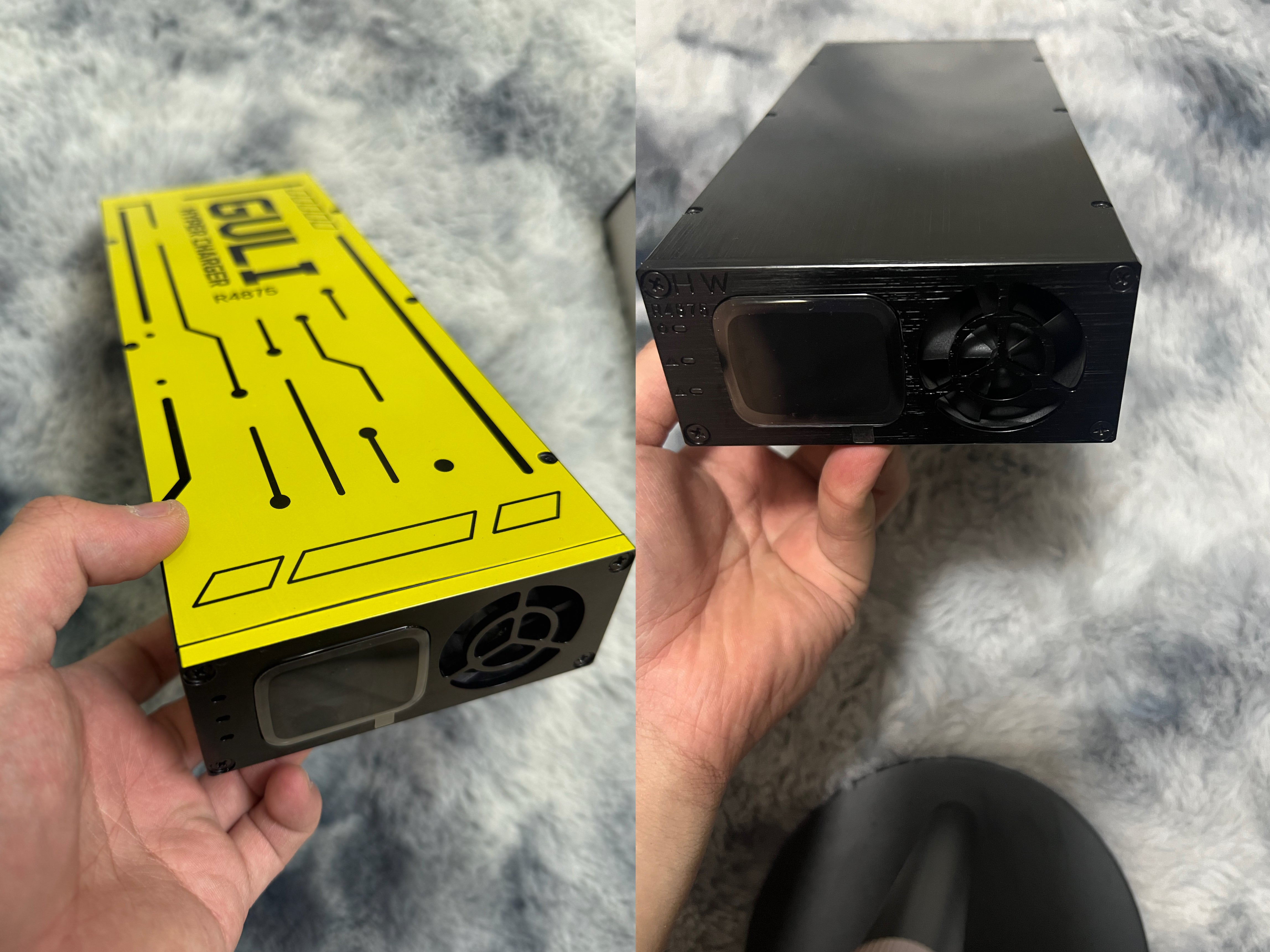

You can do 4kw with a modified Huawei R4875 from alibaba. I recommend going that route and designing for 4kw. You’ll probably also want a level 2 car charger adapter
Something like this that @Pecos linked above
