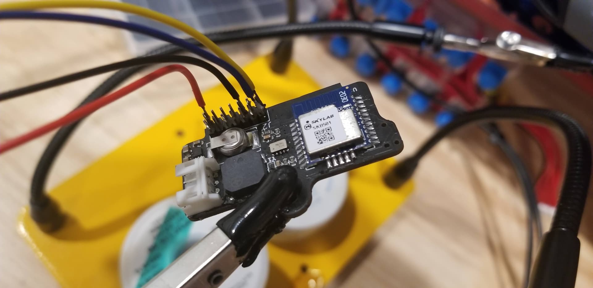

I’ve done this. It’s not hard if you’re handy with soldering iron (or have jumpers)
The 'gotchi needs tx, rx, gnd, 5v from the esc

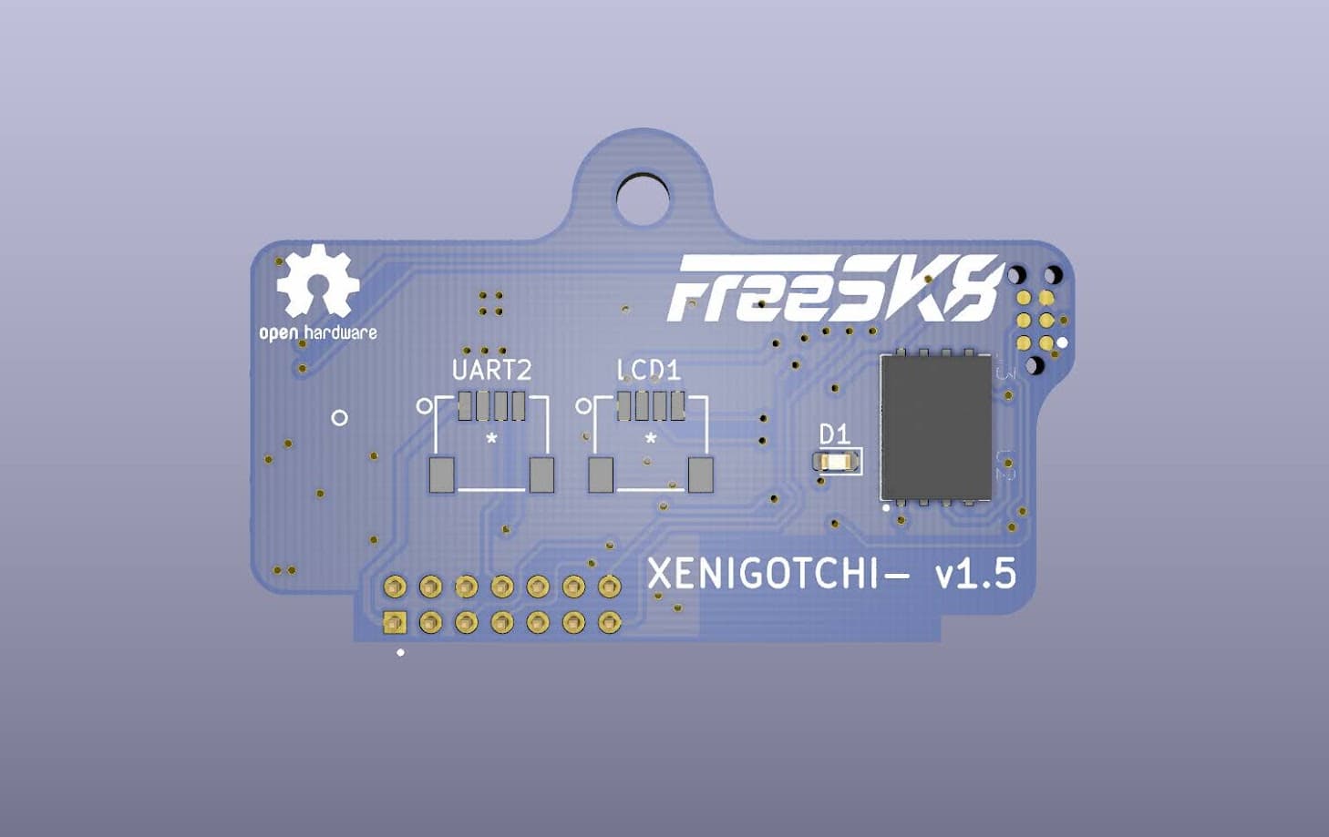

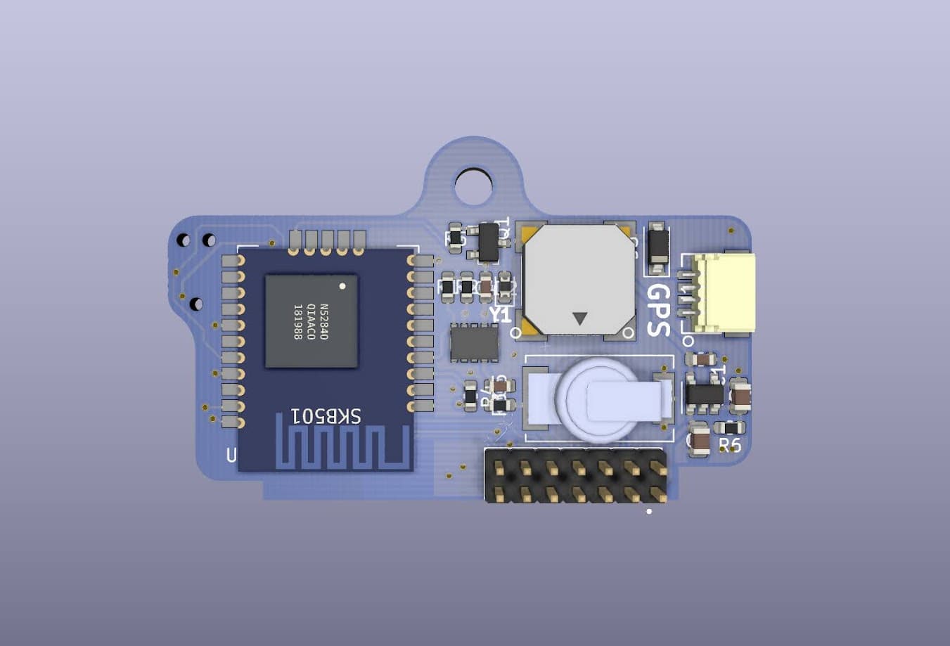

Gotchi 14 pin header:
Make sure you know the header orientation - the square on the pcb is pin 1 (5v)
