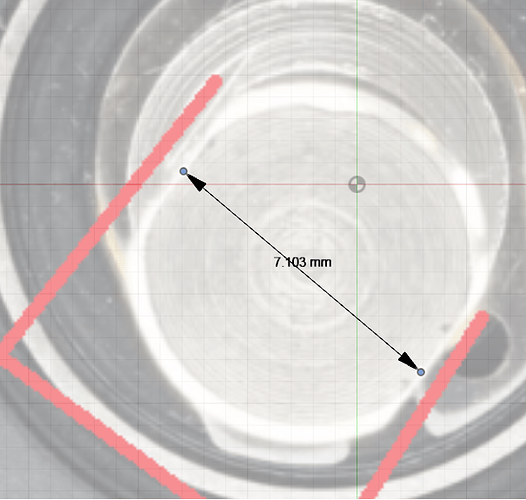

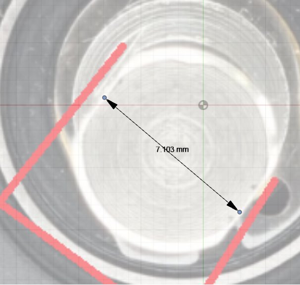

Racerstar is 6.5mm but I think the TB looks like less, probably 7mm (would have a 6mm flat to flat)
Poor mans caliper:
this shaft can use 8X7 or 8X7.5 D shape bore pulleys, need to measure carefully.
That would be a 8x7.5 bore then

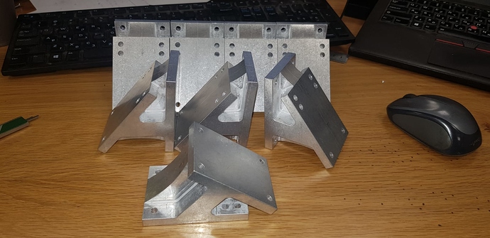

You will also need some sort of riser solution, channel trucks have a zero degree baseplate, street trucks are typically at 50 degrees.
I have risers!
Angled risers right? Not just flat ones
Got a whole set from my DH days. everything in between 5 and 45 degrees and they stack on top of each other.
Not sure that’s gonna work for channel trucks.

It looks like theres some smaller risers in the pictures but I think that’s for making them work on different angled mtb decks.
Not enough of an angle to be on a flat longboard
No worries I can always make some outta wood or 3d print a set
This is what you need
Or something similar
