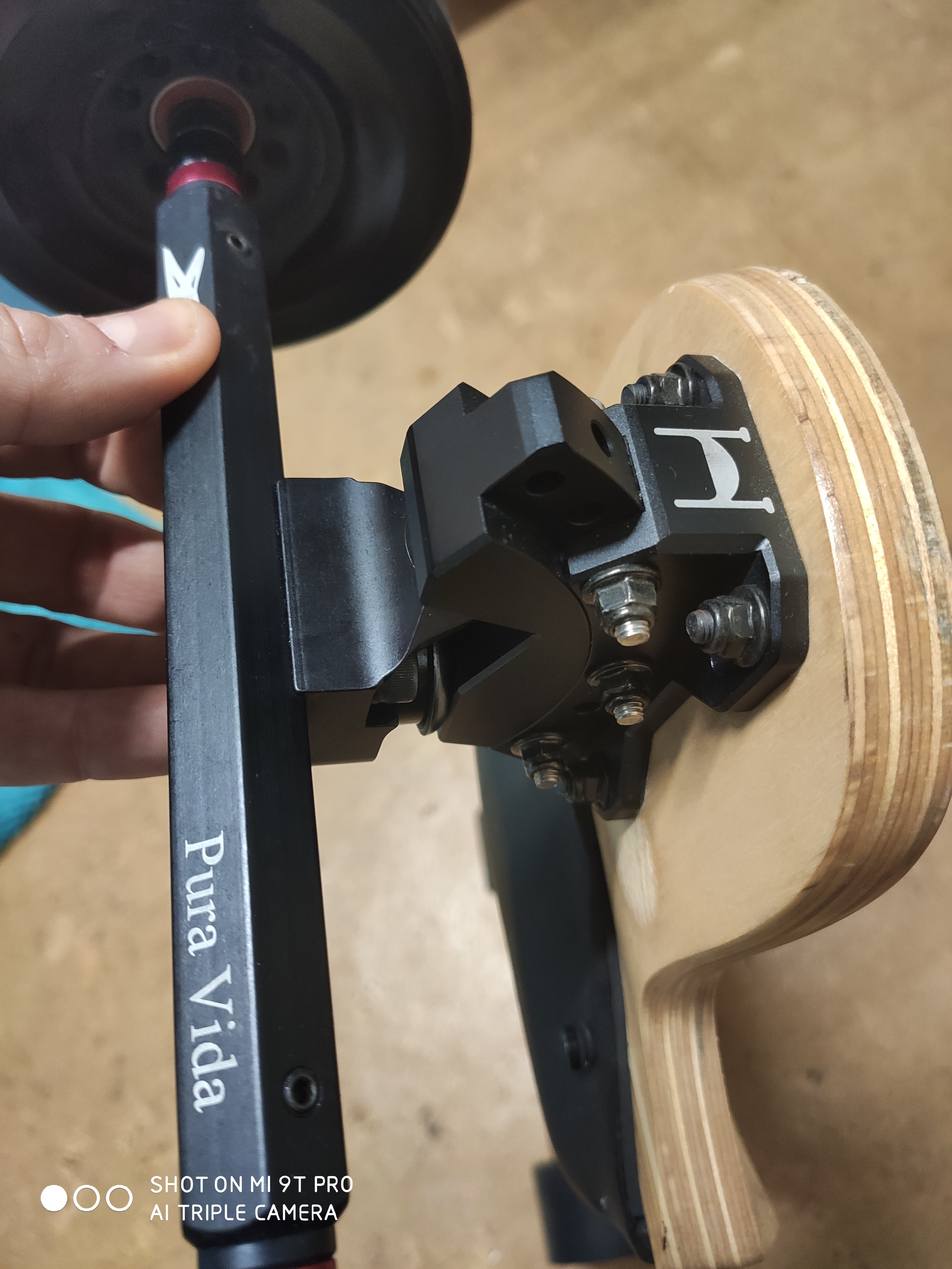

I have designed mine to be rattle free… The first GB had slightly higher tolerance meaning 0.05mm each side and I have been using them for over 1000km without any sounds. I made a tutorial how to install them. You need to torque them until you feel all the gaps.
If the hammocks came from the last 2 GB then the tolerance is at his limit and the 2 parts are almost fused together.
Anyhow torque them down more and the movements are gone. If you don’t have the tutorial check on the GB pm. I always posted there.
Lol not saying your parts aren’t cool, but @CiscoV doesn’t install shit incorrectly. His attention to detail is second to none
Love you bro. Thanks for the props
I am not saying that I am just saying that to remove the lateral movements you need to torque them down. Nothing more
These are First batch I’ll torque them down some more. Hopefully won’t pop those screws lol
Also have some epoxy. Ima battle harden them so they don’t fall apart like my old Tb 6380s
Ok I see. Yes then the tolerance is indeed a bit more but still fine. You need to torque them half turn more until the gaps is filled.
I also suggest to replace the m5 nuts with a nylon lock ones. I have been shipped them with the inbuilt washers from the second GB. If you don’t find them I can send them at shipping cost.
Oh shit. To be fair. I got them off @Tello1969 and they already came with nylon insert nuts. Prolly second batch then. I’ll torque them down some more.
Then torque them down. The gap is really at the limit or they won’t slide anymore. Is within 0.03mm each side. Just fasten them half turn at the time. Even distributed between the bolts front and back and it will be gone. I put together to many that’s why I am sure it will be solved.
