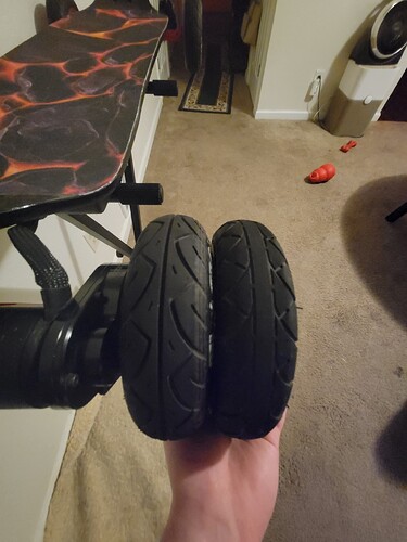

@BenjaminF how did you end up liking those 190mm CSTs? I haven’t heard much about them, but it seems like they would be a nice in between for 7 and 8 inch tires. Were they reasonably well balanced?
I have a set and they’re pretty awesome. Super well balanced, much more durable than my 8 inch Razer(?) tires from eBay.
One thing I noticed is that they don’t stretch very noticeably. My 8 inch wheels seem a lot wider when inflated. This is probably a product of the rubber durability.
(The last pics are CST vs Razer 8 inch) I recently went back to the Razer tires to try and squeeze all the clearance I can.
Thanks @haven - definitely good to know that they might not be the best stretching tires. I would be using them on the very wide newbee pentagrams - so stretch is pretty important. Tough to tell from the images, but it looks like they kind of bulge on the sidewall. Is that right?
Yeah exactly, that might also be where all the stretch is going. I don’t have them mounted currently but can send better pics next time I switch them out.
