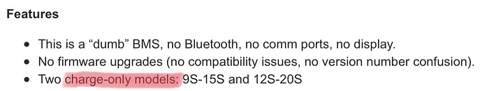

Ok, so you got ne out of status LEDs.
What about charge only instead of charge and discharge?
You say size matters and I think discharge does add quite a bit of size to the bms.
Sure there is no discharge protection, but I think most of us do think like:
Better fuck the battery, than get fucked by the battery because the bms cut out while braking.
