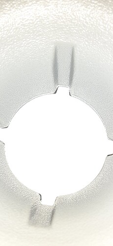

I am excited to get a model of the hub printed to test fit asap.
Wondering what bearings I should try to use. 608 is tempting because I bet I could get away with 4 of them on a 8mm shaft.

Yeah it would have helped me model my own hub for this wheel, and I could have designed a kind of gearbox/pulley mount adapter that fit into the hub, but I ultimately would not have a use for the hub so I skipped it.
Might grab it later and I think I want to get the hub when I order the 12" version because making an AT gearbox adapter to that one should work good.
lots of space.
really not sure why I did not get the hub… thinking about it I could have even just printed spacers that let me use whatever size bearing I wanted.

This is the only large pulley I have on hand.
smallest motor pulley is a 14T
look at the way those bolt holes fit with a little clearance
printed part in the middle, prob don’t need that big lip there because of the hub spline doing the locking.
hope that’s accurate
Needs a tiny bit less overall diameter to slide in nice I think. Fits better than what I was guessing but I was fairly detailed.
